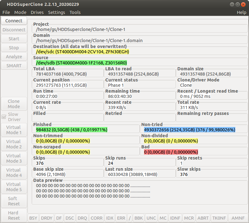

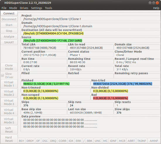

I just tried it, but HDDsuperclone quickly gave up. It read awfully slowly (<0,5 MB/sec) and showed a high numer of skips. After a while, this error-message was displayed and it stopped:
Error: Skip Reset detected. The settings may need to be changed.
Skip size may be too low or too high.
The drive may have a slow issue causing too many slow skips.
If you got this message very quickly, it may not be reading any data.
I saved everything and shut it down. The attachment shows what the HDDsuperclone window looked like in the end:
So is there anything we can do? Different parameters? Or has the condition of the drive deteriorated so much that it is time to give up? :?:

The good news is that it is still reading data without errors. The bad news is that it has an issue. I can't tell for sure, but crunching the numbers on the display would indicate to me that the drive is suffering from a "slow responding" issue, meaning there is something going on in the firmware that is causing it to read slow. I can't tell if there is a weak head or not.
Without fixing the slow reading issue, you could turn up the Skip Threshold from 1000 to 10000, and turn up the cluster size as high as it will go. That should prevent unnecessary skipping, and hopefully increase the read speed. But it will still be slow.
There are commands that can be sent to some Seagate drives using a TTL adapter that can help stabilize the drive, but I am not familiar with that, and don't know if it is possible on your particular drive or not.
I am assuming that the data isn't worth sending it to a data recovery specialist, since you have already been willing to torture the drive for 11 days.

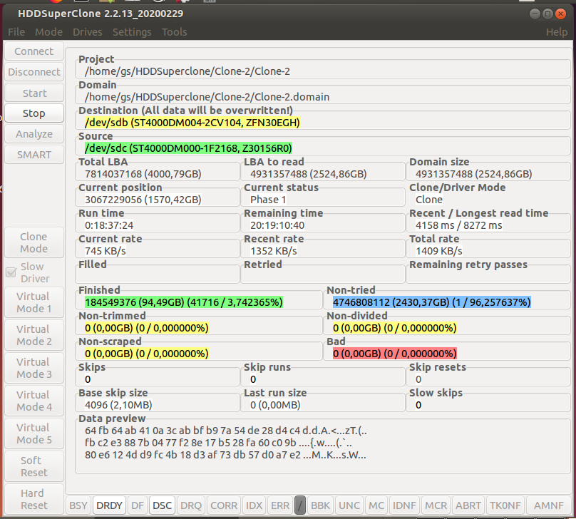

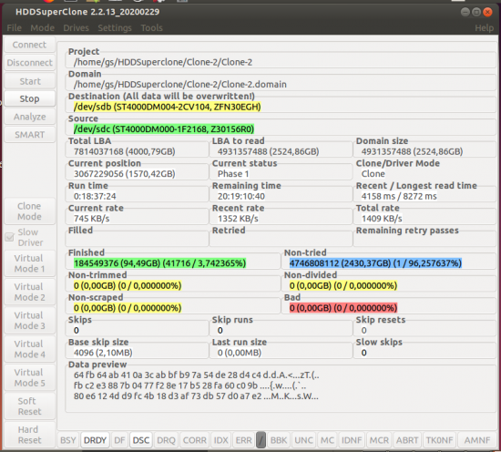

I just restarted it. First, I set it to threshold 10.000 and also to 1 retry. The maximum cluster size which it will allow is 2560.
But when I set cluster size to 2560, HDDsuperclone crashes shortly after the cloning is started. First, Ubuntu gives an error message "Problem with a system program detected". This box leaves a blank spot in the HDDsuperclone window behind. Minimizing and restoring the window results in a blank window, which can not be closed. Closing the parent terminal also does not close it.
So I restarted Ubuntu and reduced the cluster size to 2048. This worked and gave read speeds of ~1 MB/s. Then I tried to increase the cluster size to 2304 (2048 + 256), but the same crash happened again.
So I started a new cloning with cluster size 2048 from the last position where HDD Raw Copy had stopped, because in yesterday's run there had been much more skips than successful reads. Plus, I don't know what happened during the crashes. I also set the mode from Auto-Detect to ATA-Passthrough, but this seems to make no difference.
Now it is working and the total rate is ~1,3 MB/s. In the first 3 GB, it has not skipped a single time. :D I hope it stays like that. It estimates some 20 days for completion - I could live with that and I hope the HD can.

It is going now, slowly but steadily an I think I will let that go rather than taking chances sending the drive all across Europe via UPS or something. I have seen how they handle parcels. My gut feeling is that this HD is still alive a bit, but the next abuse might kill it. This guy here took several months but in the end he got it all back: [url]http://forum.hddguru.com/viewtopic.php?f=1&t=39074&p=278443&hilit=HDD+Raw+Copy#p278443
[/url]
It has now read 94 GB without a single retry or skip: :)
The actual speed varies between 4 and 0,5 MB/s, the total average is 1,4. If it works like that – good enough.
Because of interest and without asking you to reveal trade-secrets: What would you do to make this go faster and smoother? And thinking about the next step: Which programs are best to do undeleting of terabytes of files on the clone?
