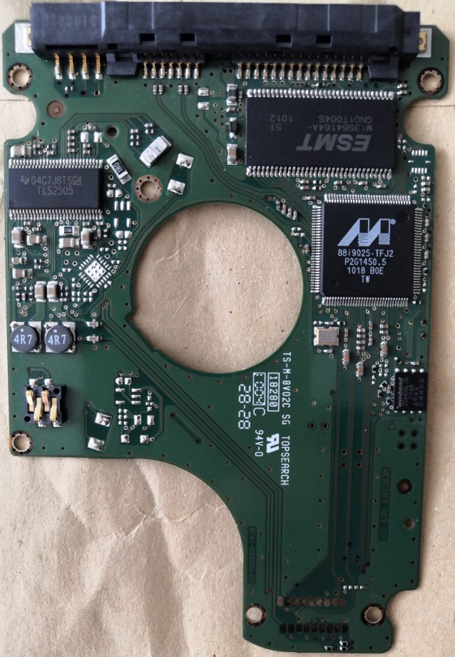

PostPosted: May 8th, 2020, 17:19
Posts: 17218
Can you upload a photo of your original PCB? There are a few voltage test points you could measure.

 Post subject: Re: Samsung HM321HI/SRM board replacement
PostPosted: May 9th, 2020, 6:19
Joined: January 6th, 2019, 5:25
Location: Stuttgart, Germany

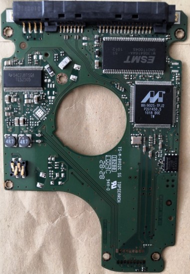

PostPosted: May 9th, 2020, 17:04
Posts: 17218
Here are the supply voltage test points.
PostPosted: May 10th, 2020, 3:33
Posts: 849
Tomset wrote:
Avsfan89,
>Platform Invalid MC Head
Wrong PCB configuration
He put the donor PCB on the patient without Flash chip swap. FIPS mismatch.
