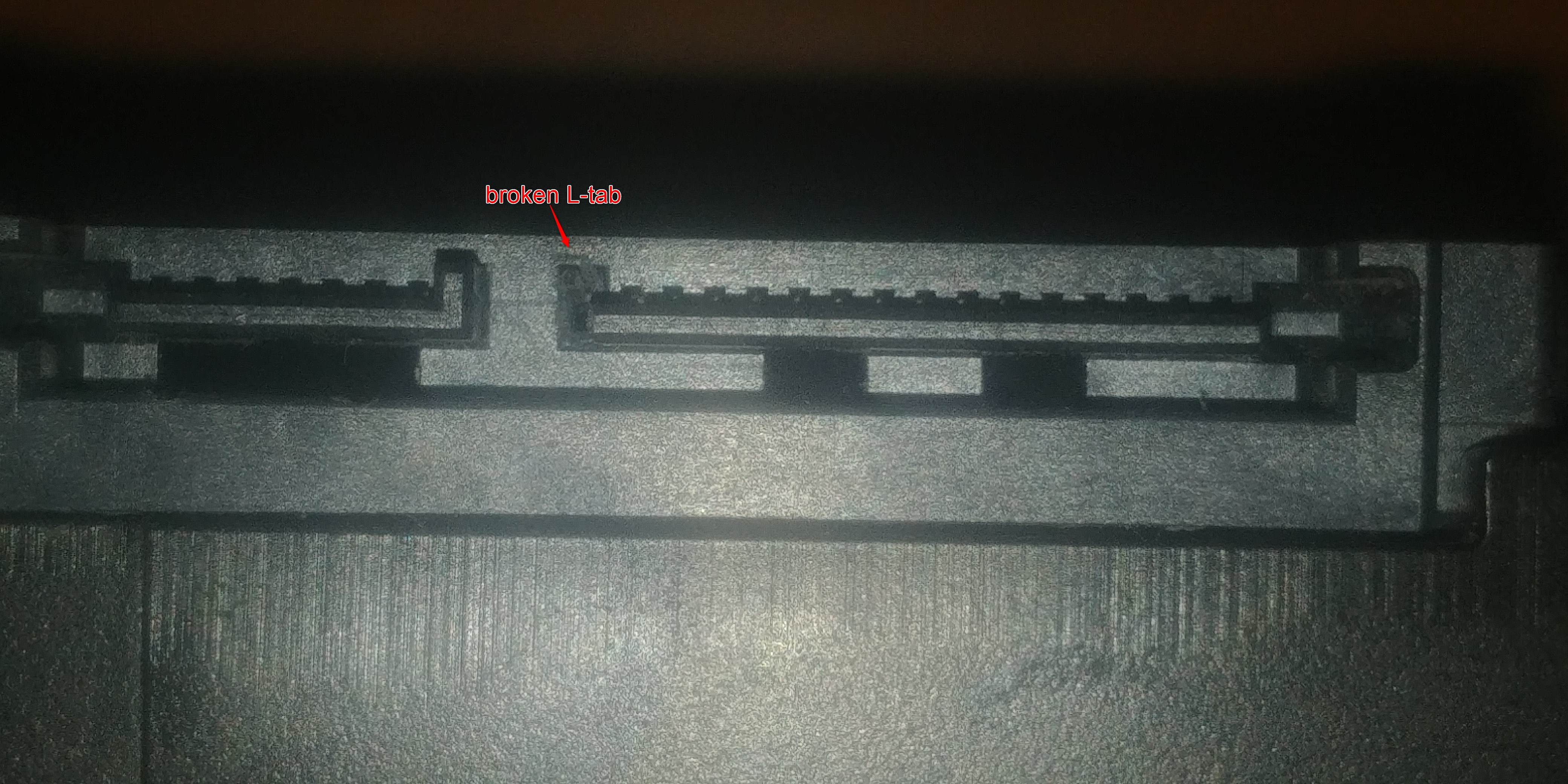

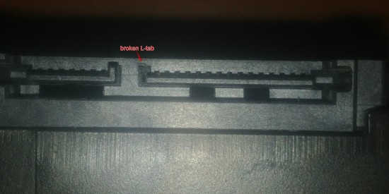

- Hard Drive Power L-tab or shape is broken. (link: https://imgur.com/R8xXKI6)

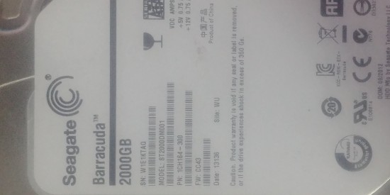

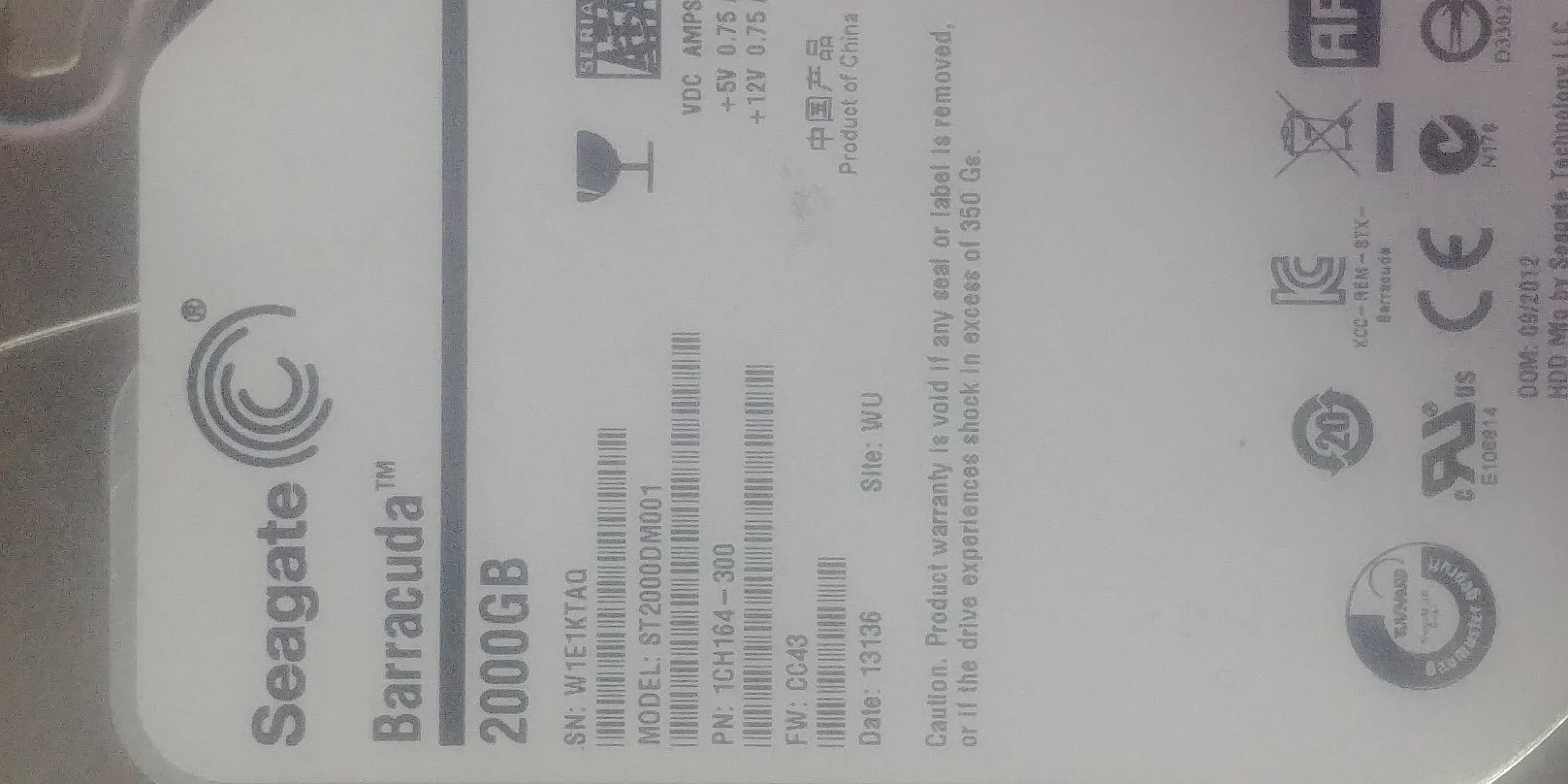

Disk Info: https://imgur.com/xGxT9hf
SN:W1E1KTAQ
MODEL: ST2000DM001
PN: 1CH164-300
FW: CC43
DATE: 13136 Site: WU

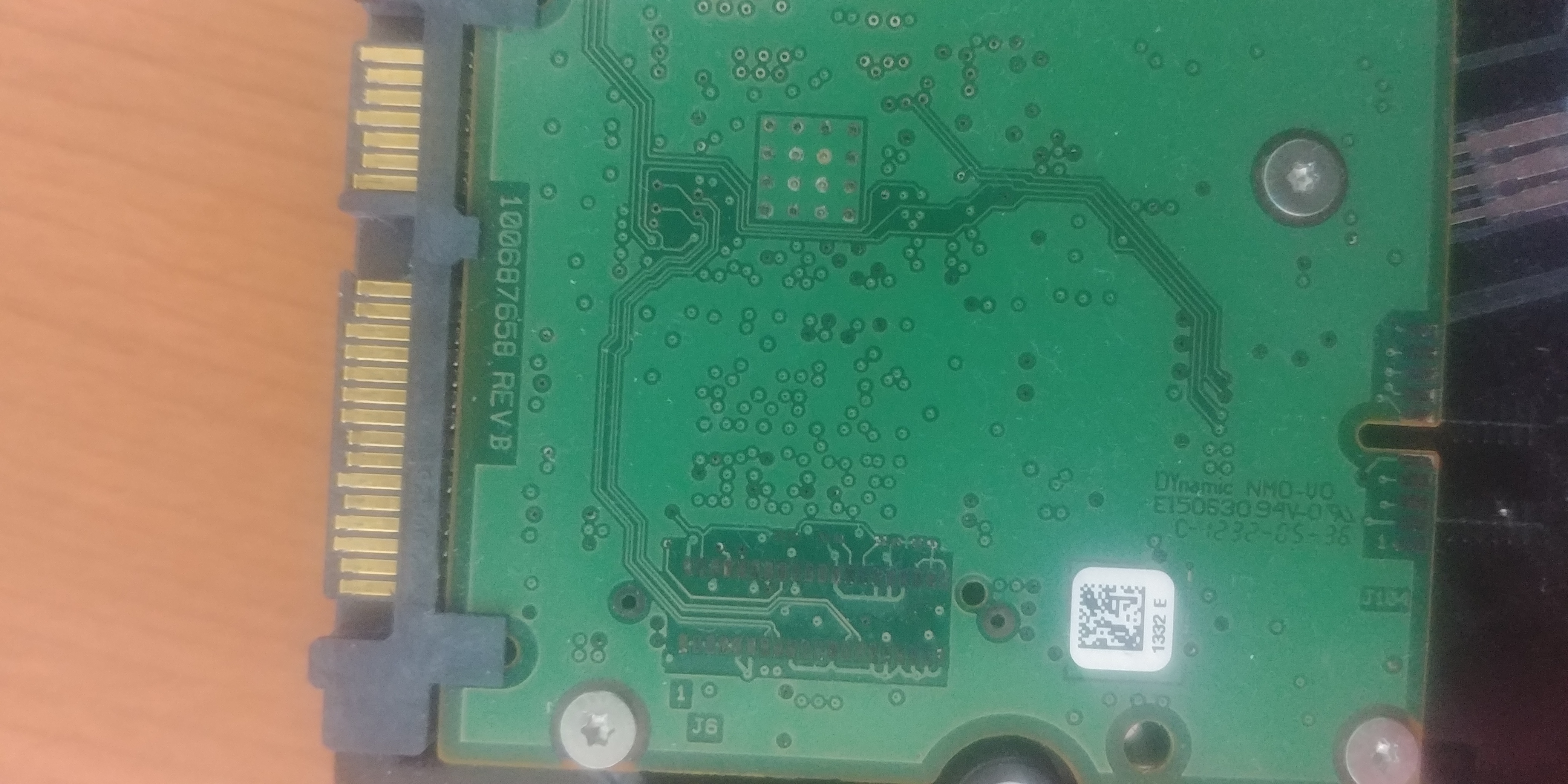

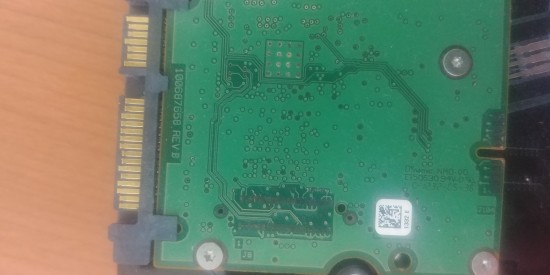

PCB:100687658 rev B https://imgur.com/q3oVC2W

If the drive shows its ID, the broken L connector isn't likely causing any issue. It's just a coincidence.

Agree with above, nothing to do with PCB at all.
