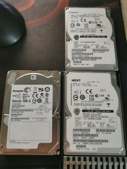

Hey,
i have around 600 SAS drives what were used in storage servers.
sadly they are formatted with 520b but I need 512b.
I've used
sg_format --format --size=512 -6 -v -e /dev/sg3
to reformat them with a HP p420i raid card in HBA mode.
Sadly after formatting them I don't seem to have write permission on these drives.
i can't create a raid on them nor create an ext4 partition in HBA mode.
These are the drives I've tried so far:
Seagate Savvio 10K.5 ( ST9600205SS )
HITACHI HVC106060CSS600
is there any way I can use these drives?

E123 wrote:
What firmware versions?
hey, i can't check the firmware without mounting it.
 Post subject: Re: Reformatting SAS drives 520b -> 512b write issue
PostPosted: May 25th, 2020, 12:14
Joined: September 26th, 2016, 4:26
Posts: 127
Location: Russia
Show the answer to the "inquairy" SCSI command?
Or what is written on the HDA's labels: FIRMWARE: ..?
Or take a picture of them.

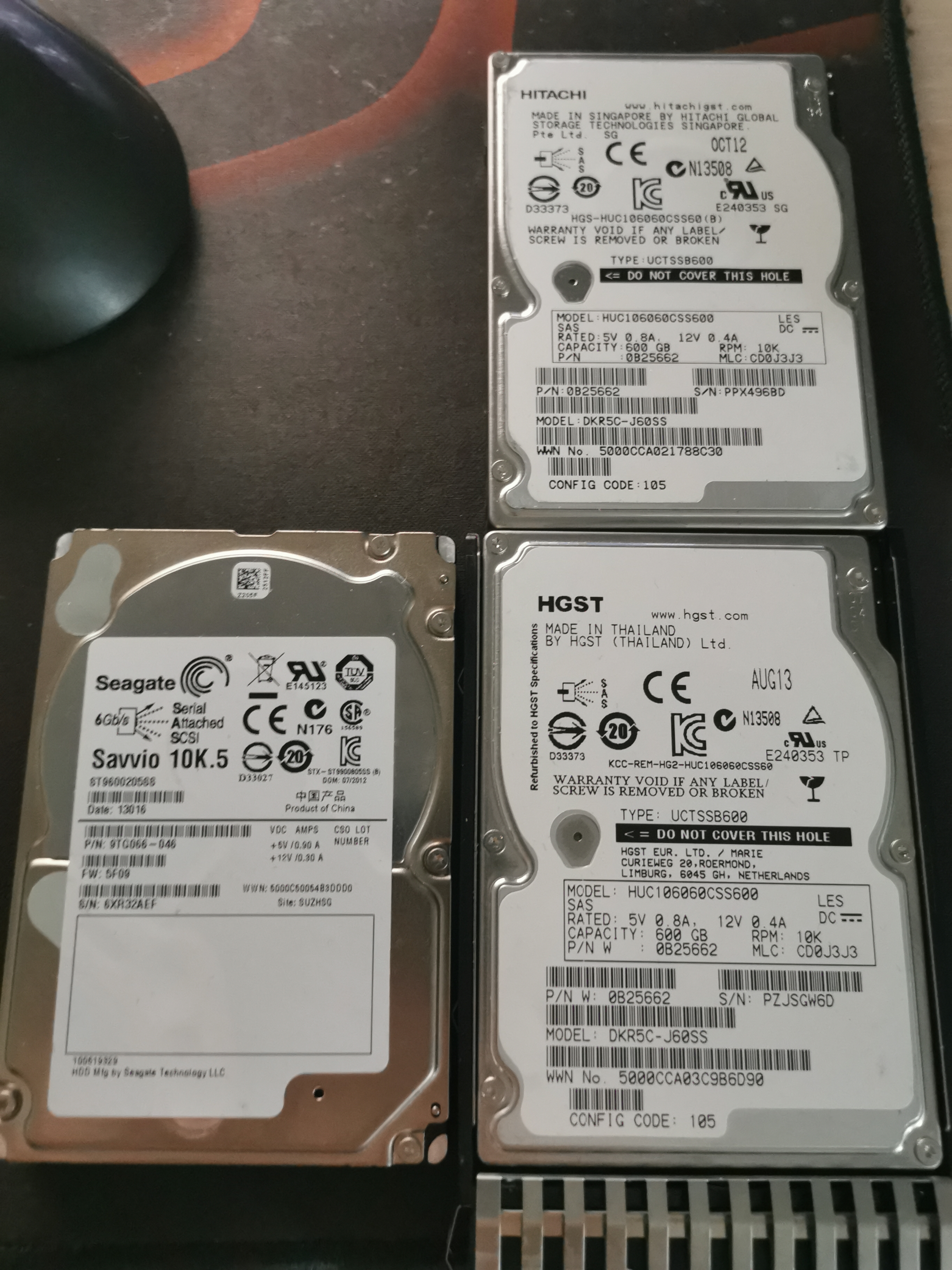

hey thanks for the quick reply, here is a picture.

They all are locked "on writing". Reflash needed.
https://forum.hddguru.com/viewtopic.php?f=22&t=39927
