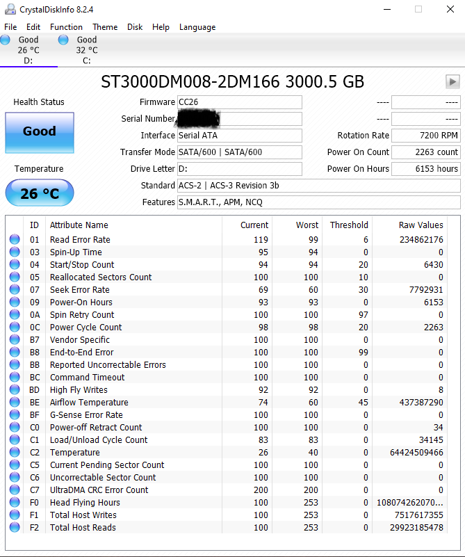

Hi all
I am going to take conventional as spinners regardless of there interface.
I should probably know more about HDD's. To be honest I don't find them very exciting, I just want them to work. So I got an NVMe as system drive as said to be the fastest and a 3TB Sata for storage. I had not look at drive health for a long time. I friend asked me to buy a drive second hand and when I received it I put it in my docking station to check it out. I used Crystal Disk (probably not the latest version sitting on PC unused for some time) of course I would look at my drives while there. With the 3TB HDD (that I will attach screenshot figures are Dec) I do not think I am happy with what I saw from 2.5 year old HDD. I might be interpreting the figures wrong. I don't know how Crystal Disk can have the health as "GOOD"
I backup the HDD. No RAID.
I pumped my Serial No into Seagate and says it is not warrantied. Out of interest what is warranty period?
Do these figures mean imminent failure? How about corruption, am I likely to find files corrupt on the backup?

Those numbers are OK. Nothing to worry about.
http://www.hddoracle.com/viewtopic.php?f=6&t=89

If you're this paranoid about a 2nd hand drive then don't buy it.
No. But it will fail eventually. Maybe even tomorrow without those numbers giving the slightest indication.
These numbers have absolutely nothing to do with integrity of individual files. Are you likely to find corrupt files? Not when looking for them, you typically find when when not looking for or expecting them.
