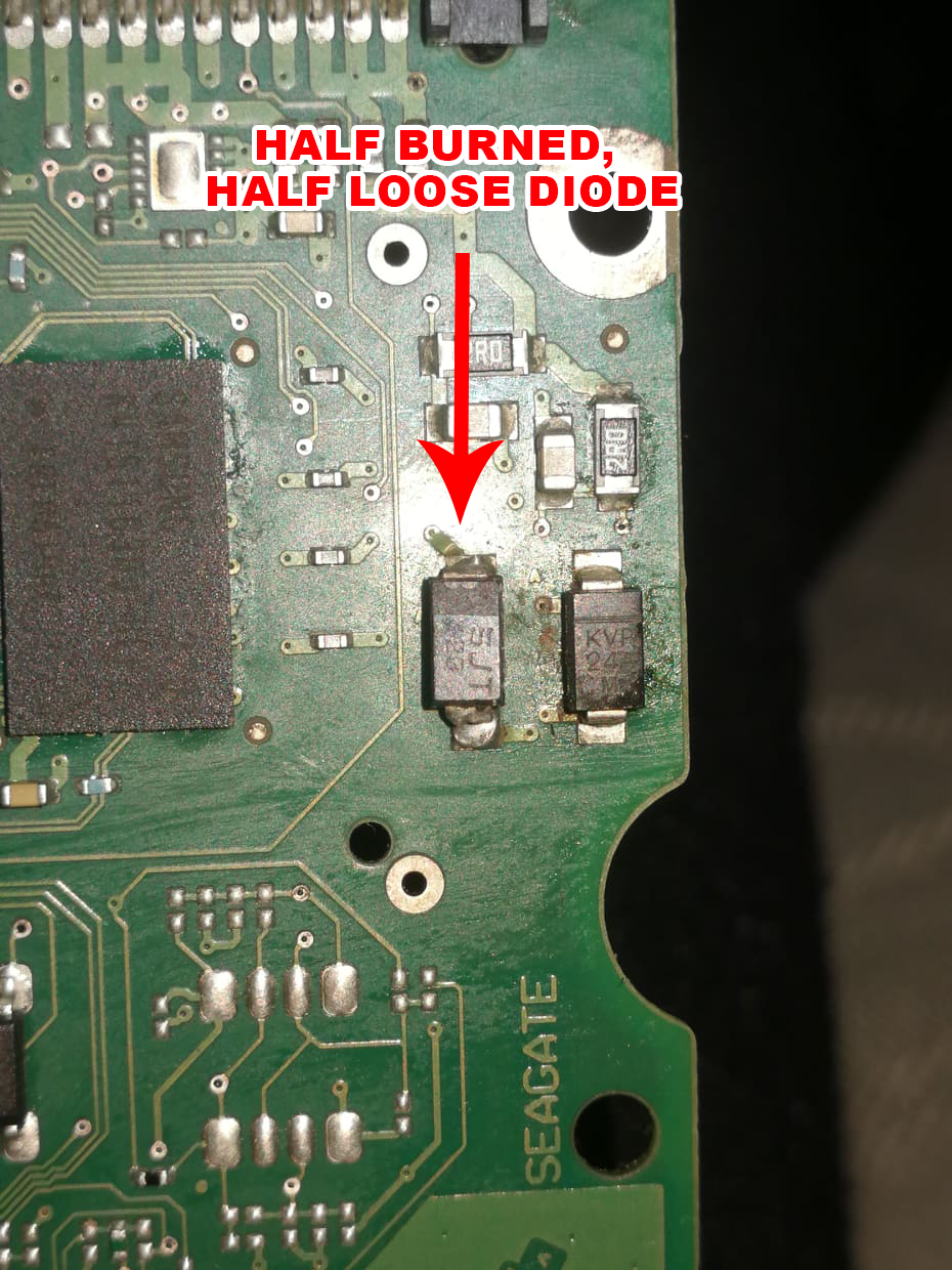

After reading many pages about recovering data from an hdd that is not recognized by the pc, by transferring the firmware (ic bios) from the old pcb to a new and identical pcb, I decided to do it and try to recover my data . Firstly, the disc before or after the firmware change does not make noises such as: Grinding, Buzzing, Failure, Crash, or Weird Sounds. The disc makes the same normal sound as when it was recognized by my pc.
I used the disk in a USB box, one day when turning on the PC I realized that the disk was not recognized, I tried several times connecting it directly to the PC, or in another usb box and it did not work either.

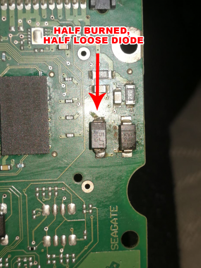

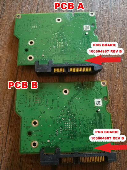

Some friend told me to remove the pcb from the hdd and check the circuits, and I noticed that there was a half burned and half loose diode:

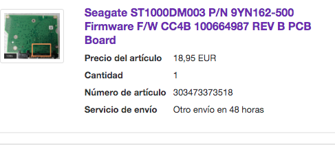

I found in internet a pcb with the same characteristics and bought it to do the firmware transfer.

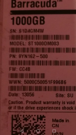

My disk is a: Seagate ST1000DM003
P/N 9YN162-500
Firmware F/W CC4B
PCB Board: 100664987 REV B
capacity 1tb.
File comment: my hdd

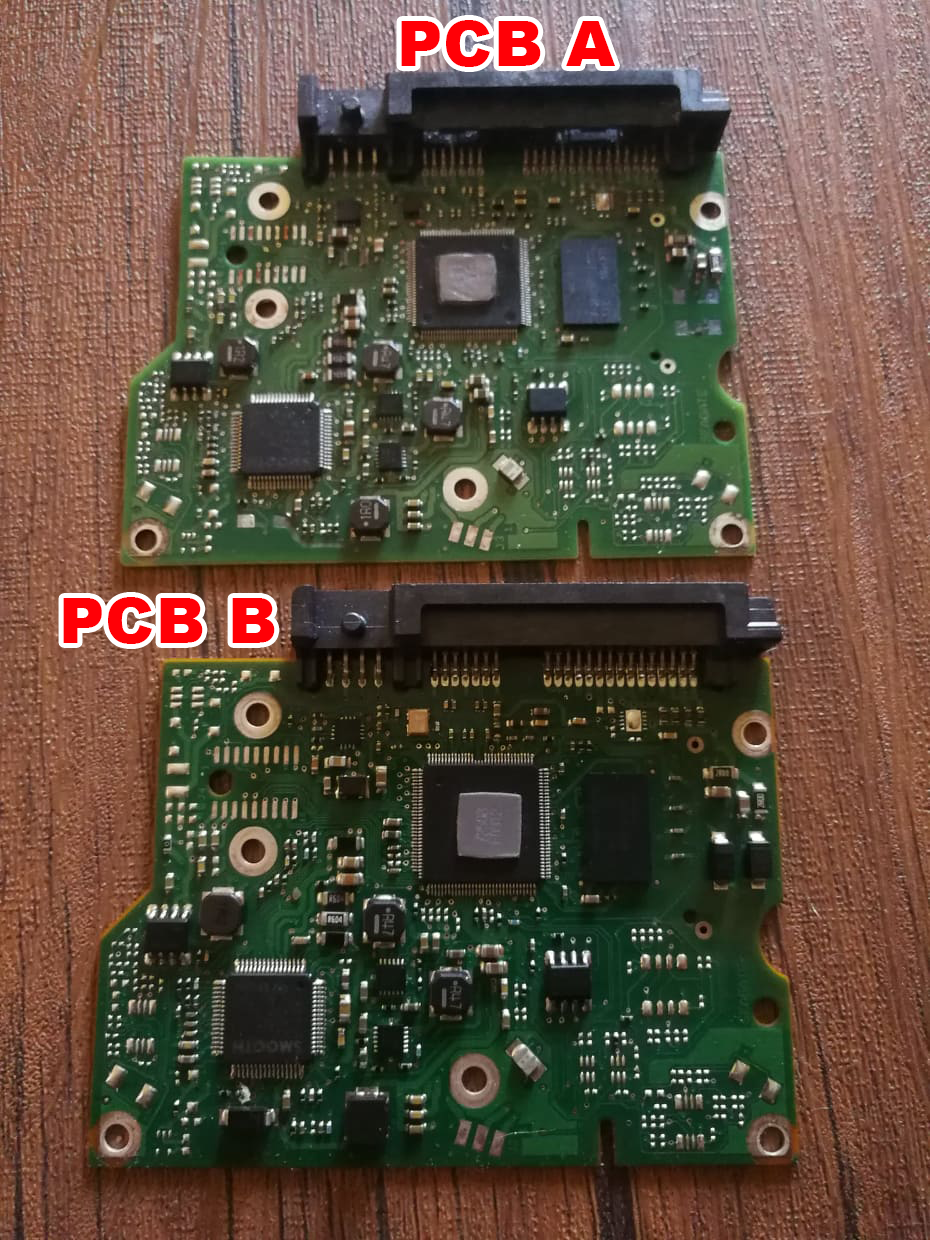

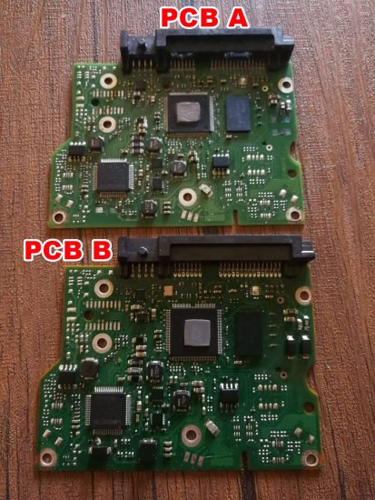

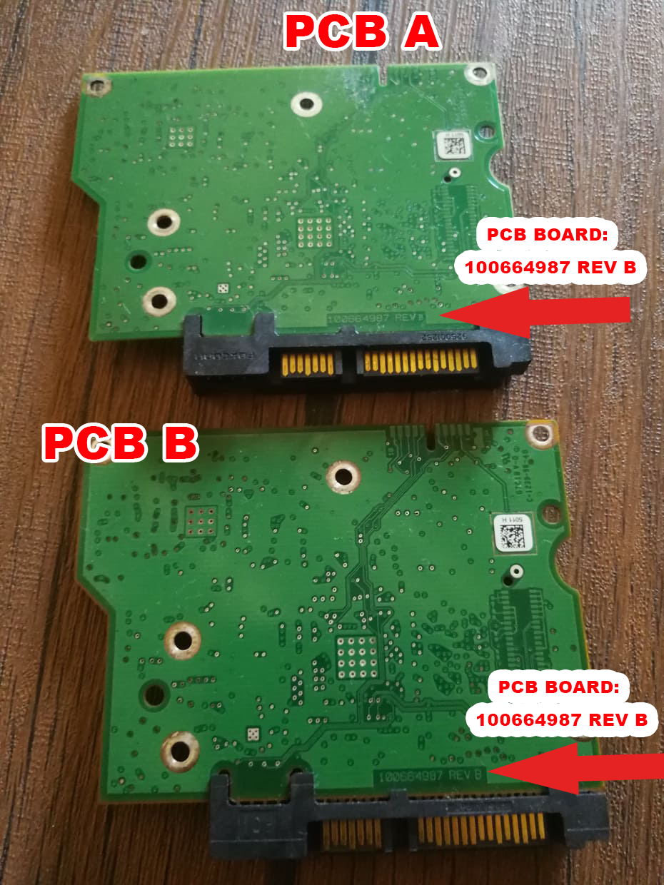

I am going to name the pcb of my hhd as Pcb A, and the one I bought on internet as Pcb B
(If you look closely you will notice that 3 diodes are missing on the pcb A (my hdd) this is because I read that if a diode burns or is damaged you can remove it and the disk will work again but no voltage protection, so i removed the diodes, but the pc did not recognize the hhd).

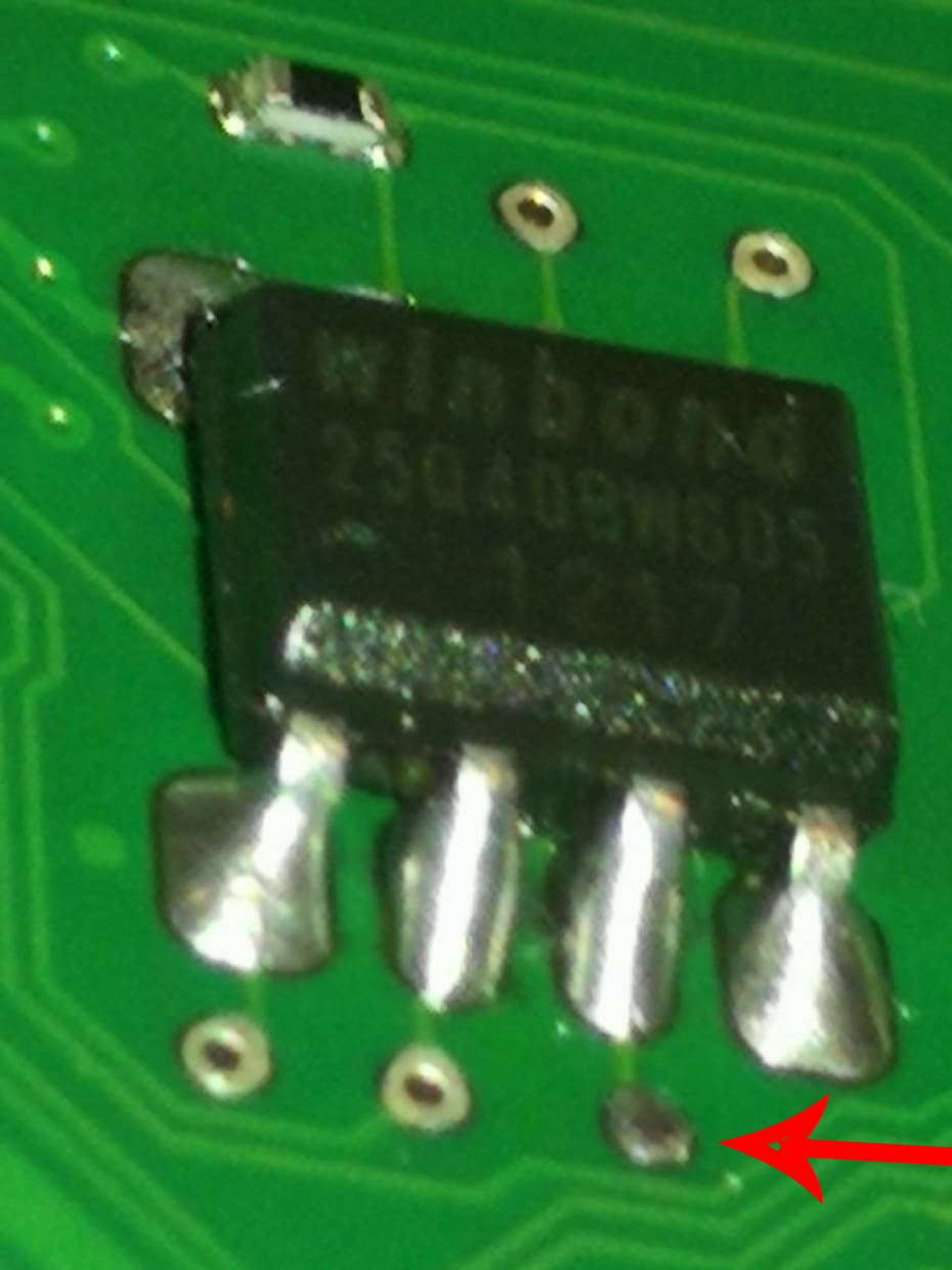

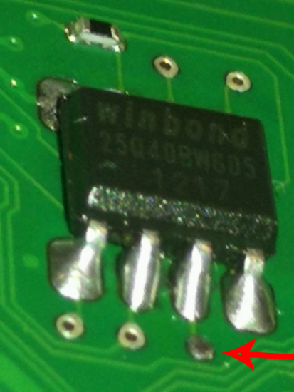

So I went to an electronic technician, I explained what he should solder, and he did it, the ic bios from Pcb B to Pcb A (€ 30)
(By the way, look at the red arrow in the image, that little drop of metal covering that hole? the other ic bios (firmware) did not have that metal drop, welding error or is it not a problem?)
The Ic bios (firmware) is: winbond 25Q40BWS05 (i think is S05 the last 3 characters)

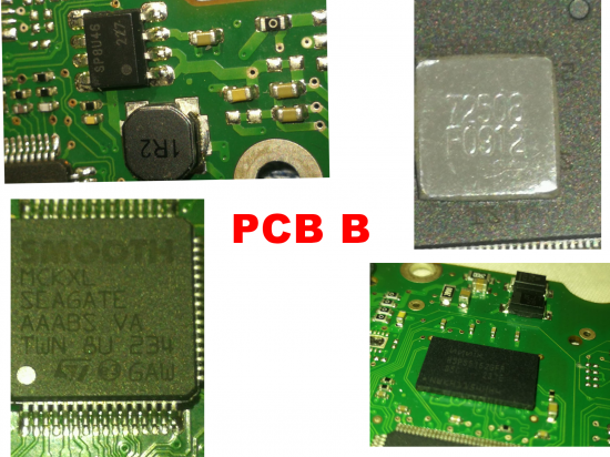

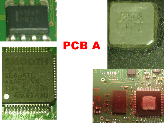

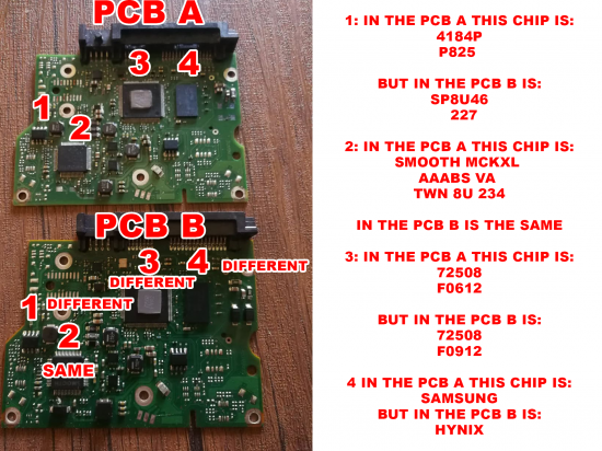

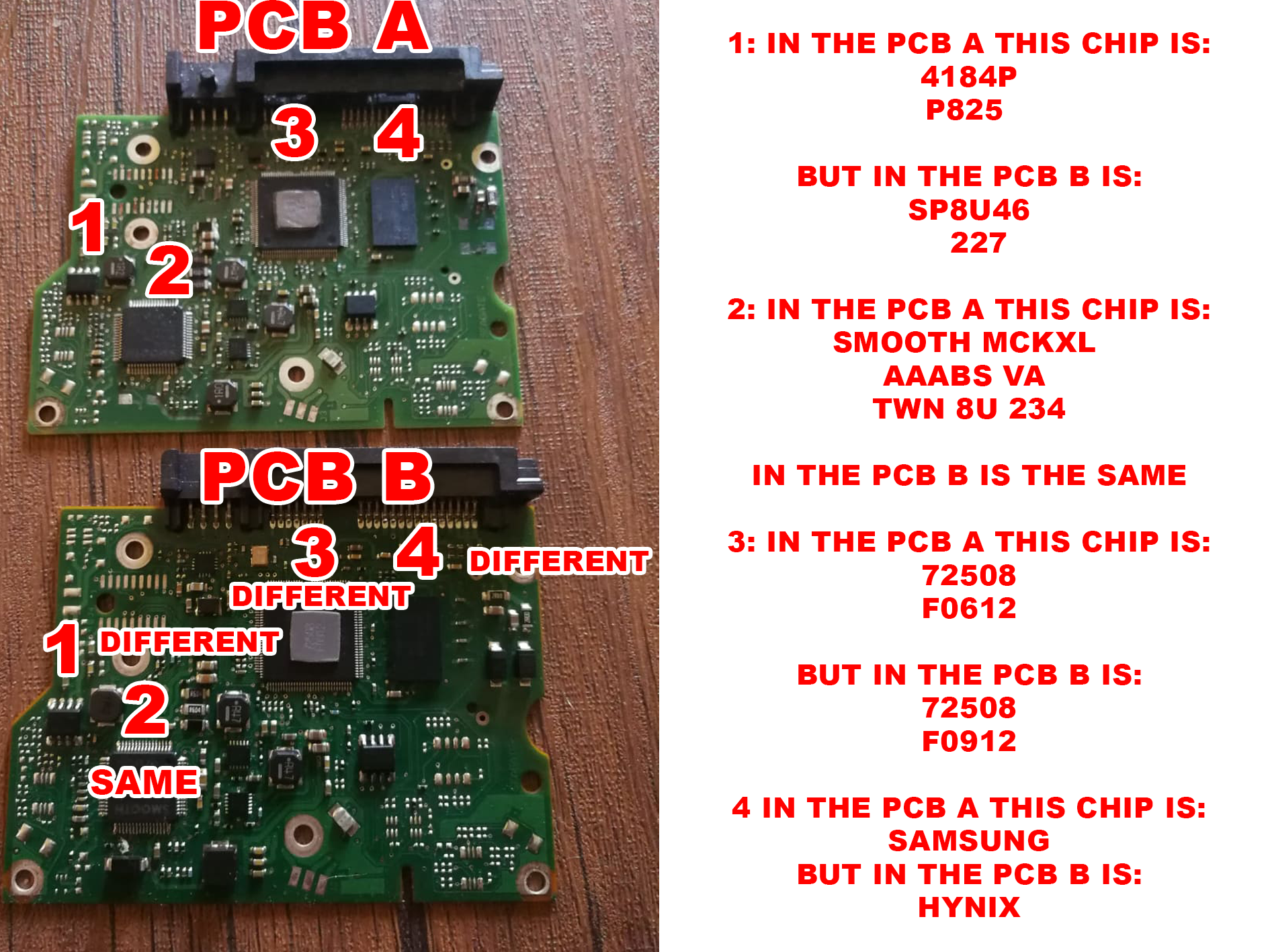

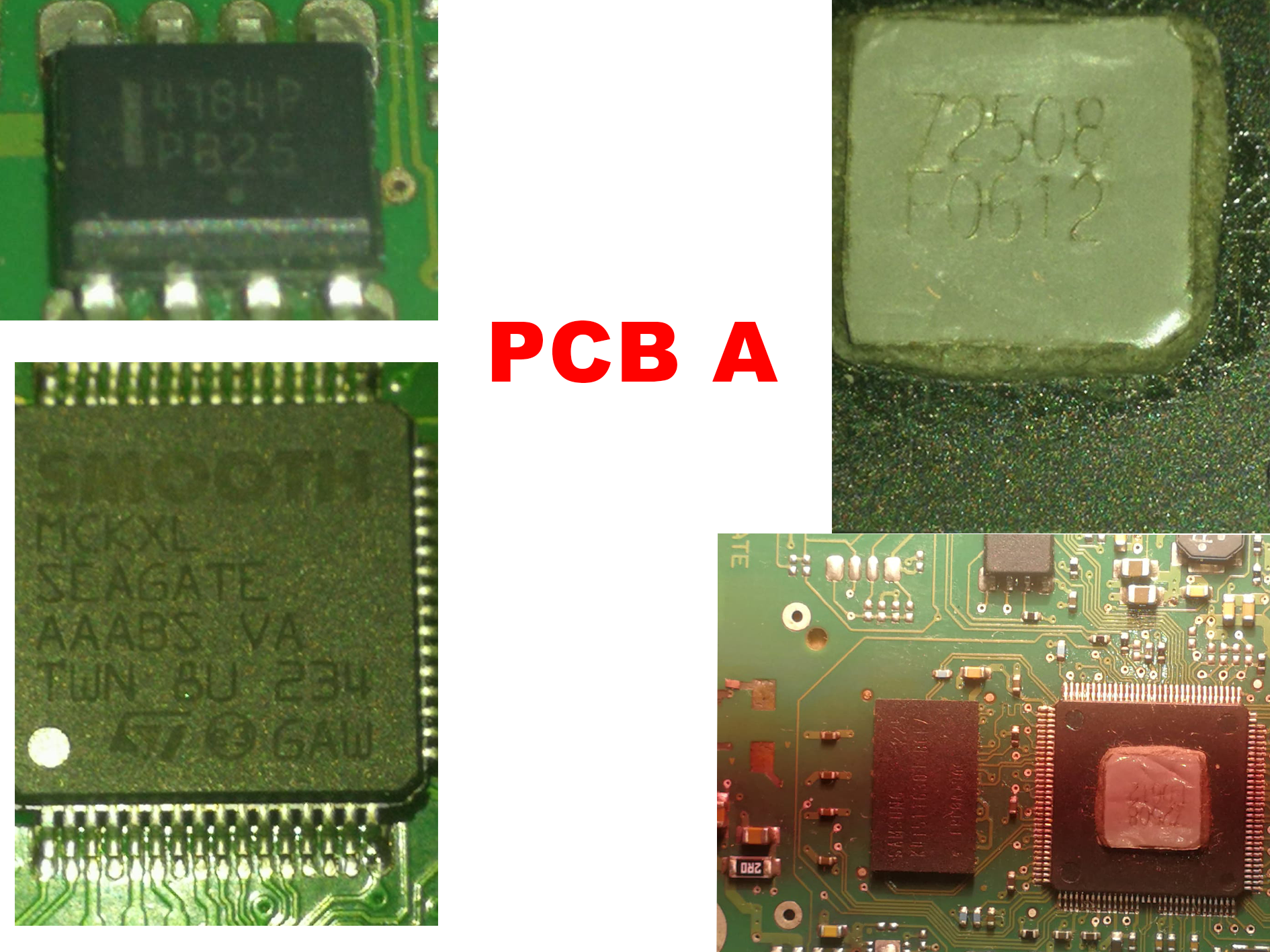

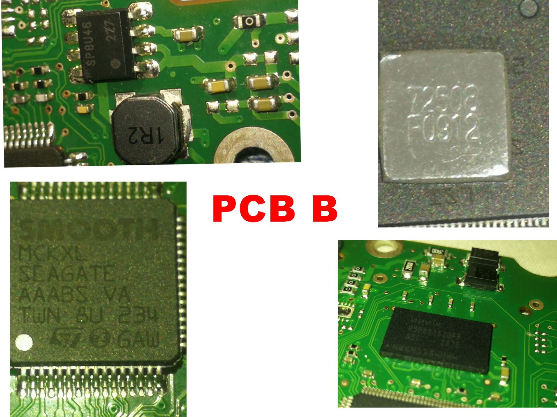

In both pcb I found some differences of some circuits or chips (I don't know how to call them)
and I don't know if that's the problem.
After I realized that the change did not work, I went to another technician and he tested the pcb with a Multimeter (the diodes, etc.) and said that the board was apparently ok, ... but I don't know ...
so my questions:
metal drop is the problem?
PCB differences?
the ic bios (firmware) is damaged??

the solder in that via (metal drop as you call) is not a problem, IC3 is B64002, you got the number from the head transfer pad, which is irrelevant.
I think there is nothing wrong with your pcb, it is probably some firmware corruption. I don't mean the flash chip that you've got moved to the new pcb, it is probably fine if the drive spins up. I mean the larger part of the frimware which is on the platters and read by the bootFW located in that chip.
Moreover this series of drives are prone to serious surface degradation which can cause very bad things inside, so i don't recommend fiddling a lot with it if your data is important.
It might be worth checking the output of the serial terminal but that's also something that can be though if you have no experience with suchlike things, partly because the voltage level is 1.8V there and most of the adapters you can get are made for 3.3 or 5V.
If you get that right there's a good chance you make things worse if you start poking around with the terminal connection due to lack of knowledge, but it should be safe to watch, until you start sending commands.

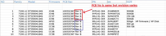

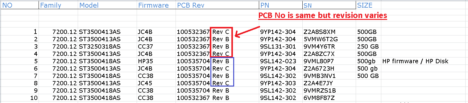

I would like to know Donor PCB criteria , Is PCB revision also crucial for ultimate donor compatibility or it can be ignored .
Often there are pcb's having same no but different revisions. Is it necssaey to keep all revisions ?
I Think its not necessary to match Revision except code , but for greater compatibility it might be necessary.
