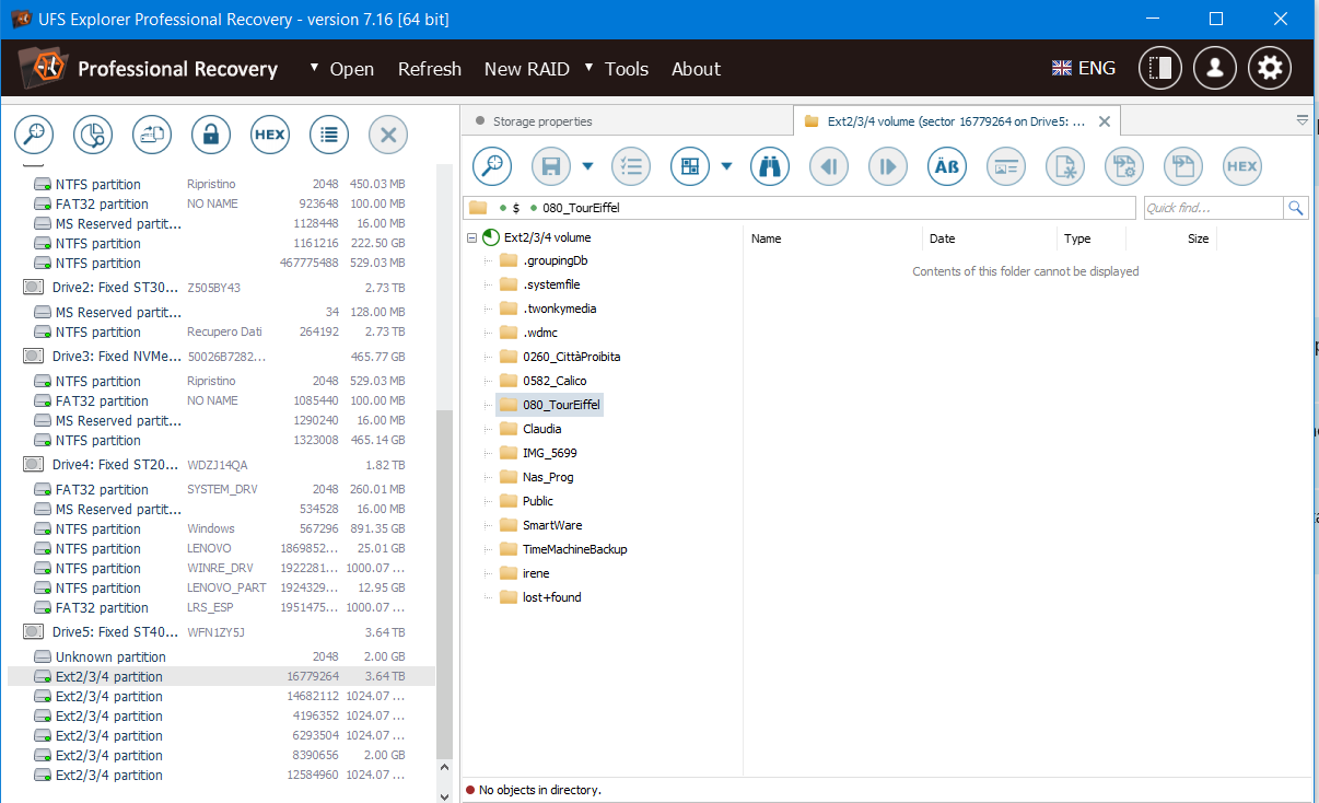

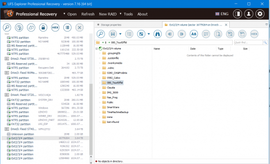

Hi guys I have swap head and data recovered from this drive but the folder inside are inaccessible, i have used linux to see the contents and it's possibile to see only file in public folder, I think the folder are protected with a password in nas. Exist a system to open and read content from this hard drive ? tks

Yes I have tried but in the folder protected in NAS i see unable to display folder content with ufsexplorer

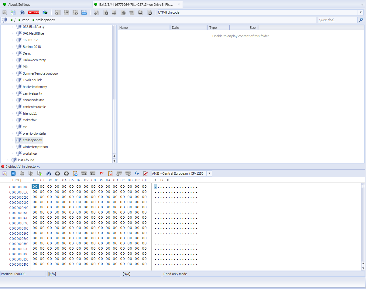

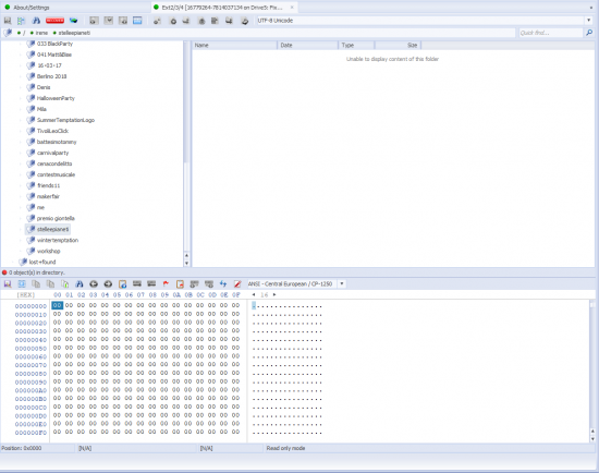

H13 wrote:
Can you post a photo?
Is it ufs7?
yes
 Post subject: Re: WD nasware 4TB mycloud
PostPosted: May 29th, 2020, 7:22
Joined: September 14th, 2018, 13:41
Posts: 299
Location: italy
and this with 7

PostPosted: June 4th, 2020, 9:05
Posts: 4840
Which version of MyCloud is it? can you post pic of pcb (from the enclosure)? That folder tree does not look like the one i remember, which had folder structure in db...
If it is simply ext4, try scanning the whole drive and look at Lost Files folder or whatever it is called in UFS
PostPosted: June 4th, 2020, 10:09
Posts: 2855
@pepe
The MyCloud which saves as DB is different,,, look @ the image the OP attached it has folder names/structure
the one you mean saves in another way...
:idea:
My best guess here (missing/damaged head)
