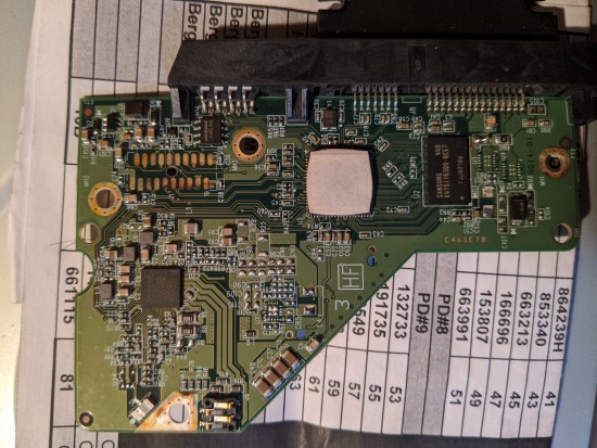

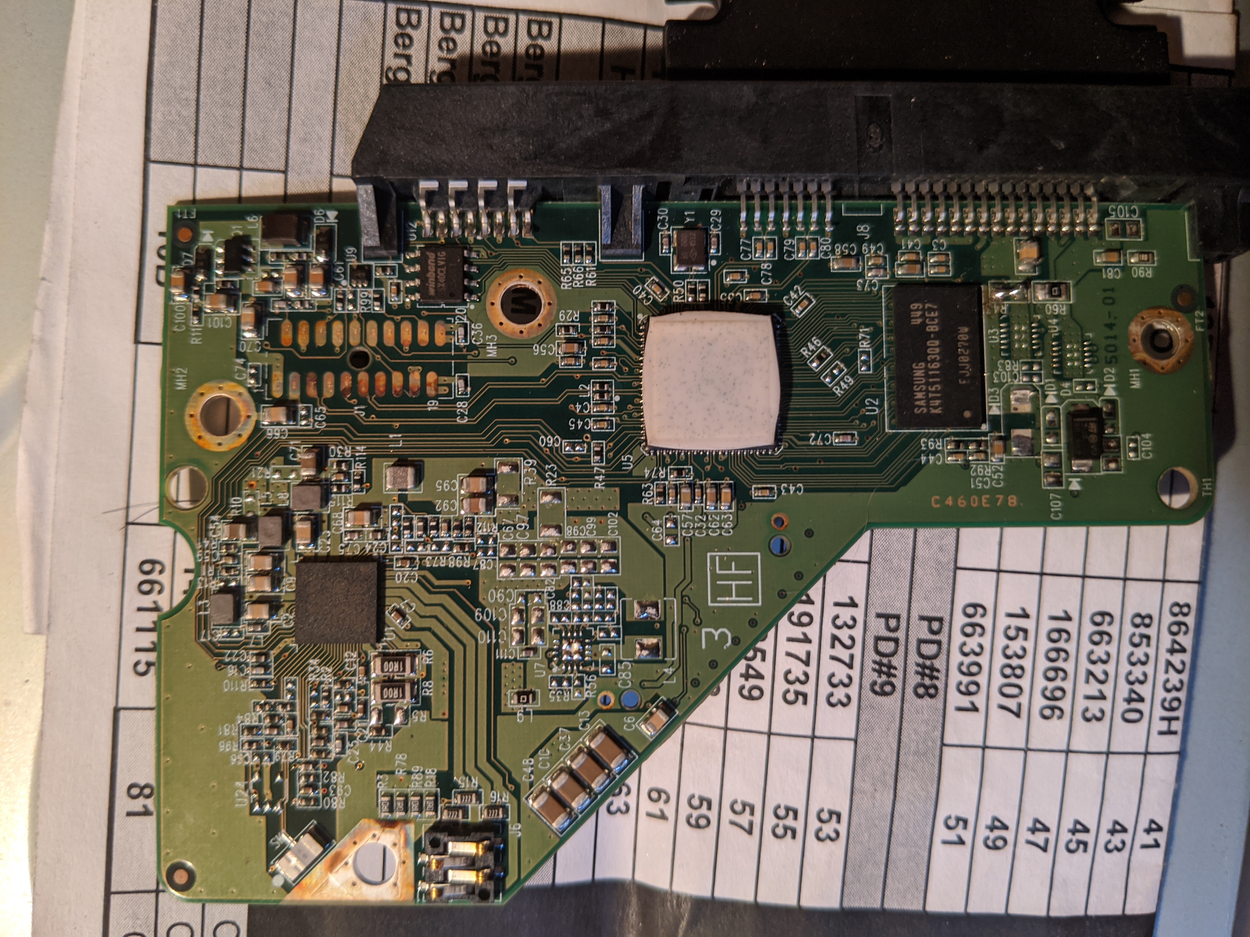

I have a WD 2060-771945-002 REV A board that I believe was overvolted. My USB-SATA interface just passes through the 12V to the drive and generates 5V. The TD1482 chip on that (interface) board cooked... obviously cooked. I know the (12) supply voltage was 13.2 volts and was being sent to the TD1482 and the WD PCB on the 12 rail. 5V rail is at 0V now. I tested on my WD board:
R60 = 0 ohms
R43 = open
D3 = shorted(0) both directions
D4 = Diode mode-550 both directions|200K mode-161 one direction, 143 settled the opposite.
Any chance of a preamp failure or I'm missing anything? I am looking into DR to do a board swap but if they have to really dig into the HDD, I'm writing it off.
If there isn't a high likelihood of preamp failure, I can replace/repair components on the PCB. I just don't feel comfortable enough with my hot air station to do a BIOS swap. Also I don't want the "we got to fix your screw up" charge. So it's go for broke or leave it alone.

Remove D3 and flow a blob of solder over R43. Then test the PCB on its own. Hopefully that's the only problem.
You can test for shorts at the preamp by measuring the resistance between ground and each of pins 1 and 3 at the HDA connector J1. I think there is a very good chance that the preamp will be OK, and that the original HDD PCB is salvageable.
Hdd-parts.com is one PCB supplier that includes a free ROM transfer should you need to go that way.

I did the diode remove/resistor bridge mod. I have 4.97v on the 5v rail and 12.1v on the 12v rail measured at the diodes. I measured J1 between pin 1(+) and 3(-), got 4.55 volts. Should I go forth and connect board to drive? Or is there any other tests I can do the double check?

Measure the voltages between ground and the inductors (L3, L5, L8, L1, etc)) adjacent to the motor controller chip.
 Post subject: Re: WD Drive Power issues
PostPosted: June 21st, 2020, 2:07
Joined: June 18th, 2020, 16:54
Posts: 13
Tested 6 inductors
L1-0.94v
L3-0 volts (double checked both sides)
L5-1.81
L6-1.22
L8-2.5v
L9-4.95
Hopefully they are what they should be, though L3 voltage seems fishy.
File comment: Photograph of Board

Also got 5-6v on every J6 pin. After several seconds it dropped to 0. I'm guessing it was trying to spin the drive, then gave up? After power cycling, the voltages came back.
PostPosted: June 21st, 2020, 4:49
Posts: 17316
Looks good. Good luck.

Installed The board with good luck. The hard drive is alive! I got any remotely useful data off of it. Which wasn't even 1% of the drive. If the hard drive dies tomorrow I couldn't care less. I'll use it as a nondependent backup drive.
Clarifying, without the TVS on the 5 volt rail, any power surge on that rail could cook chips as there's nothing else to sacrifice itself?
And IIRC from other threads, This drive needs to be treated as a here today, gone tomorrow for the rest of its life?
Would one suggest getting a donor board to transplant a new TVS and resistor to my board to improve reliability and decreases chances of full premature failure?
PostPosted: June 22nd, 2020, 15:37
Posts: 17316
I would spend my money on a new drive and keep the current one as a backup. A TVS diode costs $1, so that's cheap insurance.
