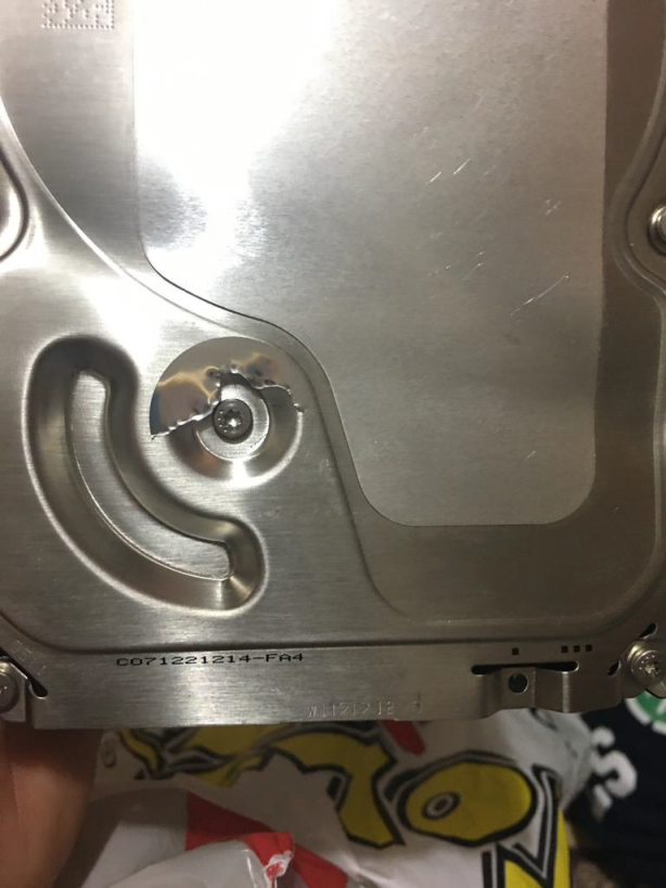

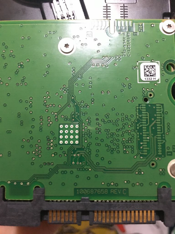

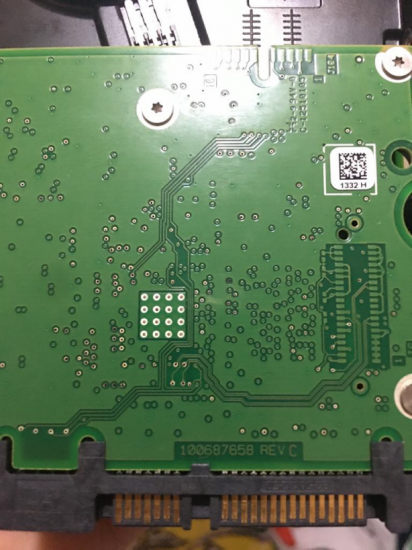

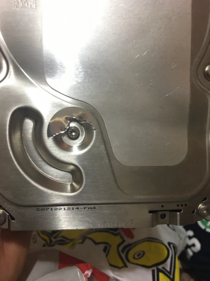

Nightmare...
I need advices
 Post subject: Re: Lost sticker & head case & opened
PostPosted: June 9th, 2020, 5:17
Likely a 2TB Grenade drive, model ST2000DMxxx.
For mechanical components look at the first 3 characters in the serial number on the drive itself located on the chassis sticker.
If needed, for PCB replacement, the specs are on the PCB.

Check model and preamp in ROM if you are in doubt.
Is this your own drive and what is your goal here, data recovery or drive repair ?

...assuming that the PCB is native. At least that can be confirmed by matching the SN in the ROM to the one on the end of the drive.

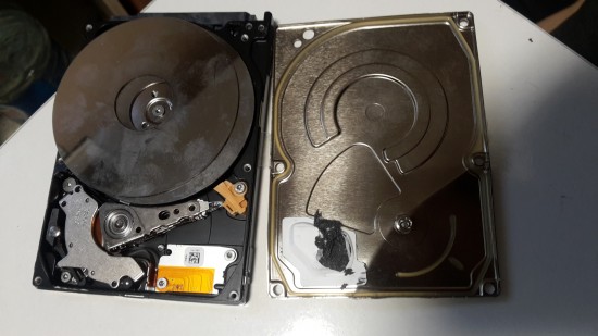

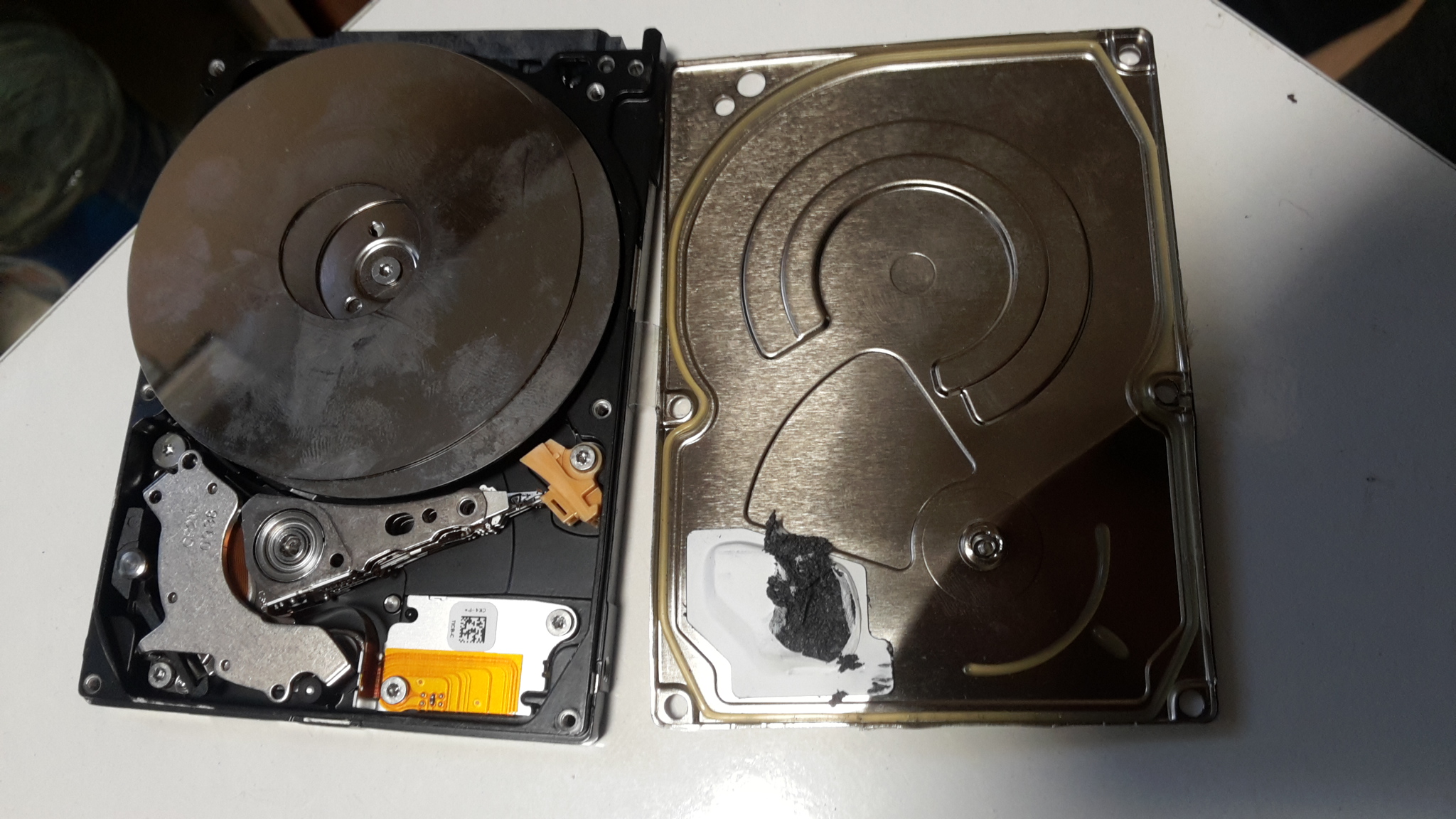

Opened package. And saw disk like this
PostPosted: June 10th, 2020, 2:58
Posts: 3551
Agree, this drive most of the times has Grenada ST2000DM001 inside, usually 1CH16x models.

HDDdonorMarket, I have eye-troubles, can't see detail in your crystal clear pictures, what do you think happened to that hard-drive?
PostPosted: June 22nd, 2020, 2:42
Posts: 489
Location: Usa
S10 drive not in mi hand. Someone asked me info about whether recovery possible or not.
Ana hr haven't send drive yet. Guess He won't send.
2 nd drive platters removed I dont know which one up and rotated or not.and fingerprints on them. . Ali oreamp burned
