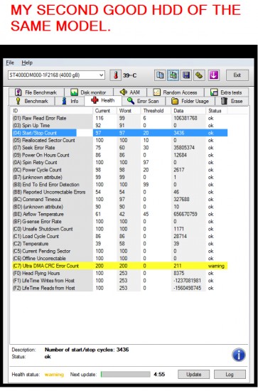

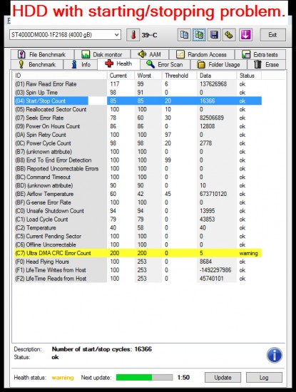

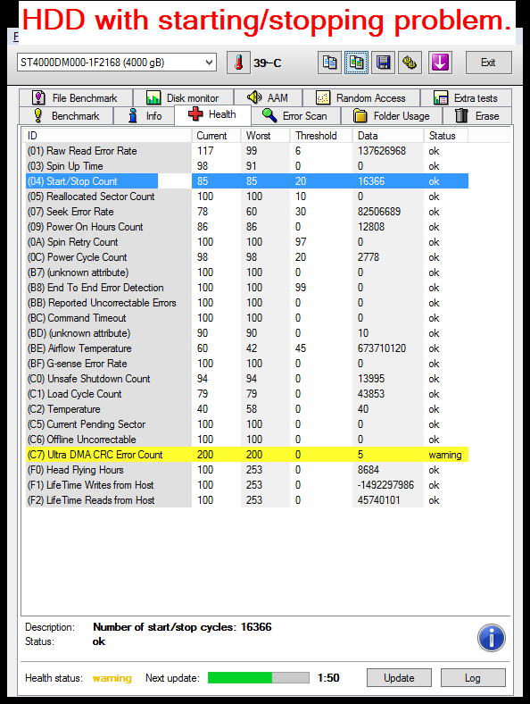

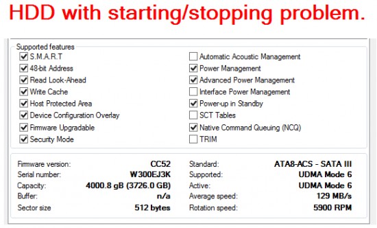

Hello.
I have a problem with my HDD st4000dm000-1f2168. It constantly starts\stops on its own, according to the increasing value of the SMART "Start\Stop count" attribute. It hangs for a little bit, maxing out the blue graph in Windows Resource Monitor, then unfreezing, and do it all over again if you try to read\write from it. Otherwise, in idle mode, it doesn’t do that start\stopping thing.

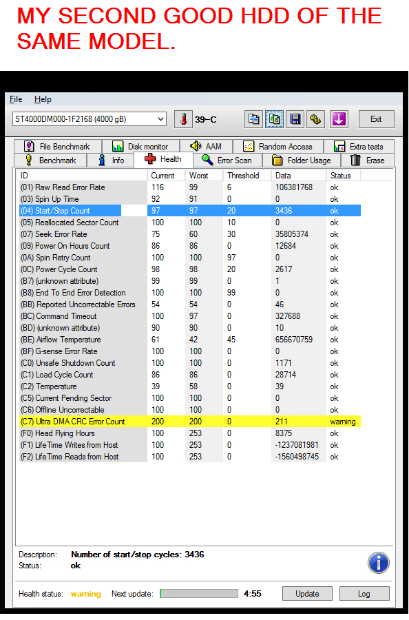

I’ll attach screenshots with SMART of this HDD. Also, I have the second HDD of the same model, it works just fine, and "Start/Stop count" is much smaller than it is on the faulty one, despite them working in my PC for the same length of time since I bought them.
My Motherboard is ASUS Z97-PRO.
What may be wrong with it? Is it dying? I’ve tired different SATA wires and different SATA ports on my motherboard, there was no effect on this starting\stopping behavior. I haven’t tried plugging disk up to a different PC though.
Thanks in advance.
