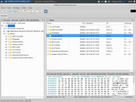

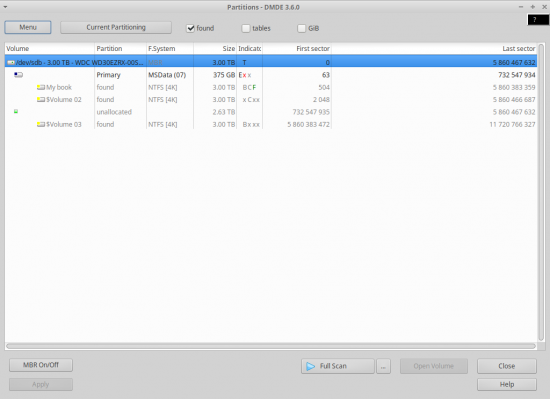

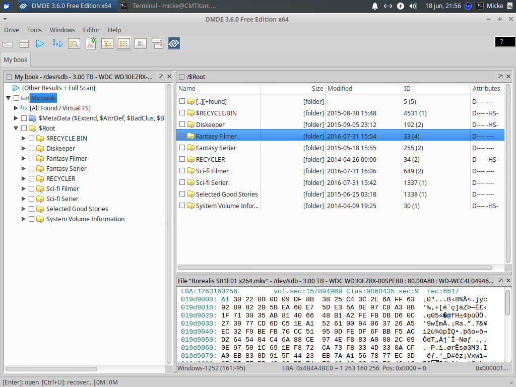

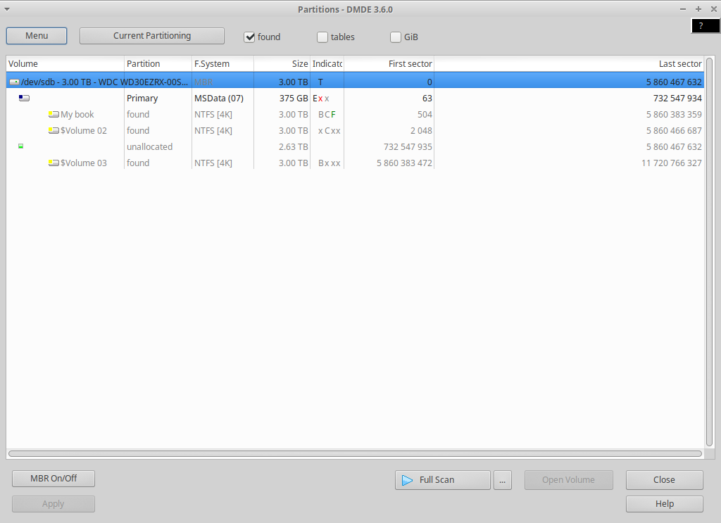

Amazing, I just discovered with with dmde that my files are not encrypted, it's just windows that has messed up the mbr, and it should be a gpt.
So can I restore the partition?
If not I will have to buy a new disk to recover the files to.
 Post subject: Re: Help with a encrypted WD mybook 3TB
PostPosted: June 18th, 2020, 22:46
Posts: 17137
Your enclosure is configured with a sector size of 4KB. When you remove the drive from such an enclosure, you expose its native 512e sector size, rendering the file system inaccessible. Essentially you now have a 4Kn file system on a 512e HDD.
Your best solution would be to recover the files to another drive and then repartition and reformat the 4Kn drive inside your PC in 512e GPT mode. That's unless you want to purchase a replacement bridge PCB.

Hi again!
I just want to tell you that dmde had no problem inserting the mybook partition, it's now mounted and fully accessible.
The smart tools report 512 logical sector size and 4096 physical sector size.
Dmde is the best HD tool I ever used so far, it found the partition without several hours of scanning.
All my files was saved.
Thank you again for all your help.
