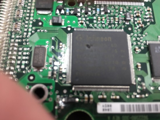

I've got a customers old PATA IDE hard disk.
Its a Seagate ST317221A (U8)
The PCB is SG22580-300 Rev A.
The drive doesn't power on.

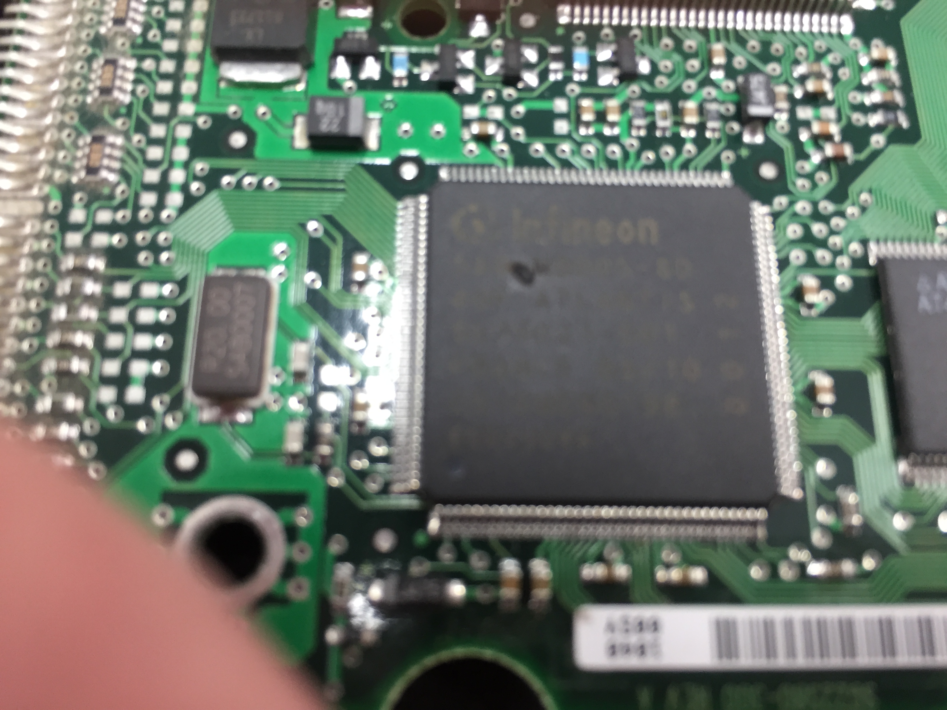

Checking the drive, the Infineon controller chip has a scorch mark on the top of it.
The chip rapidly gets hot when power is briefly applied.
The chip is labelled:
SAB M3005-8D
40F ATLANTIS
SG70021-501
FRANCE BA/10
SIEMENS' 98
EC025084
I replaced the PCB with another SG22580-300 Rev A
The only difference in the chips is the new PCB, the last line is EC020018.
With the new PCB, the drive does not power on either.
No components get hot on this board.
Would this indicate a problem with the motor and/or heads?
Assuming I can get the drive to spin up, do I have to tranfer any ROM chips between boards like most later boards required.
If so, there does not appear to be any standard BIOS chip - no 8 pin chip anywhere.
I guess it may be integrated into the controller?
Or could it be either the 14 pin chip labelled ST 8008 324 PHIL, which I cannot find any info on?
Or the 16 pin chip labelled HC4050 D01SG n00SB, which looks like it may be a buffer chip?
Any help or advice greatly appreciated.

Your PCB doesn't appear to have any protection at the 5V input. Therefore I suspect that an overvoltage on the 5V supply may have been the reason for the damage to the MCU. I don't know how the preamp is powered, but I suspect that it may also be damaged.
If you isolate the HDA, does the drive then spin up?
What resistance do you measure between each pair of motor pins?
The ROM ("BIOS") chip is the Atmel AT49F1024 parallel flash memory.
The "ST B008 324 PHIL" appears to be a standard LM324 quad op amp.
"HC4050 D01SG n00SB" appears to be a 74HC4050 "hex non-inverting HIGH-to-LOW level shifter":
https://www.nxp.com/docs/en/data-sheet/74HC4050.pdf
The LX8117-33 chip is a 3.3V linear regulator.
Here is my datasheet database:
http://www.users.on.net/~fzabkar/Datasheets/DATAURLS.HTM

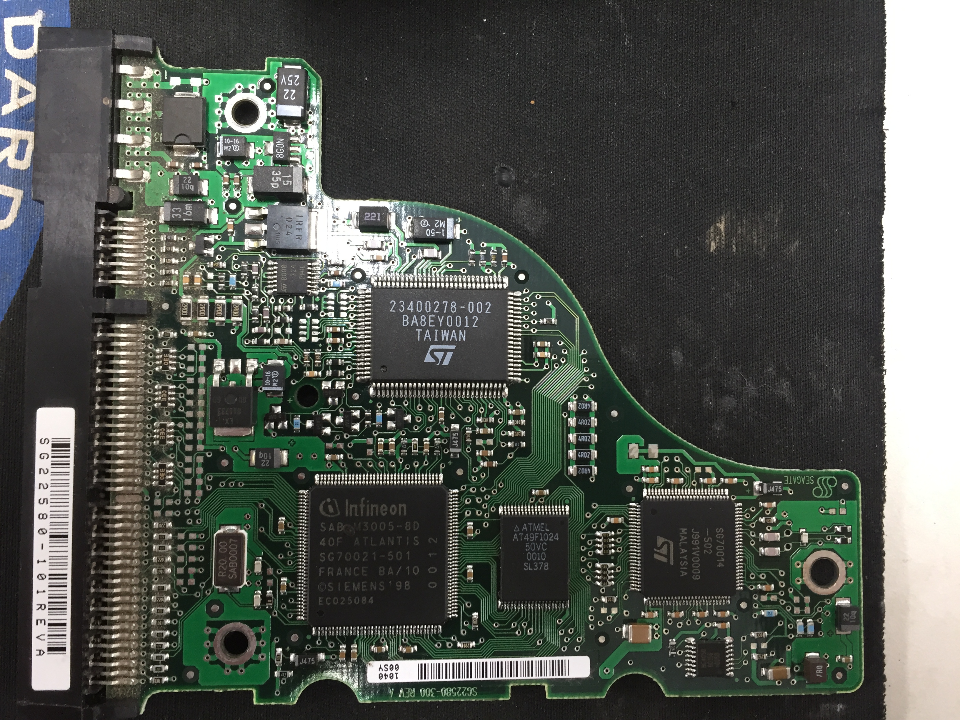

Some modern drives support Power Up In Standby (PUIS), but I don't know if it was supported in your model. However, that would be a remote possibility in any case.
I suspect that you measured 8V at the SOT-89 component marked "8G0N". That's probably one of the supplies for the preamp. The other supply is probably the 5V rail.
L78L08ACUTR, STMicroelectronics, linear regulator, 8V, 100mA, marking 8G, SOT-89:
https://www.st.com/resource/en/datasheet/l78l.pdf
I expect that the 3.3V supply would be the MCU's Vcore.

BTW, here are hi-res photos of your PCB:
Seagate U8 ST38410A hires PCB photos:
http://www.hddoracle.com/viewtopic.php?f=112&t=113

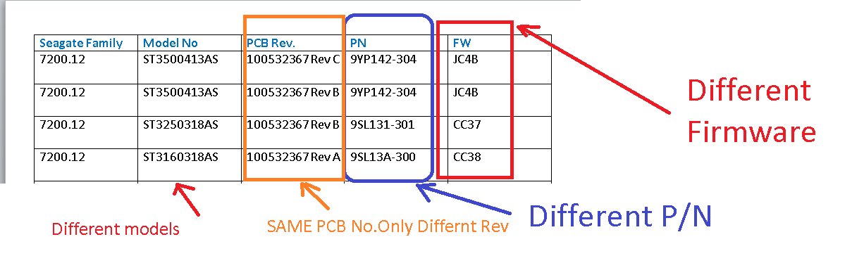

I would like to know role of alphabet in PCB no ( Rev.) and whether this Revision plays any role in ultimate PCB compatibility.
For example --
HDD family -- 7200.12 same
Model Nos --- Different
PN nos - Different
Firmware --- Different
PCB No -- Same
Revision -- Different.
so in this case for different models same PCB no. is there only Rev. is different. Are all of these PCB's intercompatible ?
Can you pls give your expert opinion.

@posidon, I can't answer your question, except to say that the 318AS and 413AS models have different DRAM capacities, even though their PCBs may be otherwise identical..

And U8 drives are fairly sensitive to firmware version, which is not noted on the pcb.

Hi again fzabkar, and sorry for the delay.
Glad to hear that you don't believe the PCB requires a ROM transfer.
I matched the model and PCB version, but may not have got the exact firmware version...
Yes, I did buy it from Payam... however I should have spoken to them to get the firmware revision first...
@BGman. Thanks for the input.
Yes, I have swapped a couple of later (than this) model Seagates, and had to swap the EEPROM.
fzabkar doesn't think it does need to be swapped, but you seem fairly sure?
The later models where I had to swap the ROMs did in fact spin up with the incorrect ROM, from memory - although admittedly it was a few years ago I last did one...
In regards to the terminal, I get nothing from terminal unfortunately.
@pepe. Thanks also for the input.
Yes, I get nothing at all from terminal.
I've hooked up the TX and RX correctly onto the 3rd bank of pins from the right, with the first bank being Master.
I've used the USB-serial adapter and cables before on several drives, and to test it, hooked it up to a SATA drive, which it correctly saw the drive reporting spin up, etc.
But on this drive, absolutely nothing.
Thanks all for the input, especially to you fzabkar.
I'm happy to hear any further suggestions, of course.
I think I'll get back in contact with the PCB supplier, Payam, and see if they have the firmware details on file for the PCB and go from there.
