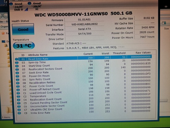

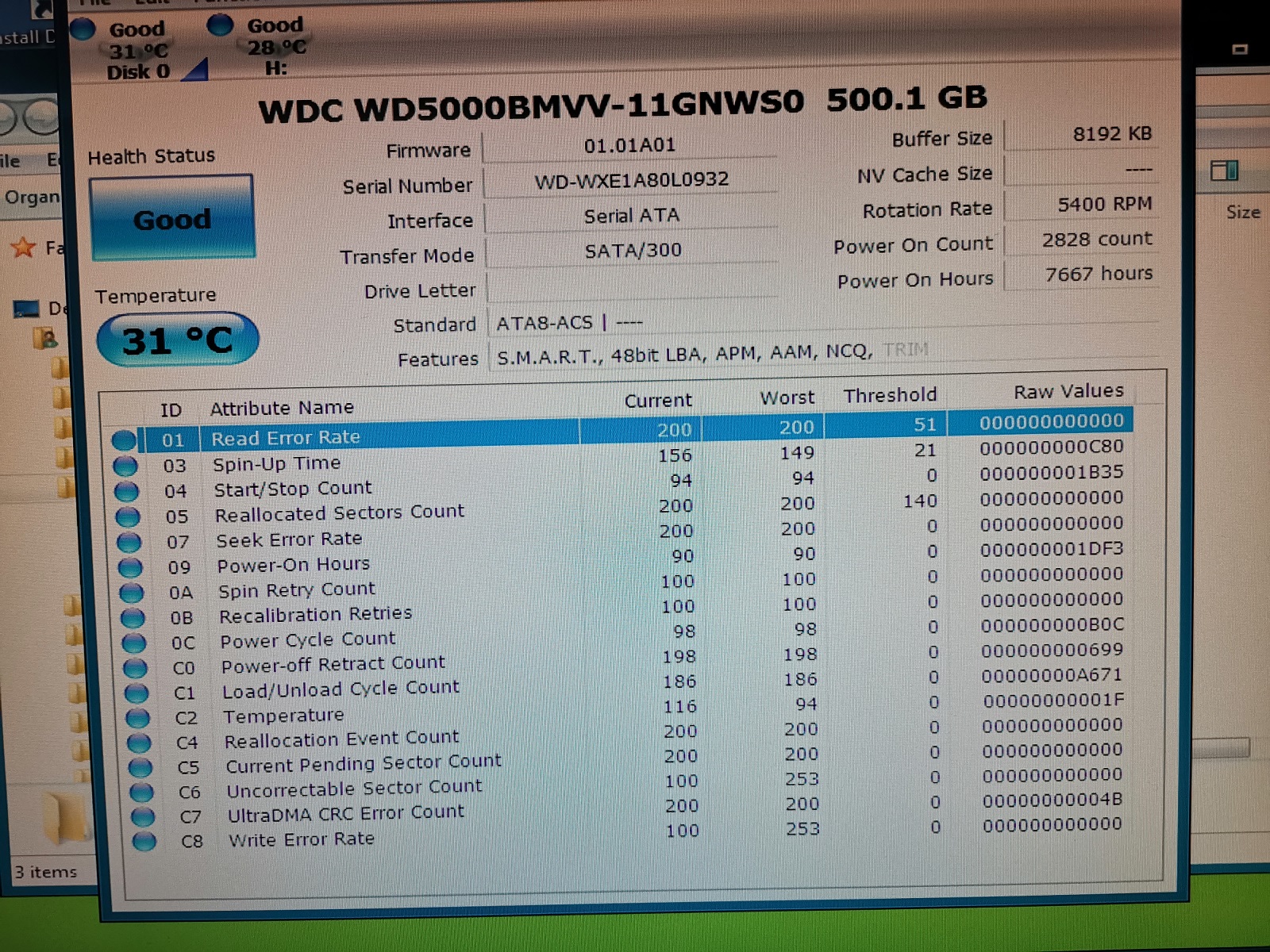

Can you retrieve a SMART report with a tool such as CrystalDiskInfo or GSmartControl?

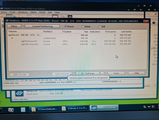

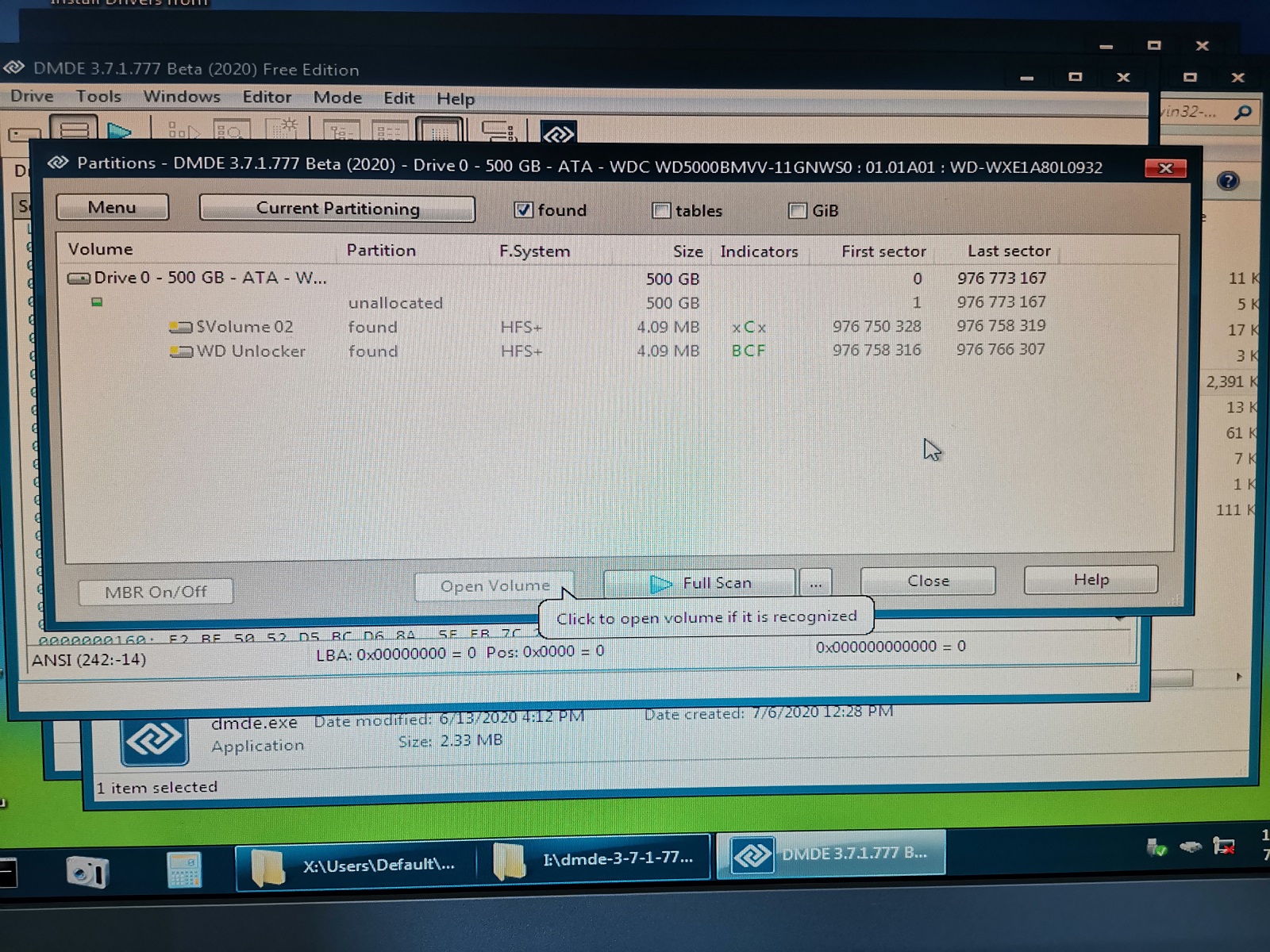

Can you show us the Partitions window in DMDE? (Don't do a full scan.)

Is it this you want?

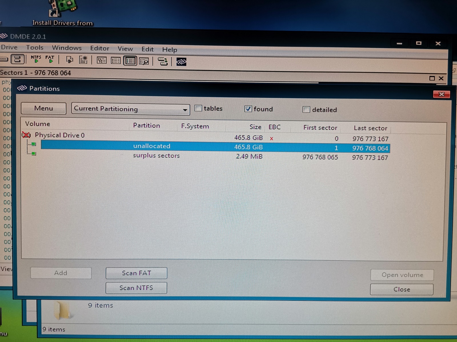

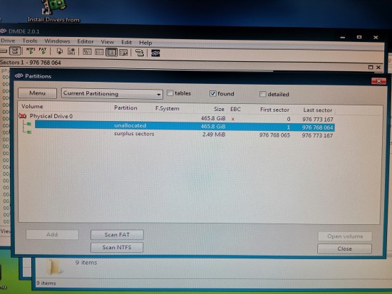

Another dmde version:

The SMART data look good.
Your drive appears to be encrypted. Examine sectors 0 and 1 to see the encryption type. The WD Unlocker and $Volume 02 are in the non-encrypted Virtual CD (VCD) area at the end of the drive.
You can try to decrypt the drive with a tool such as reallymine:
http://www.hddoracle.com/viewtopic.php?f=22&t=1488
Alternatively, here are "tools for opening some encrypted WD My Book drives in Linux":
https://github.com/themaddoctor/linux-mybook-tools
https://github.com/themaddoctor/linux-mybook-tools/archive/master.zip
