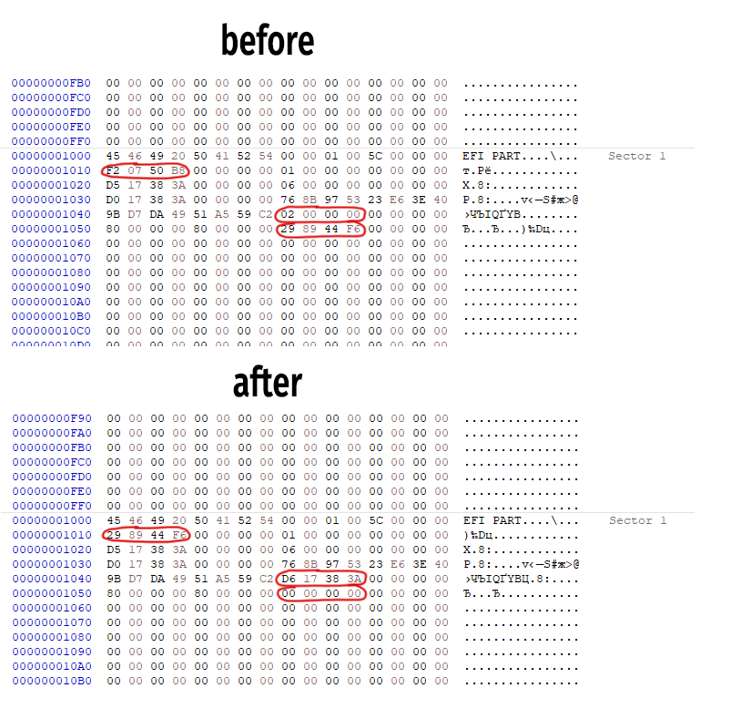

Solved (but needs some clarification)
DON'T TRY THAT IF YOU HAVE ANY CRITICAL DATA ON THE HDD! ALWAYS MAKE A COPY OF THE DATA!

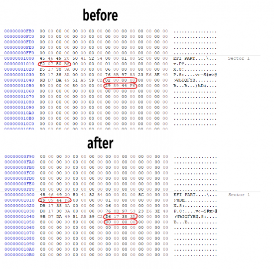

After initialization (and any further creation of volumes, copying files etc), but BEFORE the reboot, open a hex editor, in the editor - disk and delete (fill with "00") from offset 0x1000 to 0x1060. Save, reboot.
After reboot this data is recreated, but it doesn't make the POST of Gigabyte GA-Z97X-UD3H freeze.
P.S. Can anyone, please, explain, what is this at offset 0x1000-0x1060? How could it freeze POST in "BEFORE" state? What happens after I delete it and reboot? Why is it recreated differently (and doesn't freeze POST)?

Yes, it's 4K native. Note that the offset of EFI PART is 0x1000 whereas it would be 0x200 for a 512e drive.
The OP has edited the EFI PART structure so that instead of pointing to LBA 2 as the starting LBA of the array of GUID Partition entries, it now points to LBA 0x3A3817D6. The capacity of the drive is 976,754,646 physical sectors, which is 0x3A3817D6 in hexadecimal, so the BIOS is being told that the partitioning info is in the first sector beyond the limits of the drive. Obviously there is nothing to be found at LBA 0x3A3817D6, so BIOS doesn't attempt to boot the drive. I can't see how this helps the OP, though. One would still need to partition and format the drive, and I would expect that an invalid EFI PART structure would prevent this.
1. Init HDD as GPT.
2. Create 4 TB full-size NTFS partition (see "BEFORE" on the screenshot), copy some data (few folders and files).
3. Fill 0x1000-0x1060 with zeroes.
4. Reboot
5. Everything is OK (see "AFTER" on the screenshot), data is intact.
Windows 10 1909.
The only question is: will it be OK for long, or will it someday/somehow corrupt the data?
