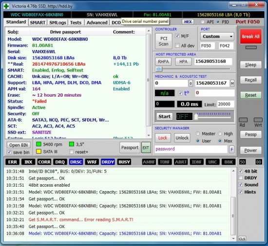

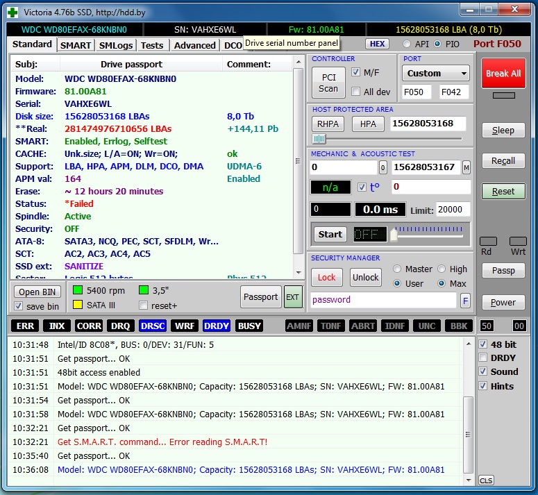

Drive is spinning, windows can see it, victoria see it.

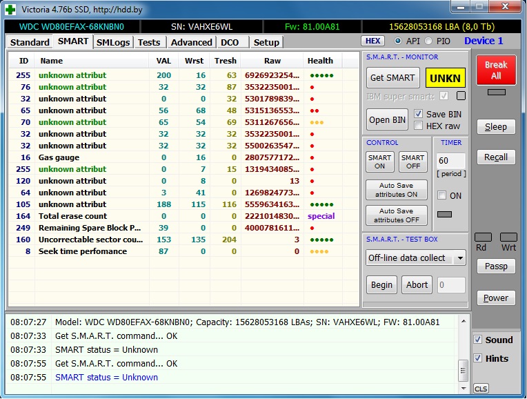

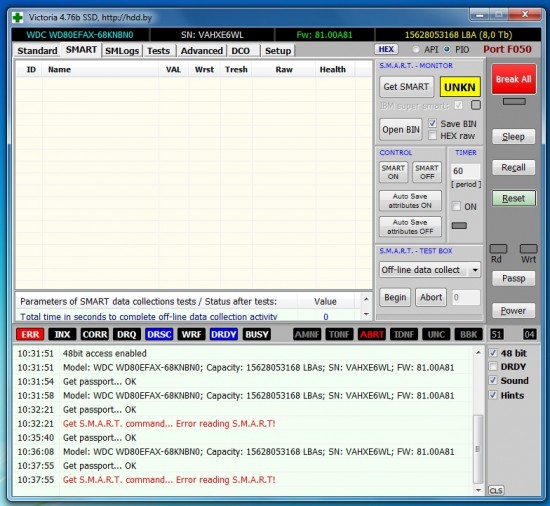

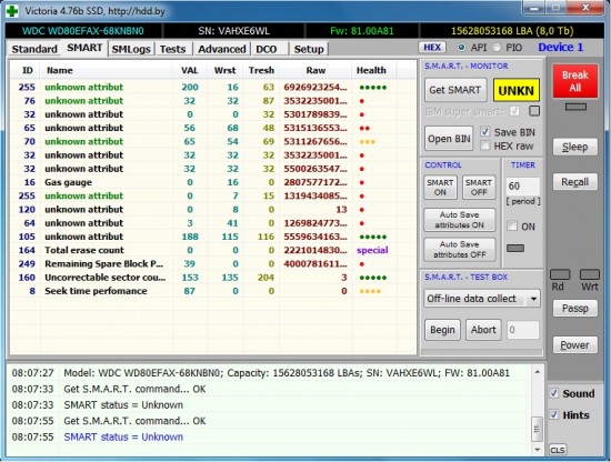

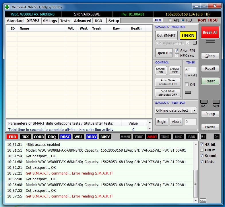

if I have to be honest the drive behaves as if it is locked with an ATA password.
SMART is not shown correctly.
Some suggestion ..what can i do to repeir the drive ?
Information on the rive is not important.
When try to do read test in Victoria :
08:26:59 : Starting Reading, LBA=0..15628053167, FULL, sequential access, timeout 10000ms
08:26:59 : Block start at 0 (0) Read error: UNCR "Data error (cyclic redundancy check)"
08:26:59 : Block start at 2048 (1 Mb) Read error: UNCR "Data error (cyclic redundancy check)"
08:26:59 : Block start at 4096 (2 Mb) Read error: UNCR "Data error (cyclic redundancy check)"
08:26:59 : Block start at 6144 (3 Mb) Read error: UNCR "Data error (cyclic redundancy check)"
Status in Victoria :
Model: WDC WD80EFAX-68KNBN0
Firmware: 81.00A81
Serial: VAHXE6WL
Disk size: 15628053168 LBAs 8.0 Tb
SMART: Enabled, Errlog, Selftest
CACHE: Unk.size; L/A=ON; Wr=ON; ok
Support: LBA, HPA, APM, DLM, DCO, DMAUDMA-6
APM val: 164 Enabled
Erase: ~ 12 hours 20 minutes
Security: OFF
ATA-8: SATA3, NCQ, PEC, SCT, SFDLM, WrUnk
SCT: AC2, AC3, AC4, AC5
SSD ext: SANITIZE
Sector: Logic 512 bytes Phys 512

Well show us this incorrect SMART, Can you write to the disk?
 Post subject: Re: wd80efax-68knbn0 81.00a81 firmware full firmware needed
PostPosted: July 12th, 2020, 1:23
Joined: February 11th, 2020, 5:08
Posts: 29
Location: Bulgaria
No , I can not write to disk.
Incorrect smart - tomorrow.
I am not at home now, but incorrect smart was shown in Victoria.
Posts: 29
Location: Bulgaria
smart attached

OK, so HDD is probably ATA password locked. Victoria interpreted return data from IDENTIFY DEVICE (0xEC) command as SMART.
If you want to be sure connect your drive to 32-bit Windows 7 after it boots, run Victoria in PIO mode and show us Standard and SMART tabs.
PostPosted: July 13th, 2020, 3:51
Posts: 29
Location: Bulgaria
So ..
HGST
victoria screens attached.

Model Family: Western Digital Red
Device Model: WDC WD80EFAX-68KNBN0
Serial Number: VAHXE6WL
LU WWN Device Id: 5 000cca 099db0387
Firmware Version: 81.00A81
User Capacity: 8,001,563,222,016 bytes [8.00 TB]
Sector Size: 512 bytes logical/physical
Rotation Rate: 5400 rpm
Form Factor: 3.5 inches
Device is: In smartctl database [for details use: -P show]
ATA Version is: ACS-2, ATA8-ACS T13/1699-D revision 4
SATA Version is: SATA 3.2, 6.0 Gb/s (current: 3.0 Gb/s)
Local Time is: Mon Jul 13 10:05:48 2020 AKDT
SMART support is: Available - device has SMART capability.
SMART support is: Enabled
AAM feature is: Unavailable
APM level is: 164 (intermediate level without standby)
Rd look-ahead is: Enabled
Write cache is: Enabled
DSN feature is: Unavailable
ATA Security is: Disabled, NOT FROZEN [SEC1]
Read SMART Data failed: scsi error badly formed scsi parameters
=== START OF READ SMART DATA SECTION ===
SMART Status command failed: scsi error badly formed scsi parameters
SMART overall-health self-assessment test result: UNKNOWN!
SMART Status, Attributes and Thresholds cannot be read.
Read SMART Log Directory failed: scsi error badly formed scsi parameters
ATA_READ_LOG_EXT (addr=0x00:0x00, page=0, n=1) failed: scsi error badly formed scsi parameters
Read GP Log Directory failed
SMART Extended Comprehensive Error Log (GP Log 0x03) not supported
Read SMART Error Log failed: scsi error badly formed scsi parameters
SMART Extended Self-test Log (GP Log 0x07) not supported
Read SMART Self-test Log failed: scsi error badly formed scsi parameters
Selective Self-tests/Logging not supported
SCT Status Version: 3
SCT Version (vendor specific): 256 (0x0100)
Device State: Active (0)
Current Temperature: 0 Celsius
Power Cycle Min/Max Temperature: -3/ 3 Celsius
Lifetime Min/Max Temperature: 0/ 0 Celsius
Under/Over Temperature Limit Count: 0/0
Write SCT Data Table failed: scsi error badly formed scsi parameters
Read SCT Temperature History failed
Write SCT (Get) Error Recovery Control Command failed: scsi error badly formed scsi parameters
SCT (Get) Error Recovery Control command failed
Device Statistics (GP/SMART Log 0x04) not supported
ATA_READ_LOG_EXT (addr=0x11:0x00, page=0, n=1) failed: scsi error badly formed scsi parameters
Read SATA Phy Event Counters failed
