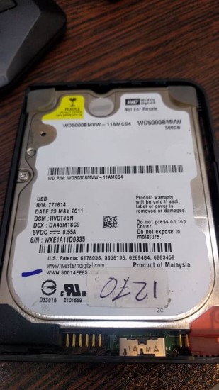

Hi this hdd has 3 head and head Num3 is dead, is there any way to recover data beside head operation?
if not what parameters of donor should be match with patient ?

Any Zephyr drive with same head map or with full 4 heads will do the job.
