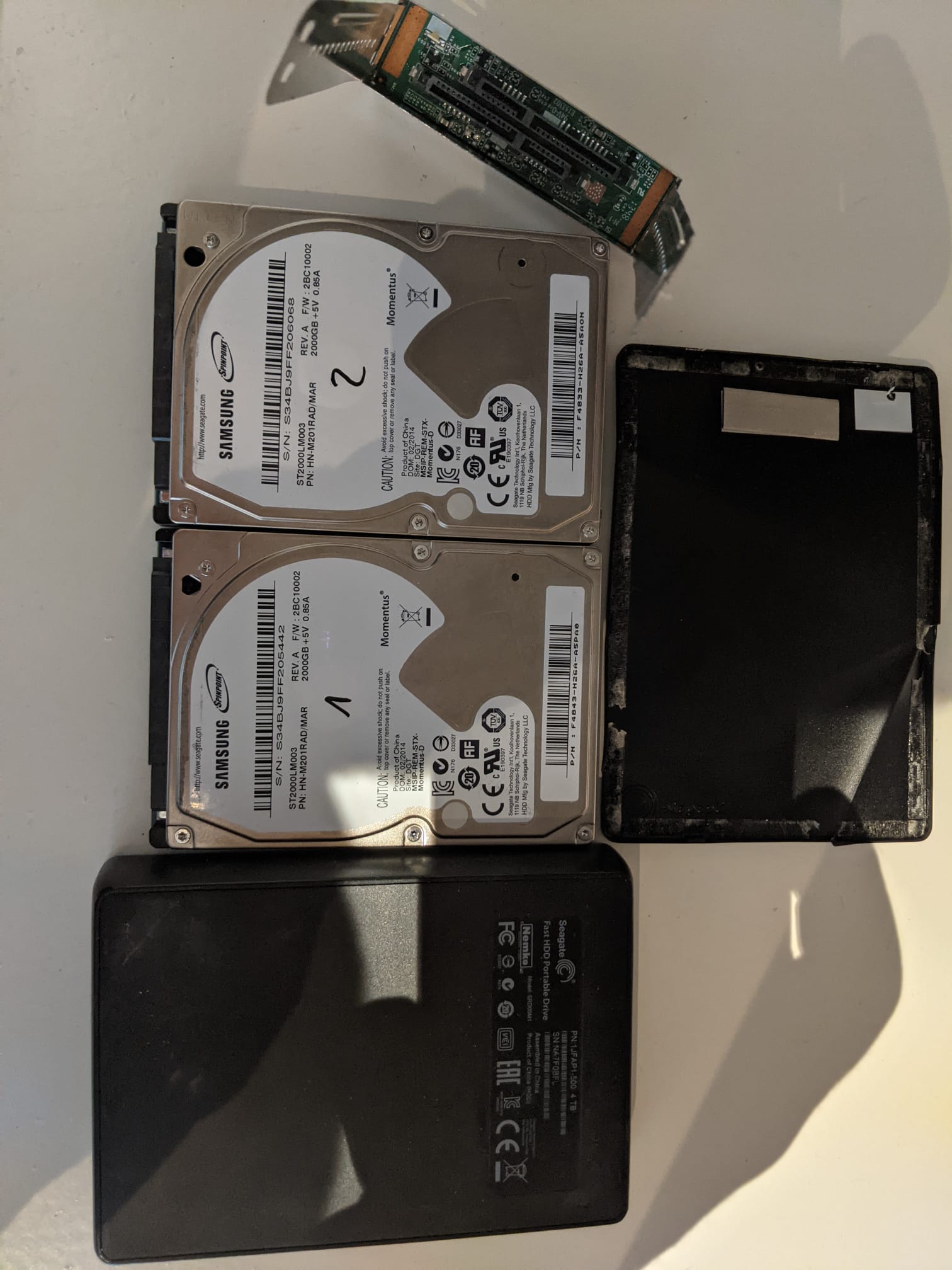

Has anyone seen this before. I got this client USB drive, enclosure show 4TB Seagate but when opened there's two x 2TB Samsung drive.
Anyone knows how those appear as one logical 4TB under windows ?

RAID0, you don`t need to guess

Yes, RAID0 but who does the RAID 0. Software installed on the drive ? I can read those drive with R-Studio but I can't see anything pointing to RAID.
-I got Lacie long time back 2 drives
-you will need to assemble it in r-studio,

Can you show us sector 0?

I seem to remember these can also be JBOD which would explain the 4TB.

R-Studio failed to build Raid0 so I tried with UFS EXplorer and that worked. Thank you for your reply and your help.
So we can add it to our database, was it RAID0 or JBOD in the end?
