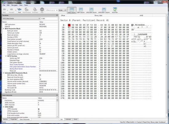

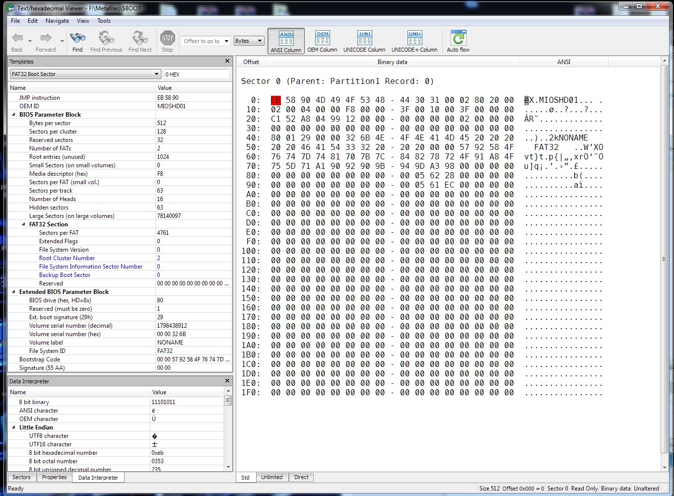

now i will post some boot sector images of this HDD formatted on music keyboard. maybe someone can tell me more. thank you

 Post subject: Re: HDD PATA music keyboard, read and write data on windows
PostPosted: January 31st, 2023, 13:05
Posts: 17091
But I was able to read and write it perfectly on Win98. but not on winXP or win7 or win10.
how come?
I'm assuming your screenshot is showing physical sector 0, not logical sector 0. If so, then the drive is formatted as a "super floppy". That is, sector 0 is a FAT32 boot sector rather than an MBR. Perhaps Win95 can deal with super floppies, but it appears that Win7 and Win10 cannot.
If you can find some way to trick Win10 that it is a removable drive, then that may enable Win10 to mount it.
Otherwise, if your screenshot is showing physical sector 63, try to access the drive with DMDE.

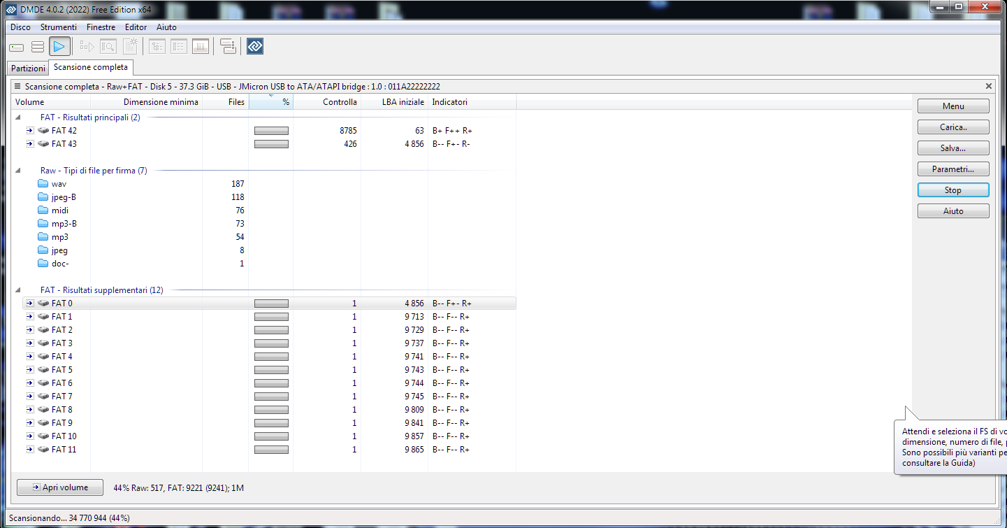

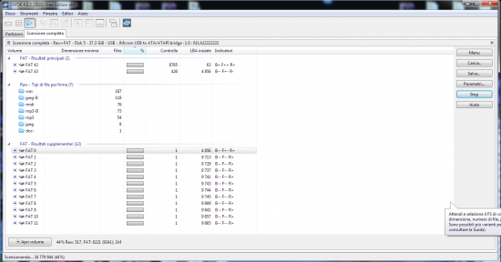

I'm trying the program you suggested. strange things happened. can you figure something out?

I have analyzed the parameters of FAT0. the first FAT0 is fat32, while all other FAT1/2/3/4.... are all fat16!
PostPosted: February 1st, 2023, 6:50
Posts: 17091
galaxy76 wrote:
both win98 and linux work. I need to be able to read and edit them on windows 7 or 10.
I don't understand why you needed a full scan in DMDE. All you should have done is to d-click the FAT32 partition at LBA 63 in the Partitions tab. Then DMDE should have presented you with a file/folder tree under the $Root. Can you show us a screenshot of the Partitions tab?
PostPosted: February 1st, 2023, 16:16
Posts: 17091
There are many differences between the OP's boot sector and a standard MS FAT32 boot sector:
https://thestarman.pcministry.com/asm/mbr/MSWIN41.htm
Also, the cluster size (128 sectors) is larger than the MS default (64 sectors), although I doubt that this would be an issue:
https://support.microsoft.com/en-us/topic/description-of-default-cluster-sizes-for-fat32-file-system-905ea1b1-5c4e-a03f-3863-e4846a878d31
