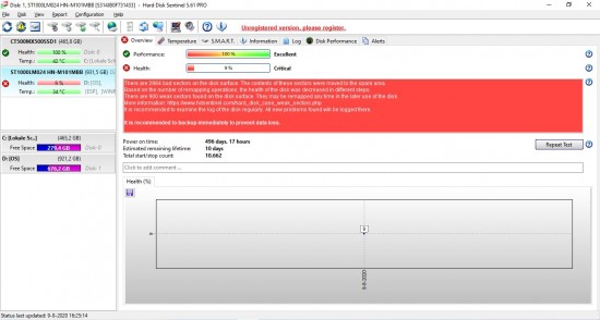

Hi guys, I am a new noob here. I really apprectiate ANY kind of help youre willing to give me.
Running WIN 10, 64 bit DELL Computer. Computer froze with Firefox. Accidentaly hit it. Closed the lid to let it go in sleep mode. It wouldnt go. Pressed the on/off once. Still nothing. Presses On/Off for 5 sec to shutdown. Startup I get endless loop of startup repair. DELL Pre-boot System Analysis shows error 2000-0142. Error in the HDD. Get a HDD 3.0 capsule. Acces it externally from a different laptop. Take ownership of all files. HDD is accesible. Start copying. Its extremey slow (26 days). Use TeraCopy instead. Keeps freezing at 30%. Number of days later, some folders cant be accessed anymore (the file or directory is corrupted or unreadable). Yet some days later HDD is not seen in 2 out of 3 USB ports. Use HDSentinel (see attachment). Nearly 3000 bad sectors!
PLEASE guide me to saving my files. Some friends advised program Deepspar Disk Imager.
1. Should i clone the drive first? 2. On Testdisk website it says ´Windows may have some problems in dealing with bad sectors on a damaged hard disk, so the best solution is to use a Linux OS to copy data to another hard disk.´ should I use Linux bootable USB.
3. When is the time to look for professional recovery companies and can I try fixing it recovering myself first since its expensive and infringement of privacy?
File comment: Snapshot

Hi
DDI is a hardware imager and not a program. I don't think it would be wise to spend 4-figures to buy DDI just to recover your drive.
To answer your questions:
1) YES. By all means.
2) Testdisk is right. You can try HDDSuperClone tool which is Linux based and is especially designed to help in such situations where the media is degraded. But...
3) If your data is valuable, I suggest you contact a good pro. Your drive is dying fast and if it fails during the imaging process, well, it won't be fun.
To sum it up:
If your data is valuable, consult a good professional.
If you can live with the idea of your drive getting unrecoverable for good, then you can try HDDSuperClone and try to image your data to another drive.
