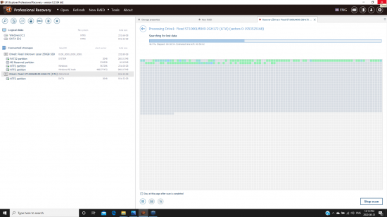

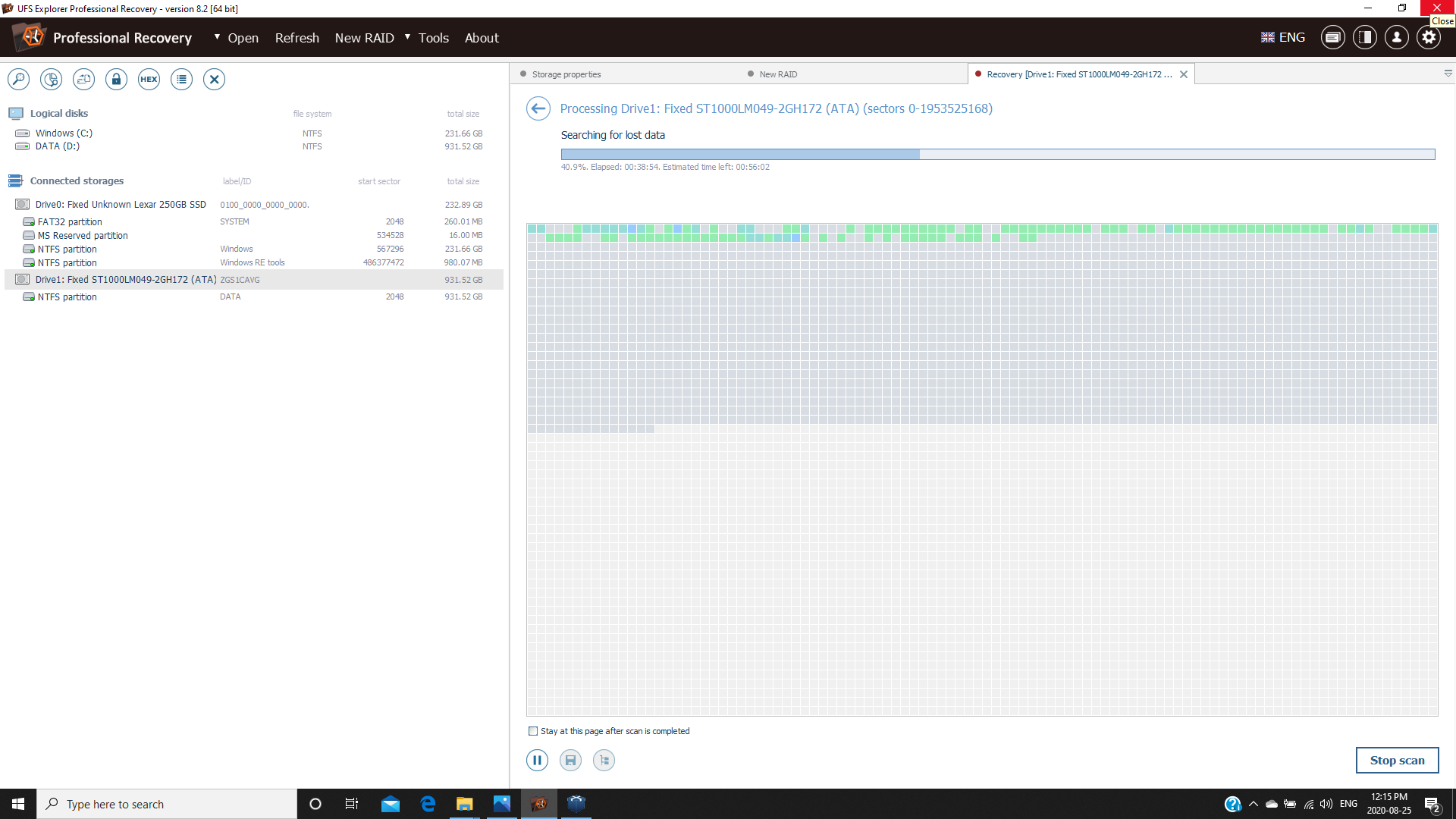

Thought I would post this screenshot of the recovery process to see if there are any other people able to shed an answer on my original answer of if I would have better luck sending this drive in to be professionally recovered.
In the screenshot, I am using Recovery Explorer Professional and I am seeing a trend with any software I try showing the first parts of the recovery as seeing data (colored squares) then the rest of the drive coming up blank (grey squares) Naturally I know how data is written in terms of blocks, but there should be a lot more color squares considering the amount of data originally lost on this drive.

I think it's an SMR drive, so data is probably TRIMMED. In which case file recovery software will get you no where.

Did you try opening the whole HDD in a hexadecimal editor like WinHex, and scroll down to see if there's actual data beyond the “colored squares” area, or if it's totally empty ? If it's all empty, whatever caused this, then noone will be able to recover anything from it (except perhaps God and/or Chuck Norris). If there's data all the way through the end, on the other hand, there may be some hope.
Did the softwares you tried do a filesystem scan only, or also a file signature search, also called “raw file carving” ? If the filesystem structures have been badly damaged in the process, more files could be recovered that way, with an unpredictable degree of reliability (for instance this method works poorly with fragmented files). I don't know about Recovery Explorer, but R-Studio has very good raw file detection abilities, as does the freeware Photorec (although it's less convenient as it extracts everything it finds on-the-fly in a single pass, it's not possible to check the result before selecting which files to extract).
