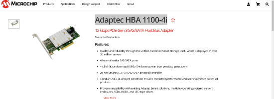

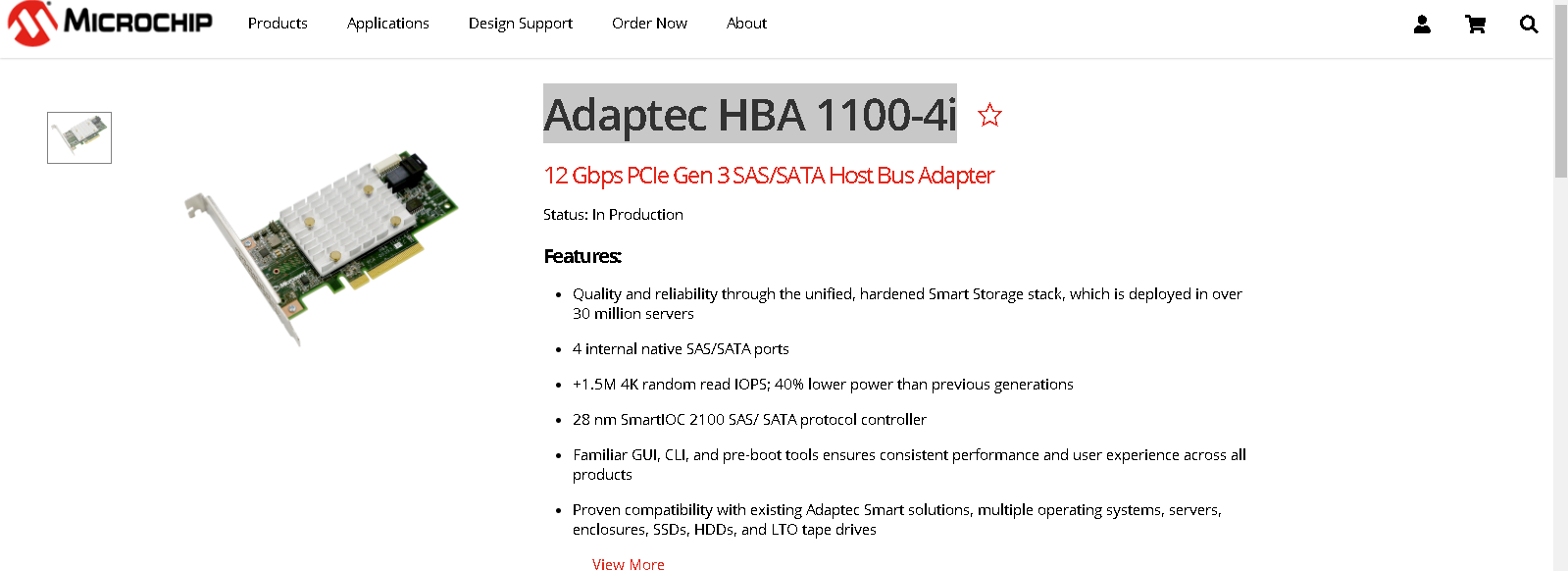

Hi all
Will this card enough to access all latest gen. SAS disks without initilization by card ( direct access to disk )
Its only $210 .It supports 12GB SAS drives .If it is suitable for SAS cloning or Dat Recovery then I will buy it as I am stuck up with a case.
https://www.cnet.com/products/microsemi ... ie-3-0-x8/

terminator2 wrote:
Hi all
I remember that i had a trouble experience with one of those cheap cards before... (once only)
it ID drives without any problems,, but when the time comes to Dumping it dumps with some sort of Data Shifts..
I did not notice it, but someone here noticed it when i was sharing the output results with him
Conclusion, better invest some extra $$ and get something that Really Works.. (my advice, take it or leave it)
good luck

einstein9 wrote:
terminator2 wrote:
Hi all
good luck
Hi einstein9
Thank You so much for very important advice . Here we are dealing with already failed device so our equipment must be capable to address the issue .
I have postponed decision to purchase the card and will wait for more funds. I am dumping adaptech and will check with LSI megaraid.
Actually the issue is lot of cards are old and outdated but again are sale so I am confused which is new and old .(some of them are released in 2015)
I want latest generation of HBA which will ne able to image any current generation SAS disk
Thanks again.

I have tested many of them, i actually dont like any kind of Adaptec, and have some troubles with Areca HBA cards. Lsi is my favorite brand for now.

Its Final - For DR purpose and in general LSI is the best. Final words in Raid is obviously from Dr- Kiev since he has done PHD in Raid Recoery.
Thank you Dr-Kiev ,your right advise might save thousands of $ from those who are upgrading there Raid cards. :-D :good:
