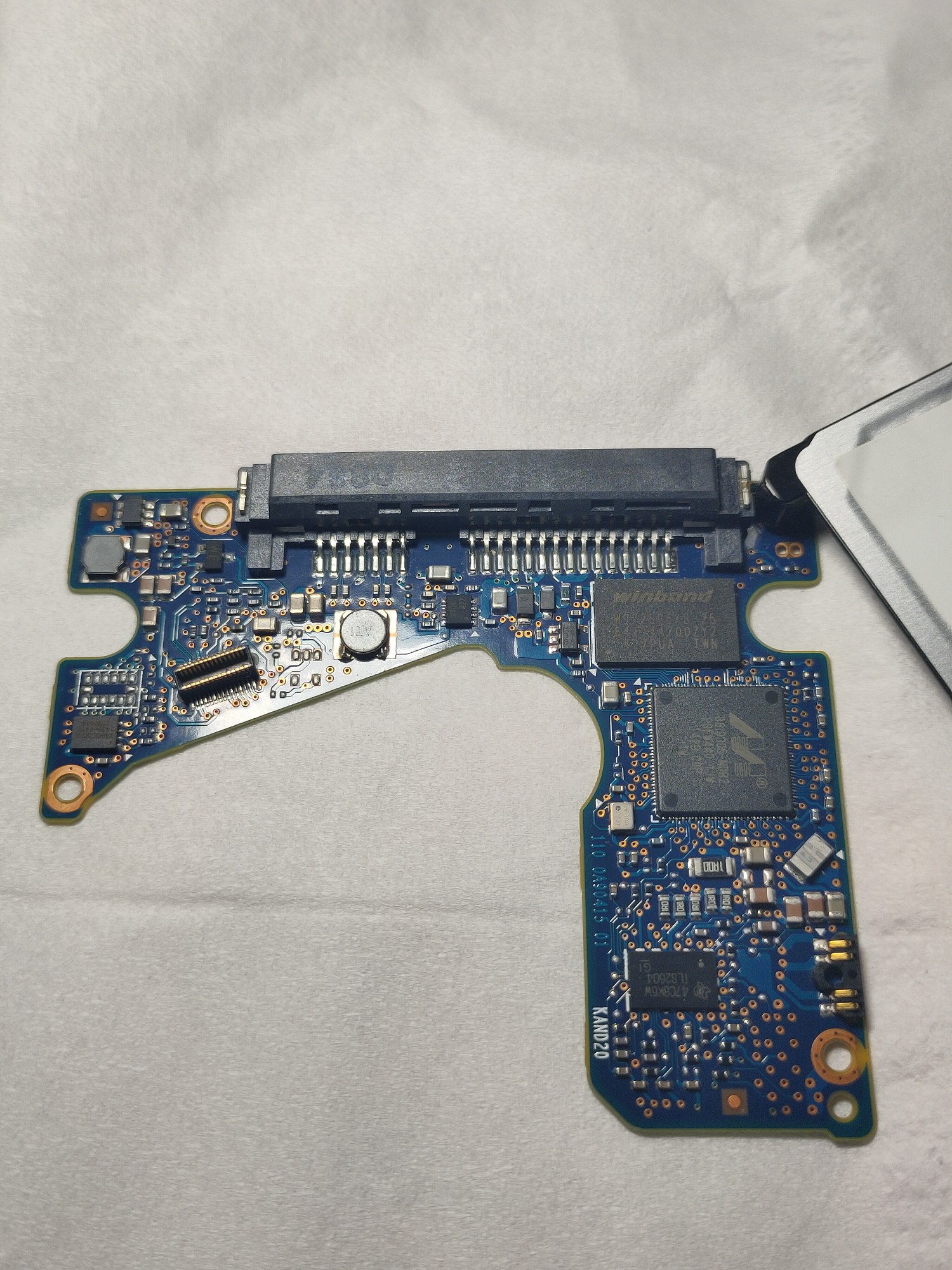

Hi guys, greetings. I have slim hitachi 2.5" 7mm 1 tb hdd with possibly burnt pcb, can help me identify which part that I need to remove/replace?
detailed model is: HTS541010A7E630
Background story:
I think I burnt my drive because my power supply give too much voltage. This is because I connect it to my modular psu with different cable vendor, my mistake.
the weird thing is smoke came out from sata data cable, yeah sata data cable not the power one. overall the physical condition of connector sata power and data doesn't show any sign of damage/burnt.
But the hard drive now is not spining even when I connect it to external hdd case.
Now I if I recall hdd comes with some protection that need to be removed for the hdd to work again.
I was thinking maybe I could remove that part to recover my data and possibly replace it if I can find the part somewhere.
pardon my bad english guys, as it is not my native language. Really appreciate if someone can help me. Thanks guys
File comment: Hitachi PCB

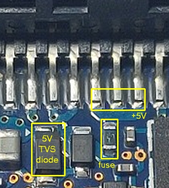

Check the fuse and TVS diode.
TVS Diode FAQ:

hi, sorry for late update, I was waiting for my multimeter to arrived.
As I checked, the diode turns out to be okay. But the fuse seems to be broken.
Can I just make this hdd working again by removing the fuse?

If the data is not critical, you might try bridging the fuse, but check the circuit side of the fuse to gnd against being shorted or low resistance first.
