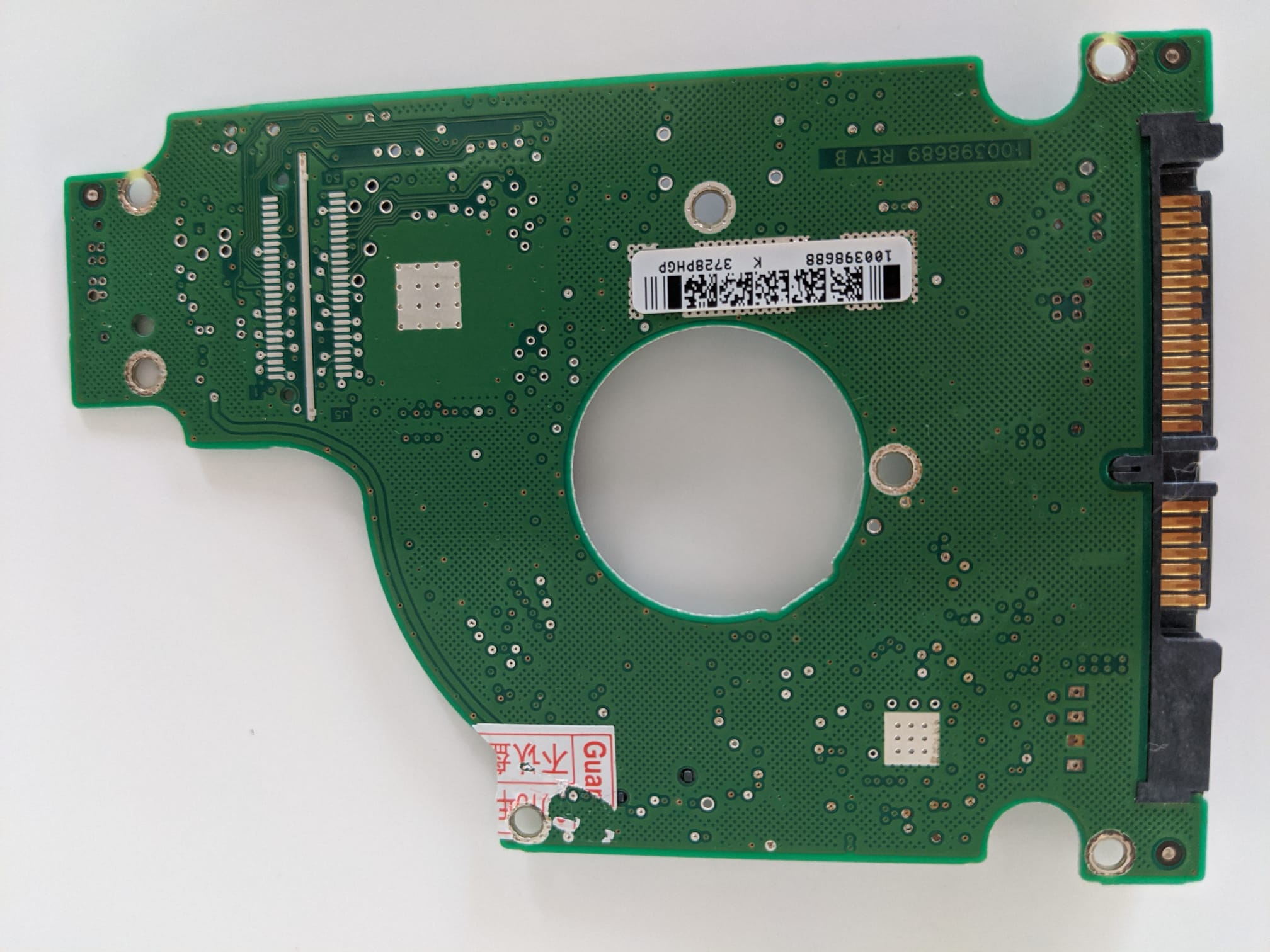

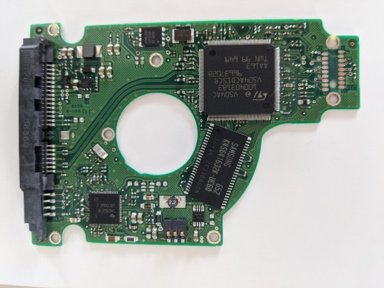

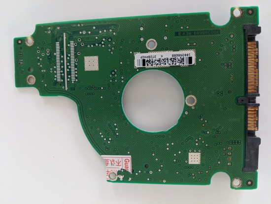

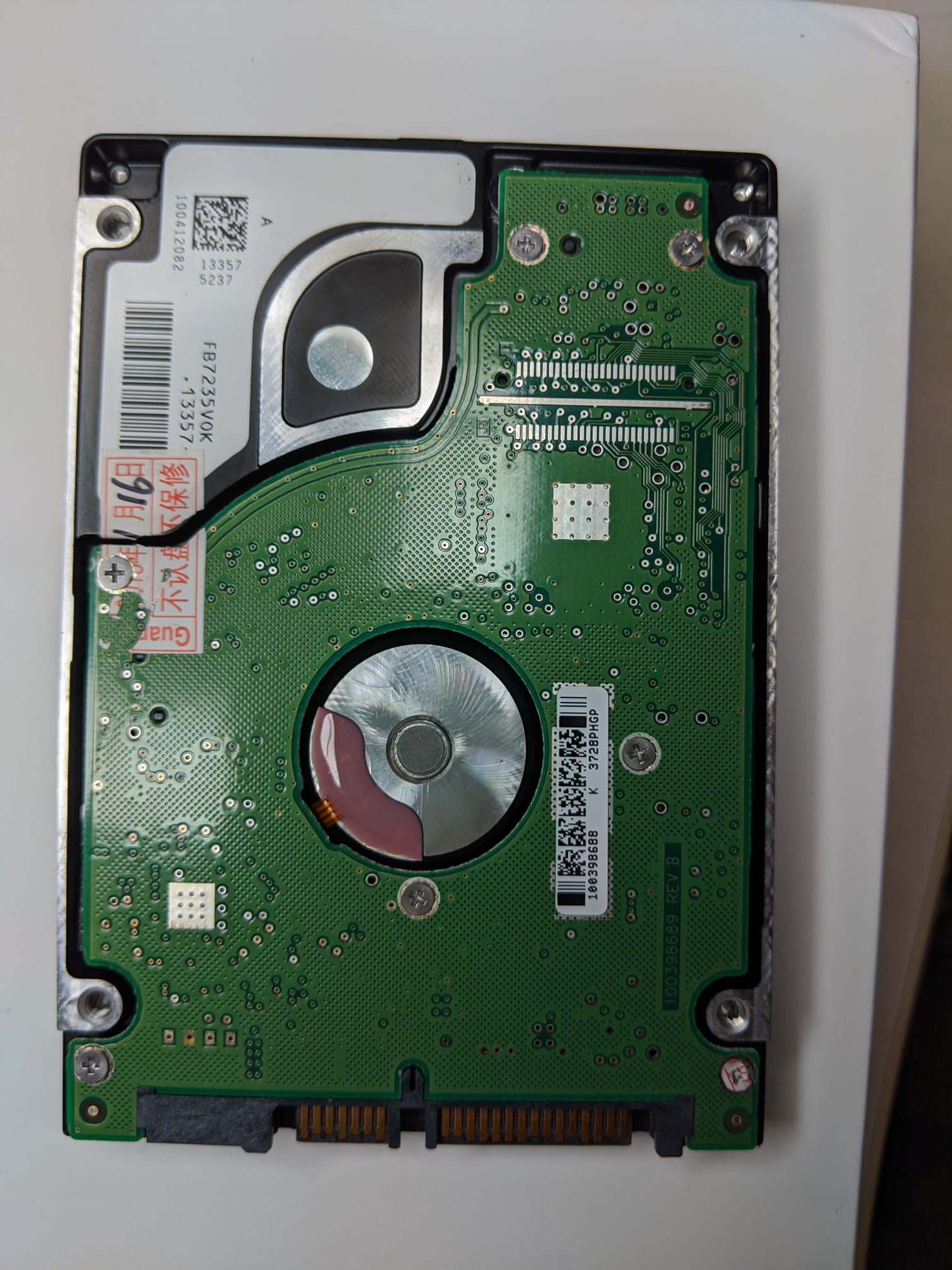

I got a Samsung ST1000LM024 when connected to PC3K, it show nothing on terminal. The motor spin, no bad noise but BSY DRD DWF DSC DRQ CRR IDX are solid green and all other are solid red.
It looks like PCB issue, I clean it with alcool, I don't see anything wrong.
Ïs there a typical chip I should check on Samsung PCB ?

The PCB in the photo is not from this disk
The PCB is from the Seagate 5400.3 drive

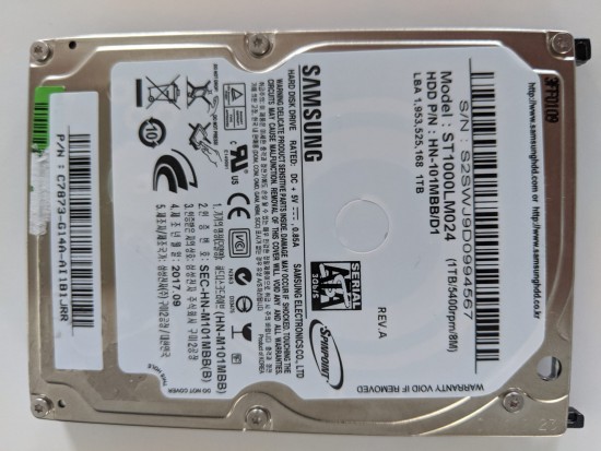

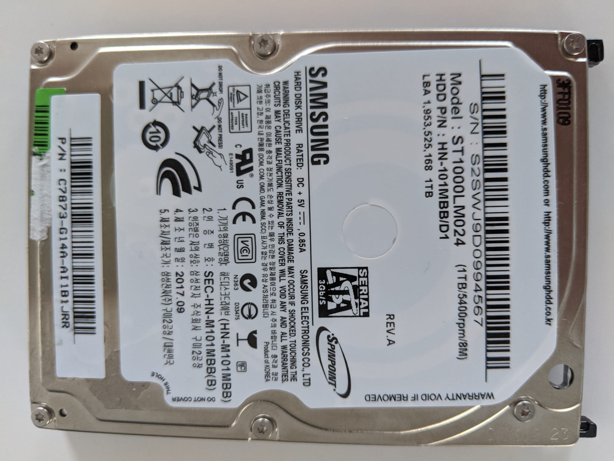

This PCB really looks like genuine on this disk, Model also looks like Seagate ST1000LM024. Is there a partnership between them ?

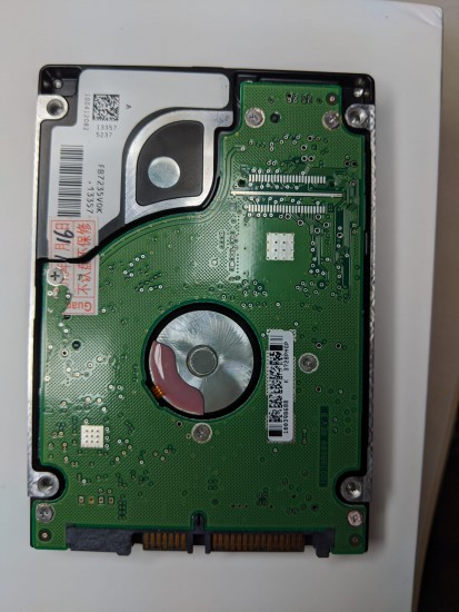

It's a fake. Look how the label is misaligned, plus you can see the old gum residue.

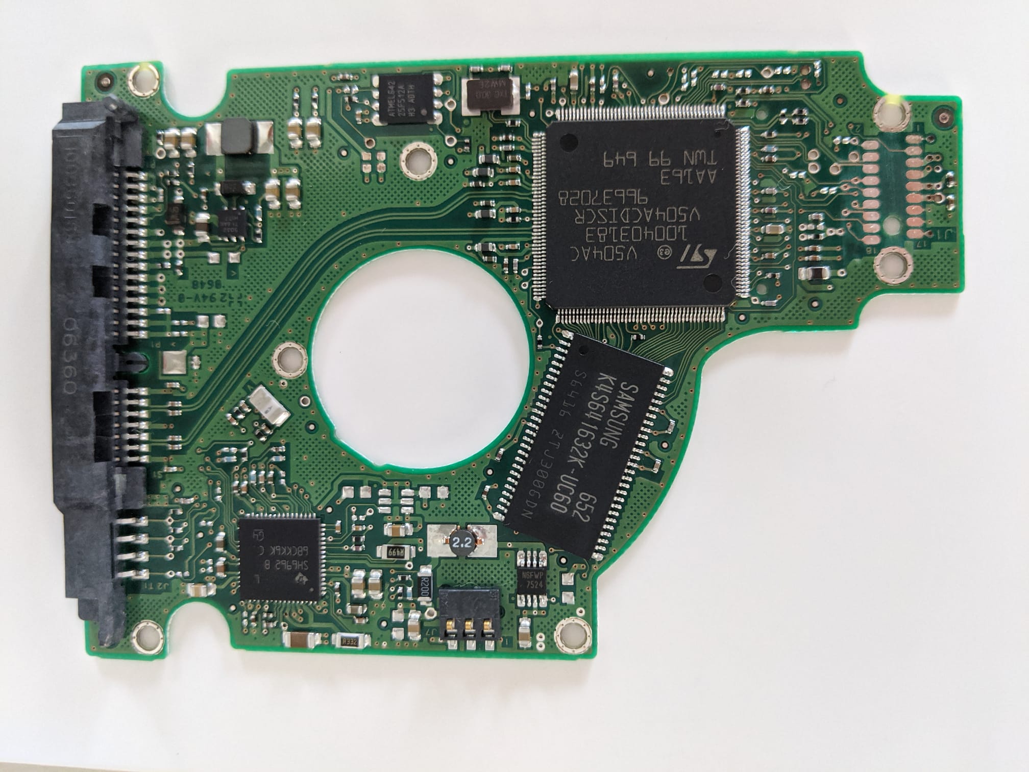

The manufacture date on the label is 2017.09. The date codes on the chips are 649 and 652. That's weeks 49 and 52 of 2016. That's a difference of 9 months.

definitely a fake. A really poor one. Look, there's a residue of an old sticker UNDER the P/N sticker :)
And some glue remnants as well.

It's a Seagate 5400.3. Use your Seagate tool.
I think that the date codes should be weeks 49 and 52 of 2006. That's a difference of 11 years.

Ok, so data recovered using Seagate tool. Capacity of 80 GB,The customer will not buy on Wish anymore. Thank you Mikippp, Fzabkar and Pepe for your answer.
