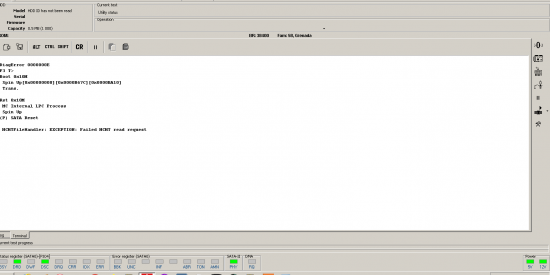

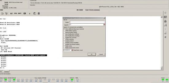

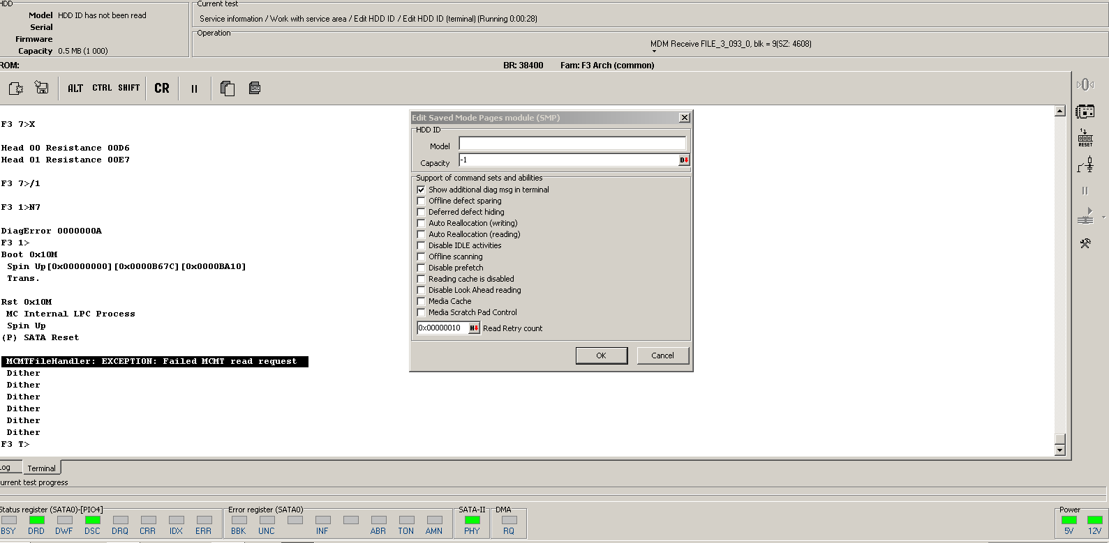

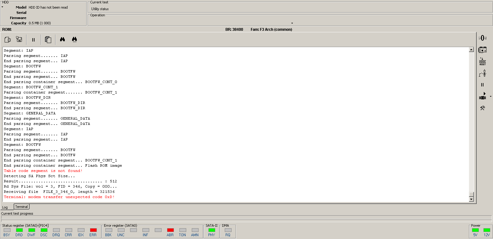

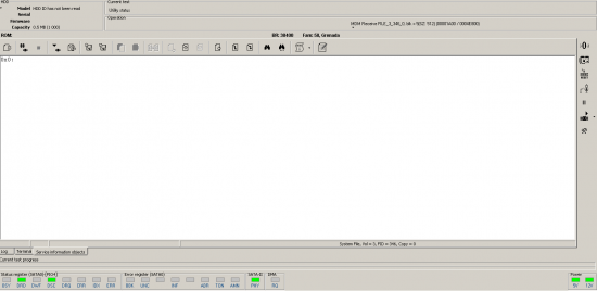

I am stuck up with Seagate Barracuda which is having MCMTFileHandler: EXCEPTION: Failed MCMT issue ( DWF register is red ) .

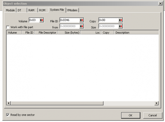

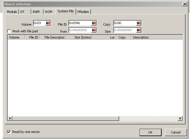

I have read that I have to replace system file 346 , Reset Media cache and disable it with congen.
So I am trying to read this file ,reading process starts but nothing comes up on screen (file is not getting read).
What I should do now
here is what exactly happening.

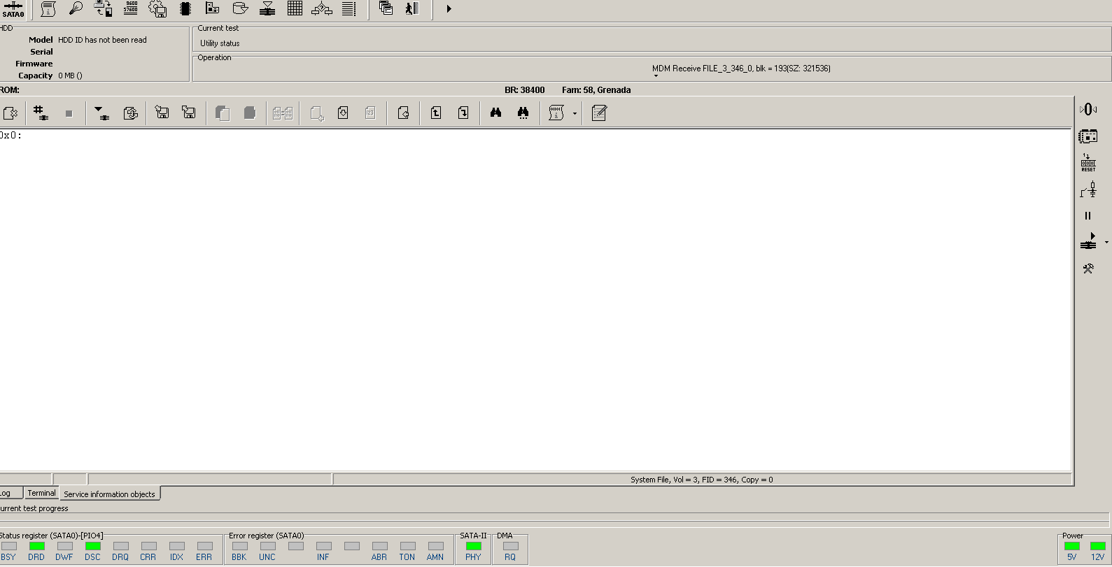

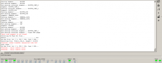

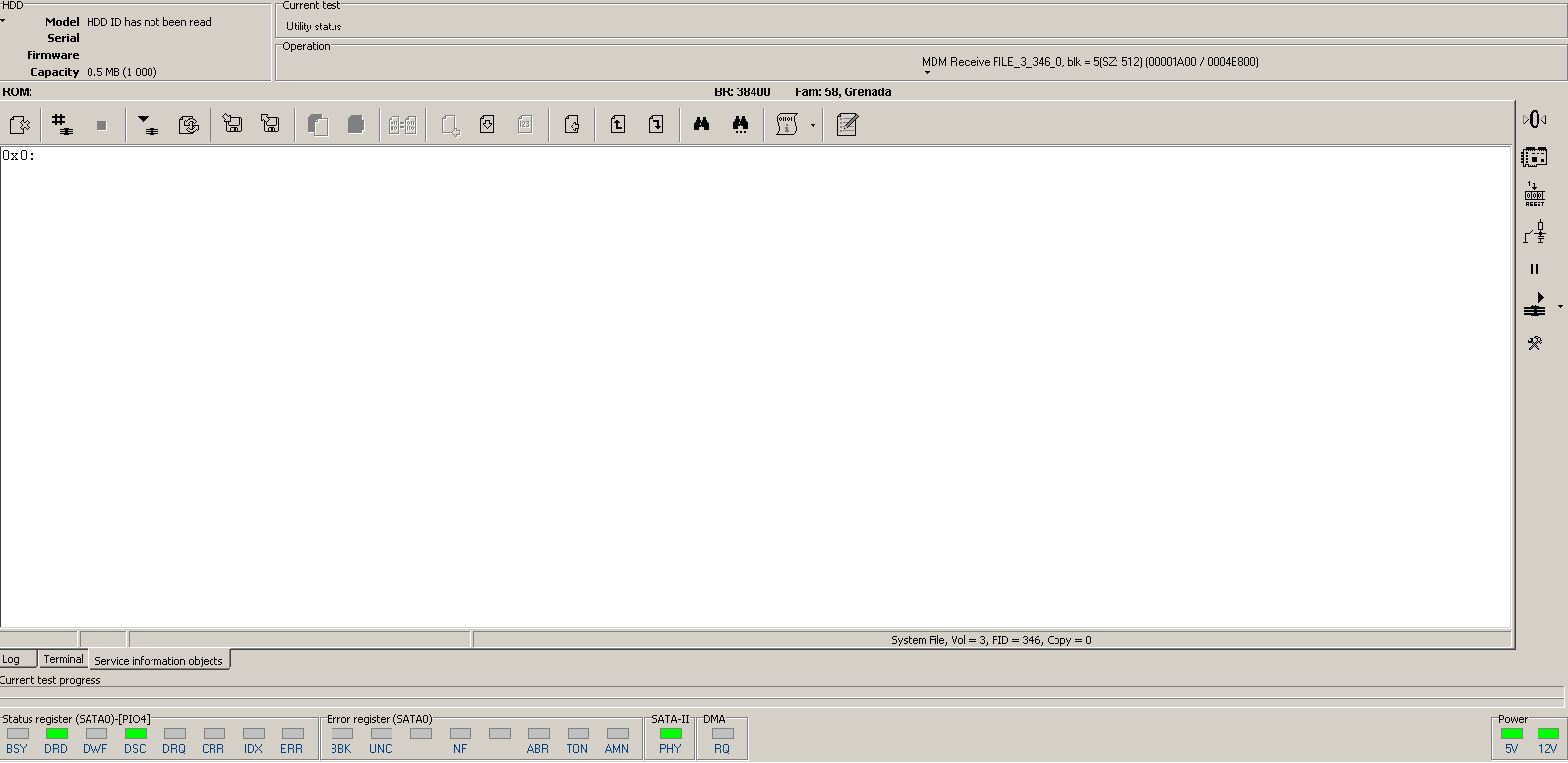

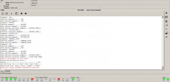

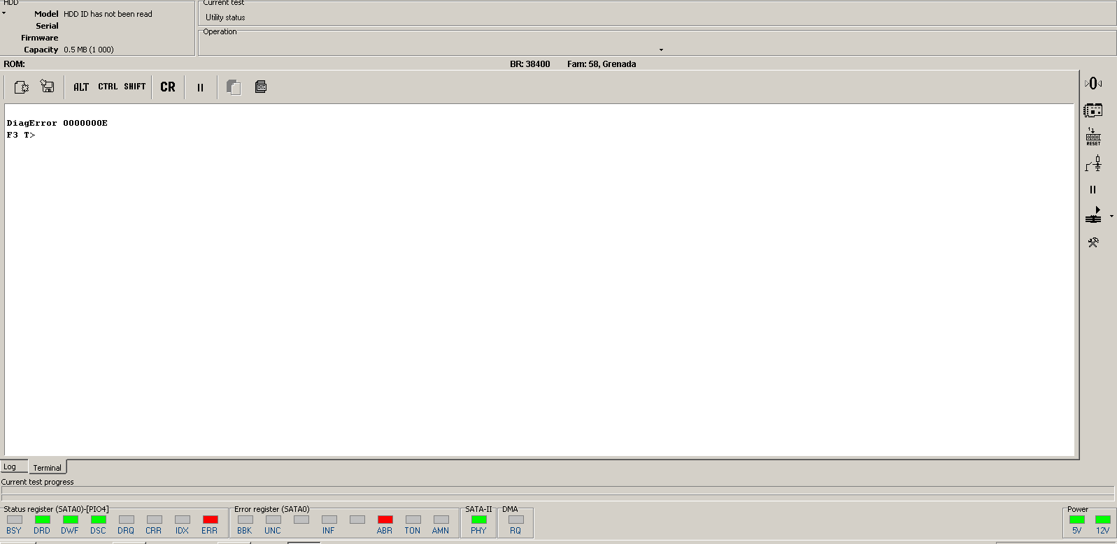

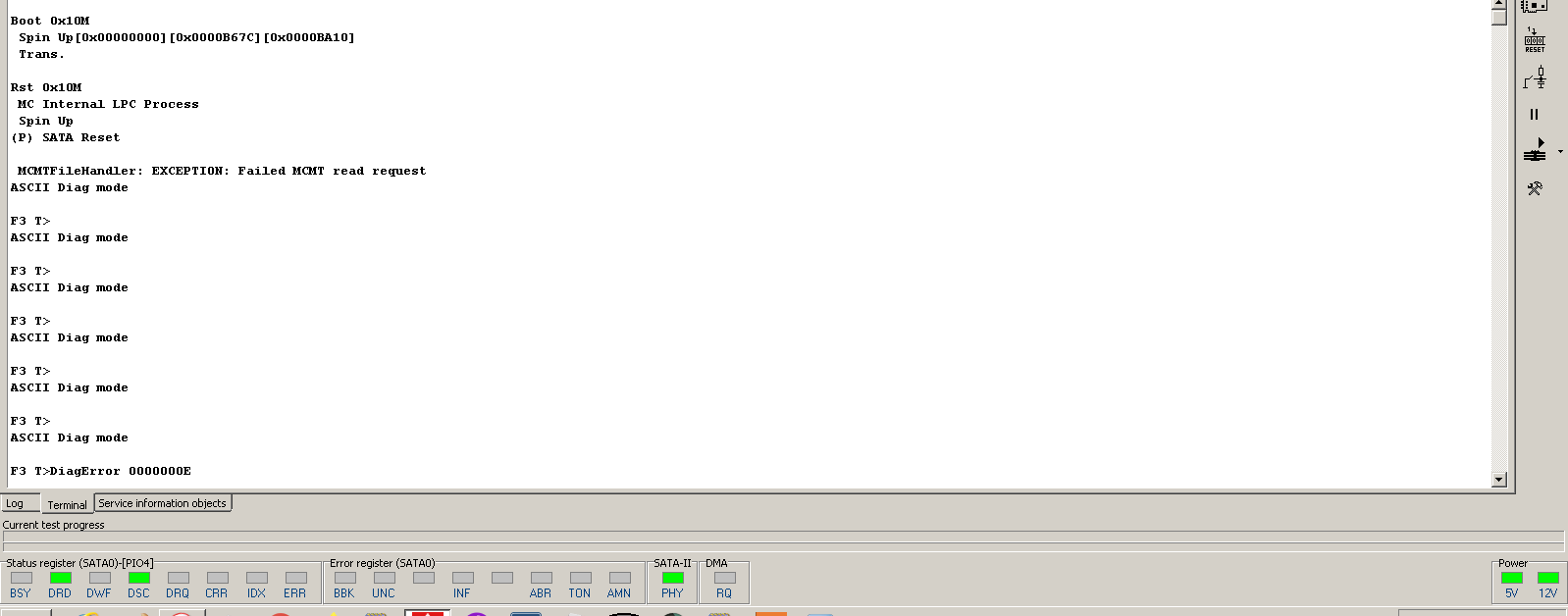

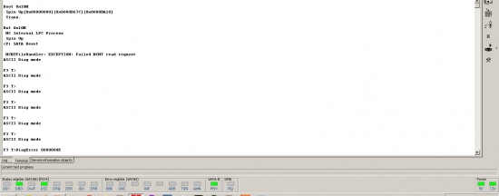

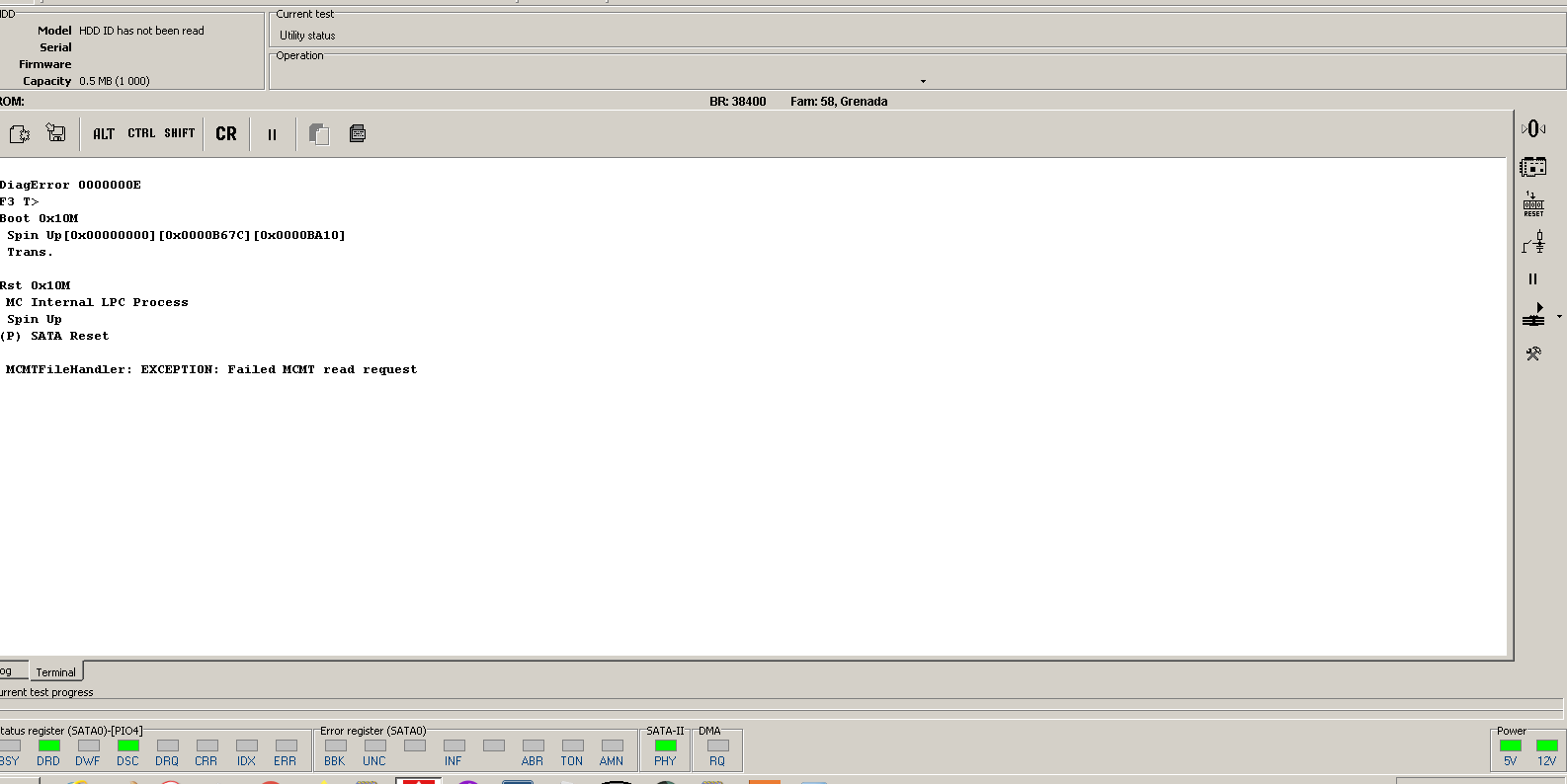

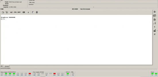

I am getting "DiagError 0000000E " in terminal. File reading process starts but nothing happens afterwards
Terminal shows ---
Segment: IAP
Parsing segment....... IAP
End parsing segment... IAP
Segment: BOOTFW
Parsing segment....... BOOTFW
End parsing segment... BOOTFW
End parsing container segment... BOOTFW_CONT_0
Segment: BOOTFW_CONT_1
Parsing container segment....... BOOTFW_CONT_1
Segment: BOOTFW_DIR
Parsing segment....... BOOTFW_DIR
End parsing segment... BOOTFW_DIR
Segment: GENERAL_DATA
Parsing segment....... GENERAL_DATA
End parsing segment... GENERAL_DATA
Segment: IAP
Segment: BOOTFW
End parsing container segment... BOOTFW_CONT_1
End parsing container segment... Flash ROM image
Table code segment is not found!
Detecting SA Phys Sct Size...
Result.................................. : 512

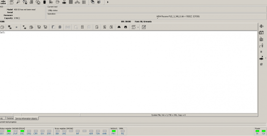

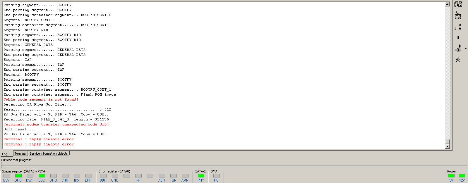

Rd Sys File: vol = 3, FID = 346, Copy = 000...
Receiving file FILE_3_346_0, length = 321536
Terminal: modem transfer unexpected code 0xD!

Its related to system file 346 , Just try to copy original file first. Else simply copy this file from any other same family disk and write it in hard disk & your hard disk will become ready . If disk has defects in SA then possibly I dont know the solutio.
