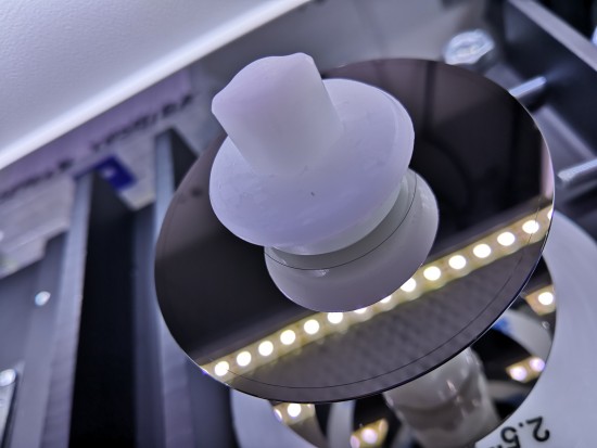

Is there any chance to turn off Head 0 in this drive? H0 layer is scratched like at attached photo.

@Jan: Sorry for not responding earlier. This is a complex process but doable in most of the cases. Physical access to the drive is needed, so you need to send it.
 Post subject: Re: Toshiba MQ01ABD100
PostPosted: September 29th, 2020, 9:49
Posts: 849
You just have to include in module DD the subzones corresponding to the scratch and to decrease MAXLBA in module 56 (recalculate the checksum).
PostPosted: September 29th, 2020, 12:48
Posts: 4790
i guess they need the data, so editing the translator is not quite an option...
PostPosted: September 29th, 2020, 22:31
Posts: 849
Do you think they could read the data from the scratch? And DD module is not exactly a translator.
PostPosted: September 30th, 2020, 7:47
Posts: 4790
no, of course not. DD is a very simple translator imo, at least on these.
