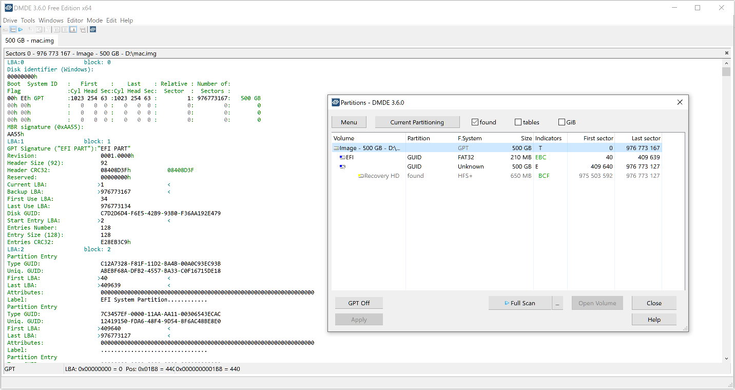

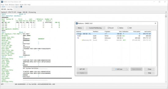

I opened the .img with DMDE successfully, so the .img is probably not corrupted, however it seems that this program cannot find APFS partitions
 Post subject: Re: Problem with HDD Raw Copy Tool creating corrupted .img f
PostPosted: October 5th, 2020, 18:36
Posts: 402
Location: Moscow
guix,
DMDE 3.7.1.779 Beta (2020-08-15)
N APFS support (without encryption)

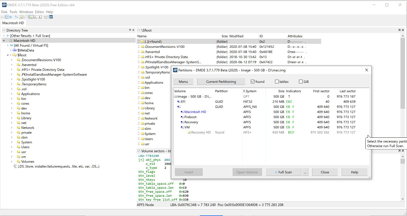

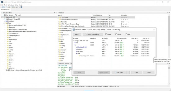

PostPosted: October 5th, 2020, 19:31
Joined: October 4th, 2020, 11:36
Location: France
Yes! With the latest beta, it worked... Thanks all ;)
SOLVED
