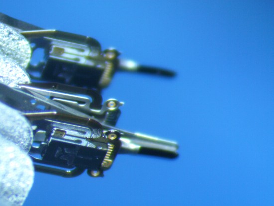

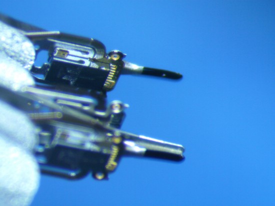

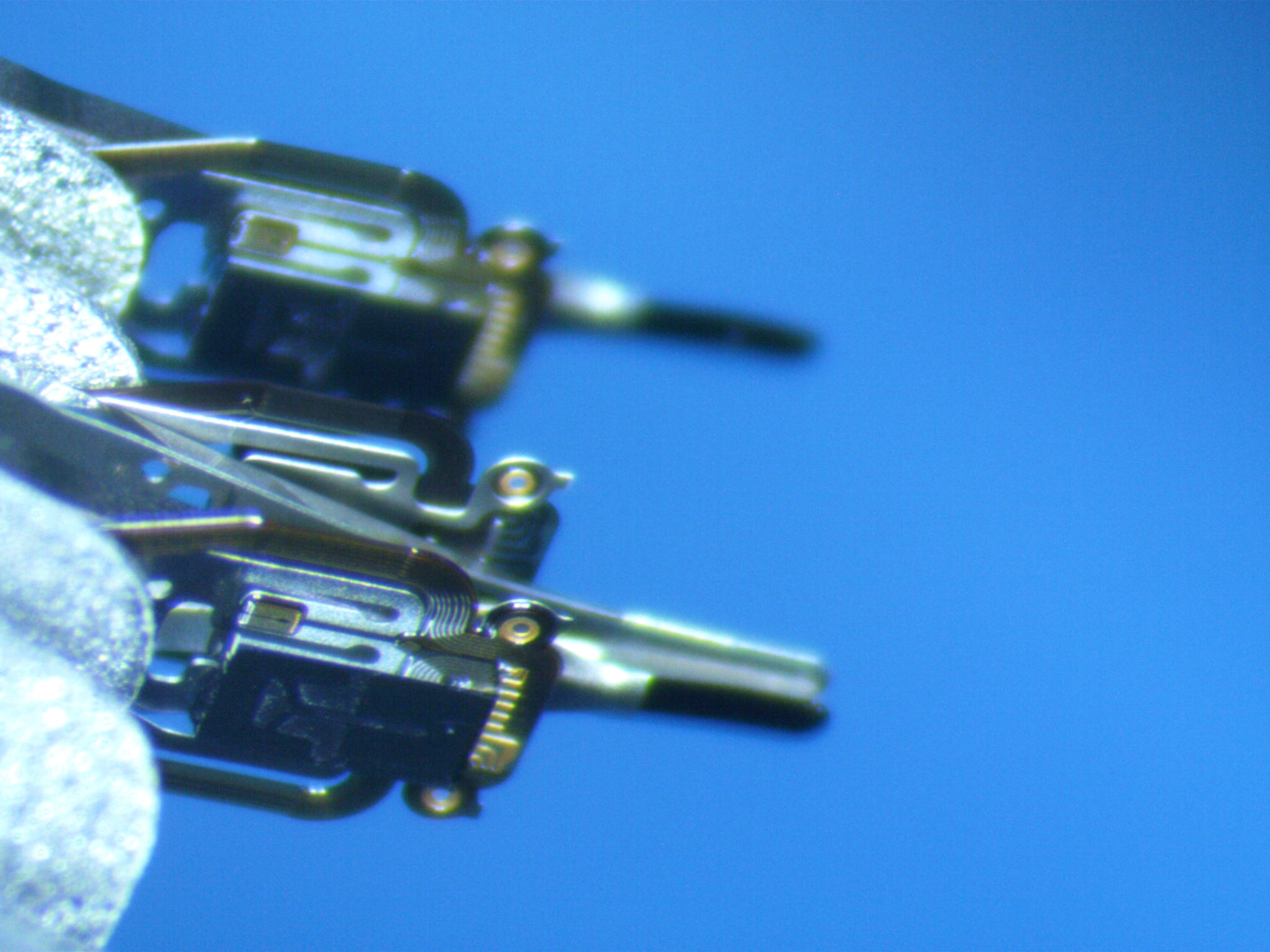

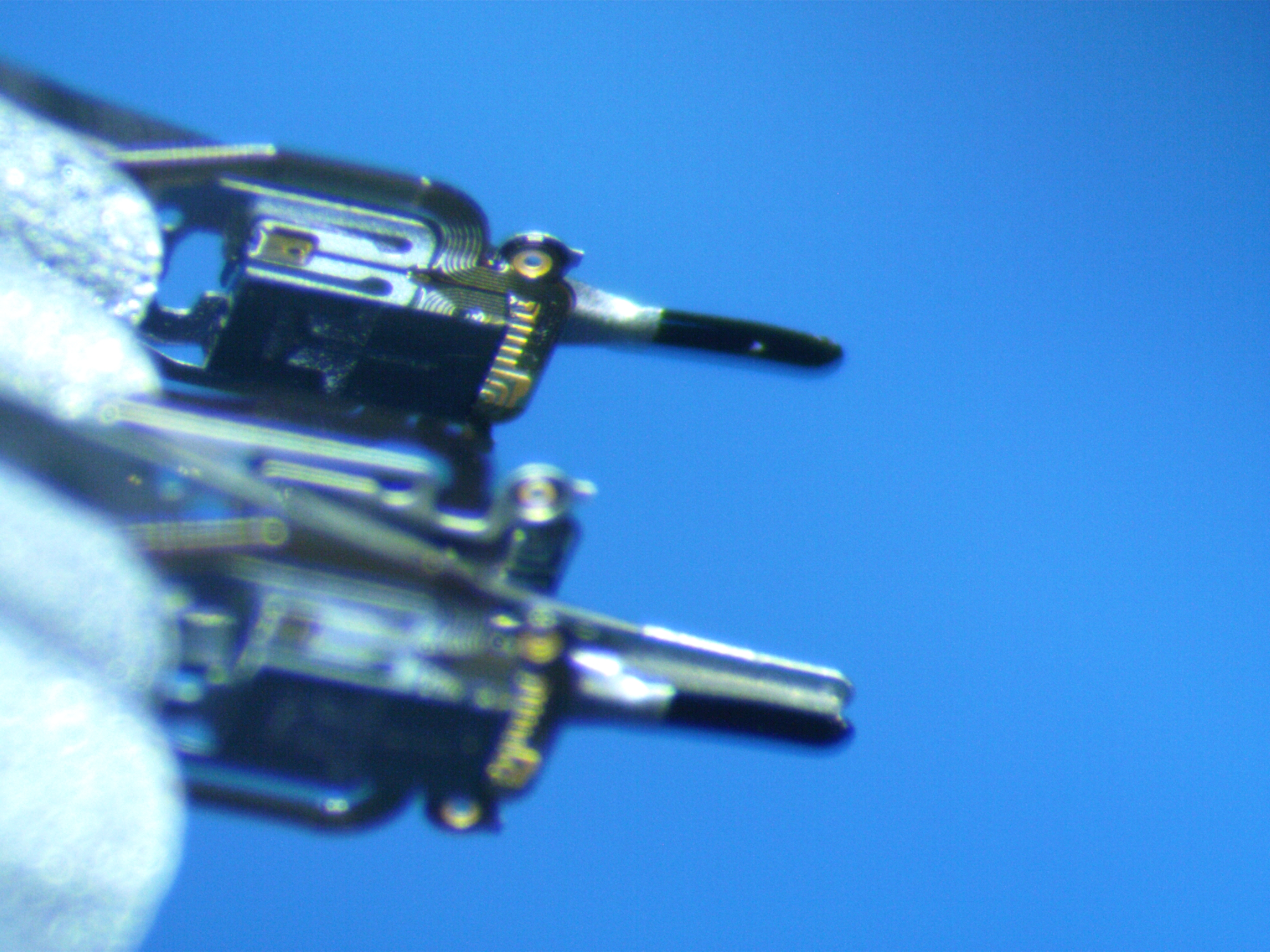

Spins up normally with no additional vibration, but the drive continually seeks.
Client said he dropped the drive but caught it before it hit the floor.
There are new heads in the drive.

The drive had significant media damage.
I guess it was so severe it was affecting the balance maybe.

...or the media damage cause that, the HSA can't reads proper servo signal.
