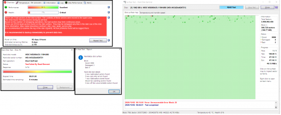

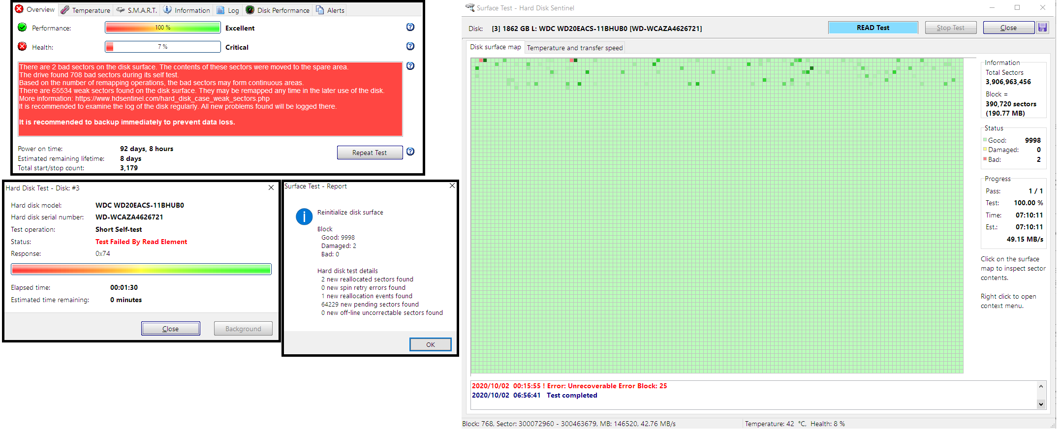

Hello Everyone, here's an update using HD Sentinel.
7% health! hah. This is bad.
I did a short self test. A Disk Read Test. Found 2 bad sector. (Not 708 on the warning page)
I tired to do a disk repair and everytime I do it the drive shut down and I have to plug-in, plug out the drive.
So finally I settled with a Reinitializing the Disk Surface. Then I left it empty until today.
Any comments/suggestions/insights with the information from the photo?
File comment: Performed on 2020.10.02
 Post subject: Re: 78 Bad Sectors
PostPosted: October 5th, 2020, 2:24
Posts: 849
The drive has a scratch on one of its surfaces. Can be repaired , but not by you.
