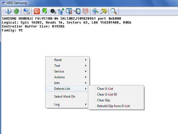

 Post subject: Re: How can I merge G-list of an old Samsung HM080JI Drive
PostPosted: October 7th, 2020, 17:58
Joined: December 18th, 2019, 6:21
Posts: 24
Where did you get it? Mine only shows clear
PostPosted: October 8th, 2020, 1:24
Posts: 849
I shouldn't bother answer you.
:roll: :roll: :roll:
PostPosted: October 8th, 2020, 3:38
Posts: 3551
A list = G list.
If you press clear G, it will put G(A) into S.
Presumably, at least.
PostPosted: October 8th, 2020, 16:54
Posts: 24
northwind wrote:
A list = G list.
Thanks.
I tried both "Clear G-list" and "Clear G-list 50" buttons. They do what they say, S-List wasn't changed.
