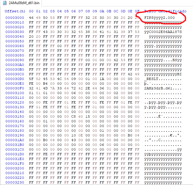

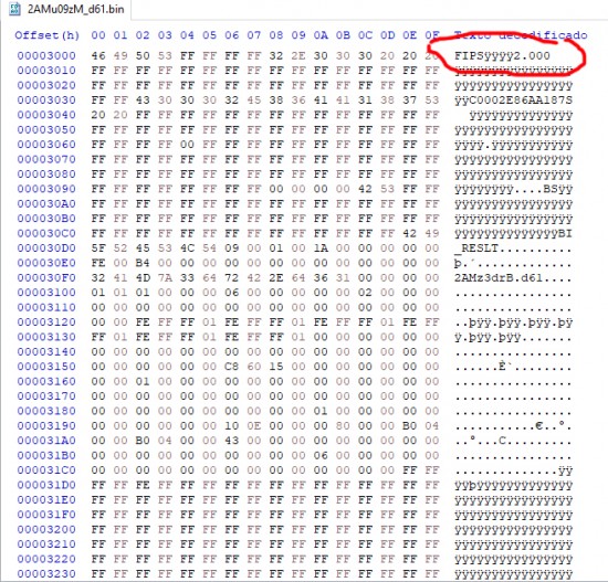

The disk belongs to the MT2 family and yes has a FIPS section in ROM
 Post subject: Re: SAMSUNG HM100UI ROM
PostPosted: June 3rd, 2020, 9:20
Posts: 291
Location: españa
Offset 0x3000 ROM HM100UI

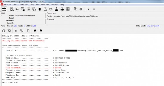

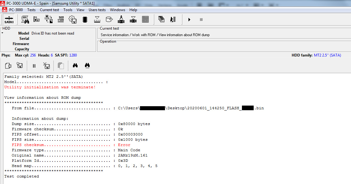

If you upload your ROM, I can verify its checksums for you.
Hello, fzabkar
Thank you very much for your help, as always, it is appreciated
The ROM if you have an error in the checksum of the FIPS module. It's empty.
Anyway I publish the ROM in case someone could patch it with a compatible FIPS section....., I don't have it and I can't find it.

There is a FIPS here:
http://files.hddguru.com/download/PC-3000-UDMA%20Support/SAMSUNG/MT2/CLOVER%20%20CM100UI-2AM10001-C509MT210TC2L112%202.rar
Your requested ROM is in the burn resources.
The actual size of the FIPS appears to be 0x800 bytes. The FIPS checksum is computed over this range and should be 0x0000.
Offsets 0x3800 - 0x3FFF are filled with 0xFF.
