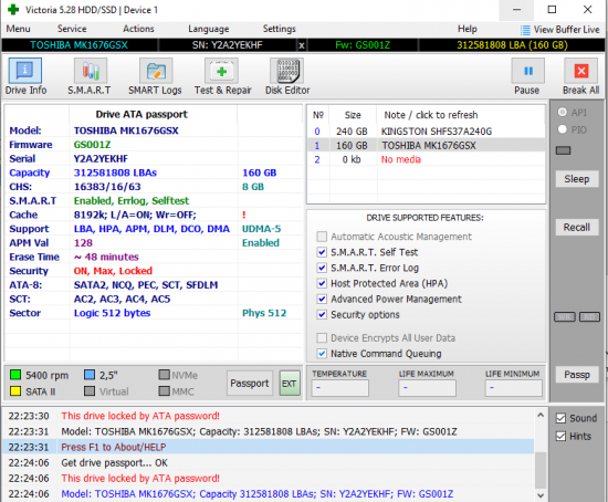

hello
i see the hdd but it take a long time du analyse
i have a scrennshot with victoria

psytgc wrote:
hello
https://www.youtube.com/watch?v=4-bU945-k1I
 Post subject: Re: Toshiba MQ01ABF32
PostPosted: October 24th, 2020, 5:16
Posts: 849
It takes less than a minute to unlock a Toshiba 2.5" drive.... if you know some VSC commands.
