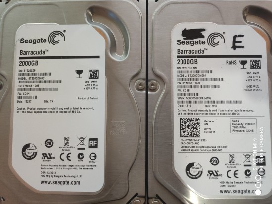

Let's call my HDD#1 and dono's HDD#2
First I just tried to swap PCBs. Then I started messing around with both ROMs.
HDD#1 + PCB#2 + ROM#2 spins but isn't getting detected by windows nor bios.
That makes me think that HDD#1 is mechanically fine, it spins normally.
HDD#1 + PCB#2 + ROM#1 doesn't spin.
HDD#2 + PCB#2 + ROM#1 doesn't spin.
That makes me think that ROM#1 is burnt. Is there any way to check if the ROM is dead?

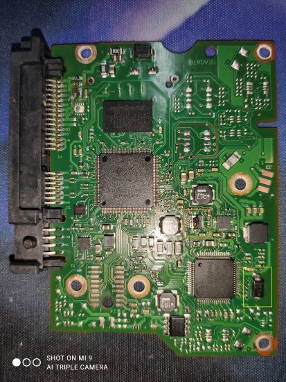

... and to finish the job, my dad and I tried to "repair" PCB#1 because I though ROM#1 and PCB#2 weren't compatible so fixing PCB#1 should work... and we ended up BURNING more components in it.
What could I do now?
TLDR; I have burnt ORIGINAL PCB and much likely the ROM got burnt too.

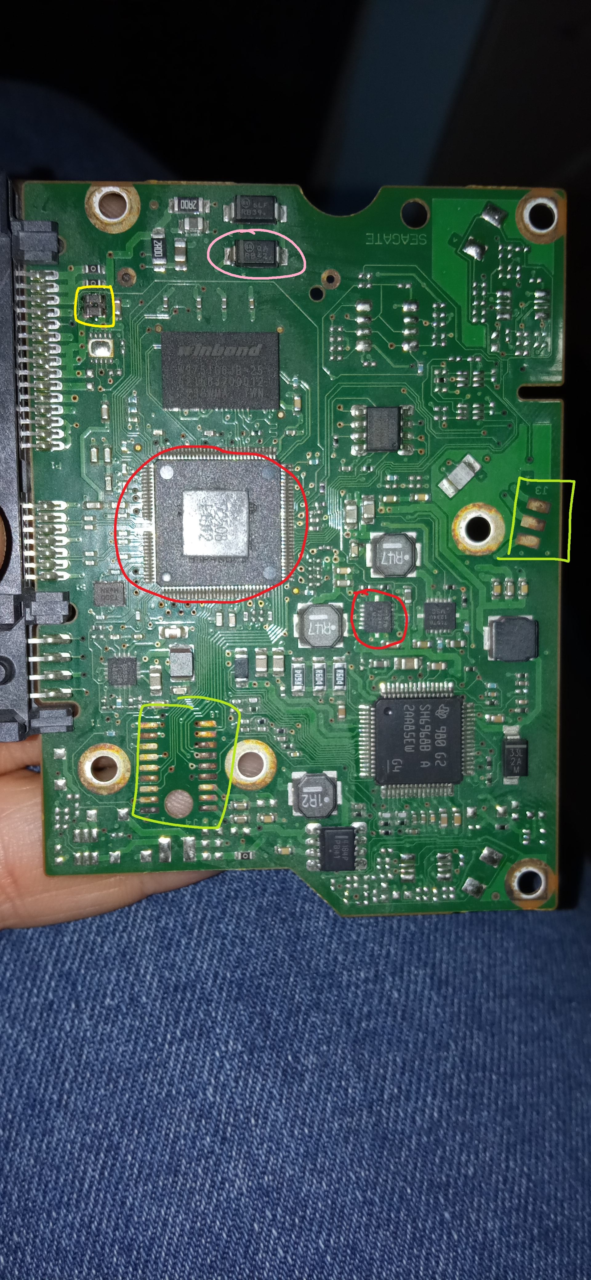

File comment: This is my PCB (PCB#1)
Yellow: Things that were burned after my computer was shut down. I cleaned connectors and added 2 new resistances.
Red: Things that were burned after trying to repair the other yellow things.
Pink: Shorted Diod.

The chip that failed is a DC-DC converter. If it provides power to the ROM, then it's possible that the ROM was damaged by it. You could confirm this possibility by testing for continuity between the inductor and pin #8 of the ROM.

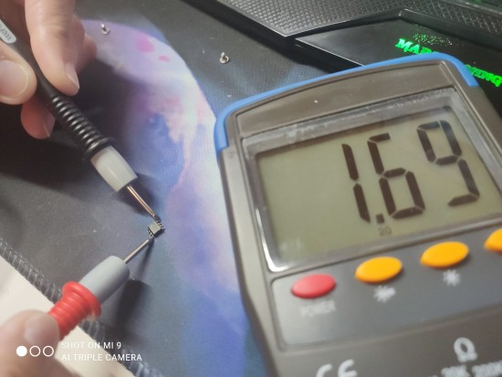

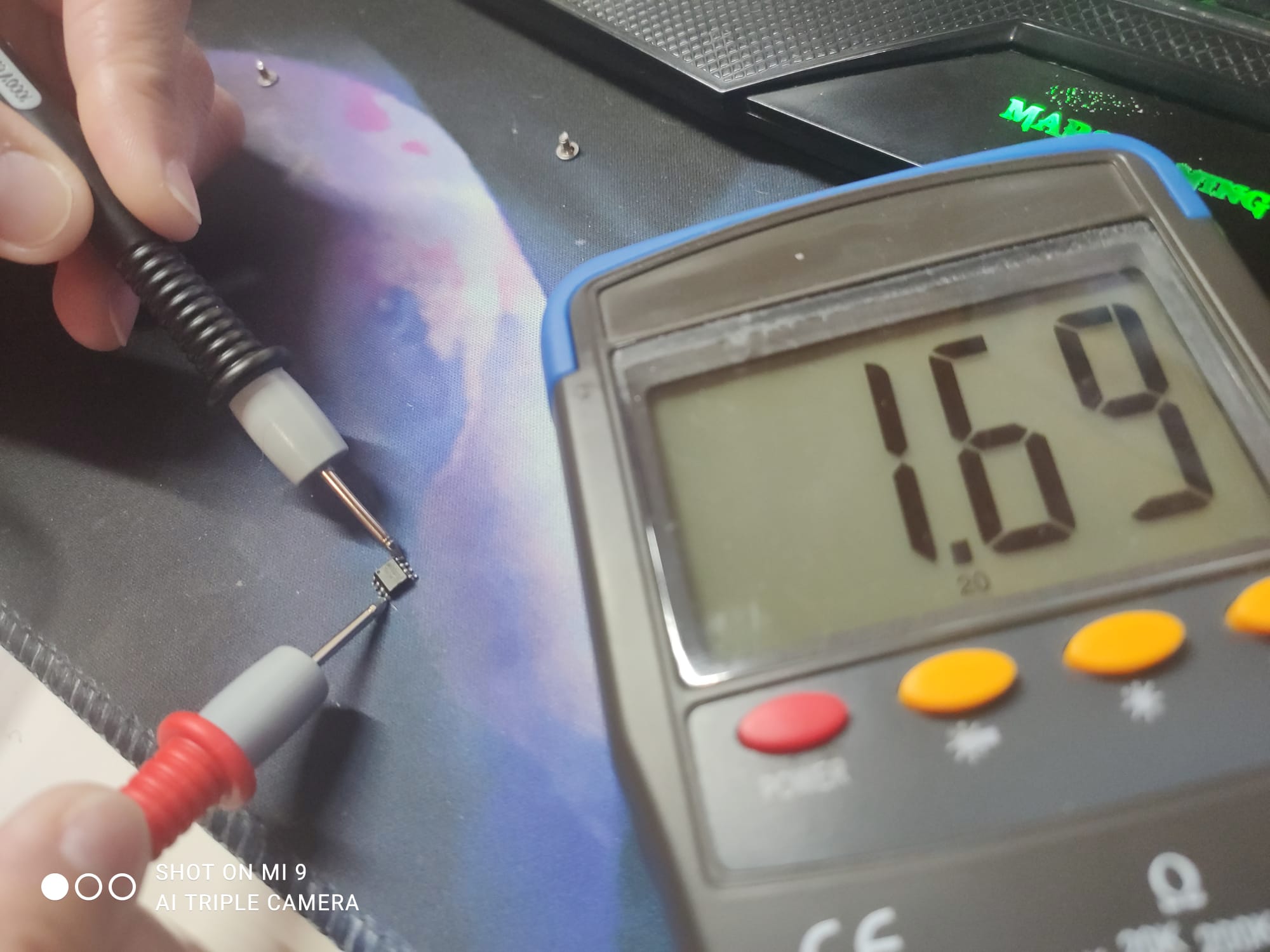

Hello fzabkar!
So I take the Milimeter and I do continuity test with inductor and pin #8... Where's the inductor? And after doing it... do I have to listen to a beep or not?

The inductor is the component on the left marked "R47". There is a similar inductor above, and an unmarked inductor at the right. Test all three -- one will be the Vcc for the ROM.
Also measure the resistance between pins 4 and 8 of the ROM.

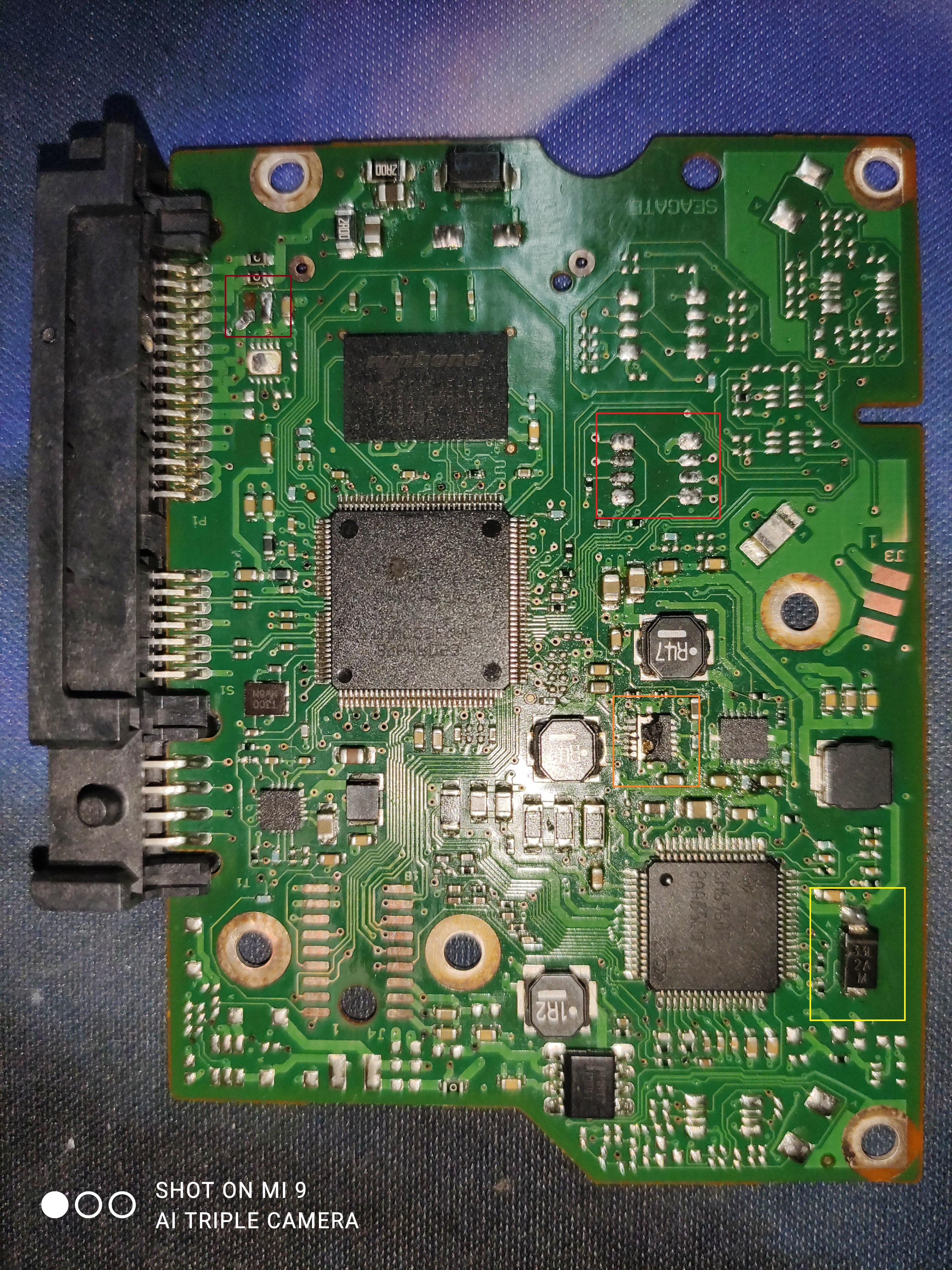

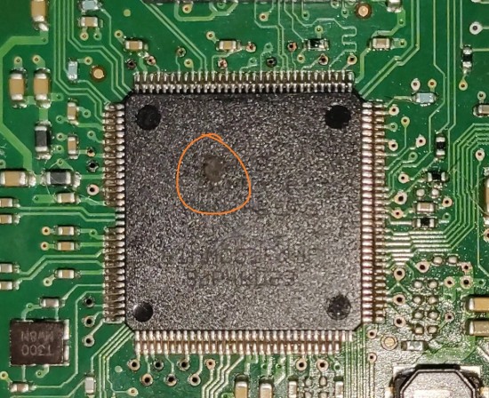

The actual state of PCB1 is horrible.
1 - It has no soldered ROM. (Guess I could resolder it if you think we can repair the whole PCB).
2 - It has no resistances on left side of the picture. They are removed because they were burned so I soldered the PCB2 resitances to this it (To PCB1) but then I resoldered again on PCB2.
3 - Diod on the top side is removed because it was shorted. The other on top is fine.
4 - There's another diod I guess? that is shorted too. (The one on the bottom right, marked in yellow)
5 - And don't ask about that broken component of the board (it was burned), so my dad though that was the responsible of all the mess so he tried to remove it. FYI, dad is not helping anymore. I fired him.
6 - MCU smoked so I think it was burned too!
That's why I would like to leave PCB1...
Anyway, if you think everything is repairable, I would like to try to do so!
(Do I need the ROM to be soldered to make the tests with Multimeter? Coz all tests were made without ROM soldered)
All three have conductivity with Pin#8.
Resistance between PIN4 and PIN8 is 9.80 in a scale of 20k Ω (I've no clue what these numbers mean so I'm just putting all piece of info).

Added some pictures

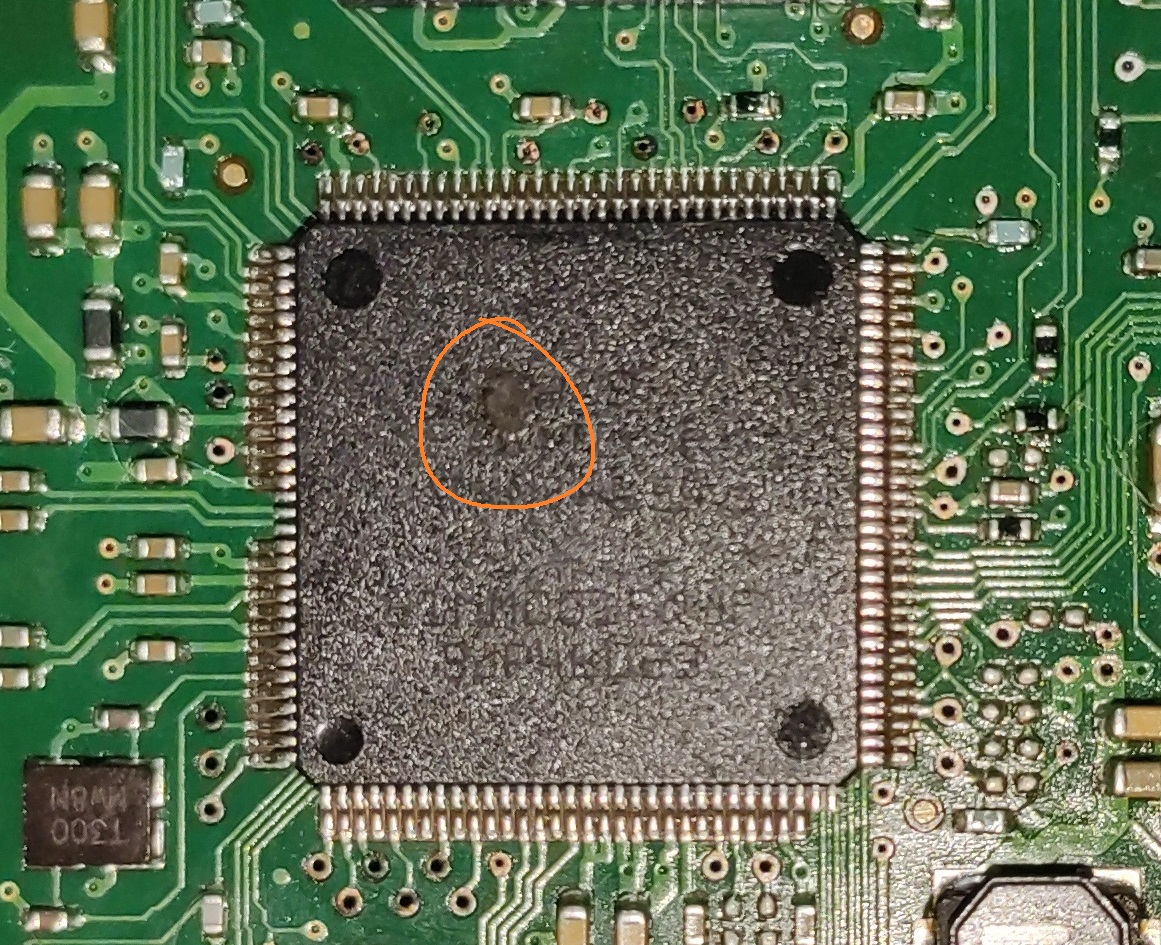

File comment: Oh and the MCU is BURNED, or at least it smoked and has some... plastic thingie on it's middle.

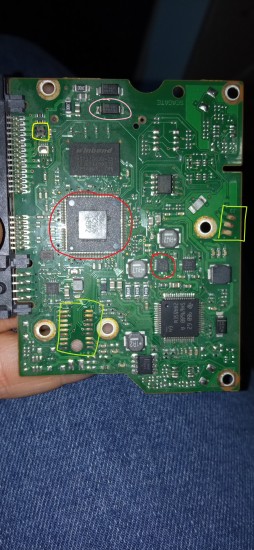

File comment: ACTUAL STATE OF PCB1
Don't ask about the broken Inductor, my dad's a genious, I'm still not sure what he tried to do there.
FYI, my dad's not helping anymore.

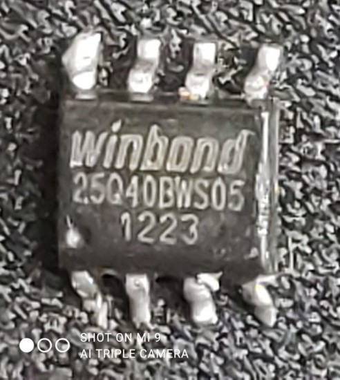

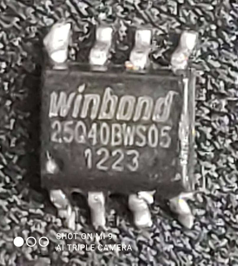

File comment: ROM1

If all three coils measure 0 ohms with respect to pin #8 of the ROM, then they must all be shorted to each other. This means that the damage is very extensive.
You now need to measure the resistance between the ROM's 4 and 8 pins. If this is 0, then the ROM is dead.

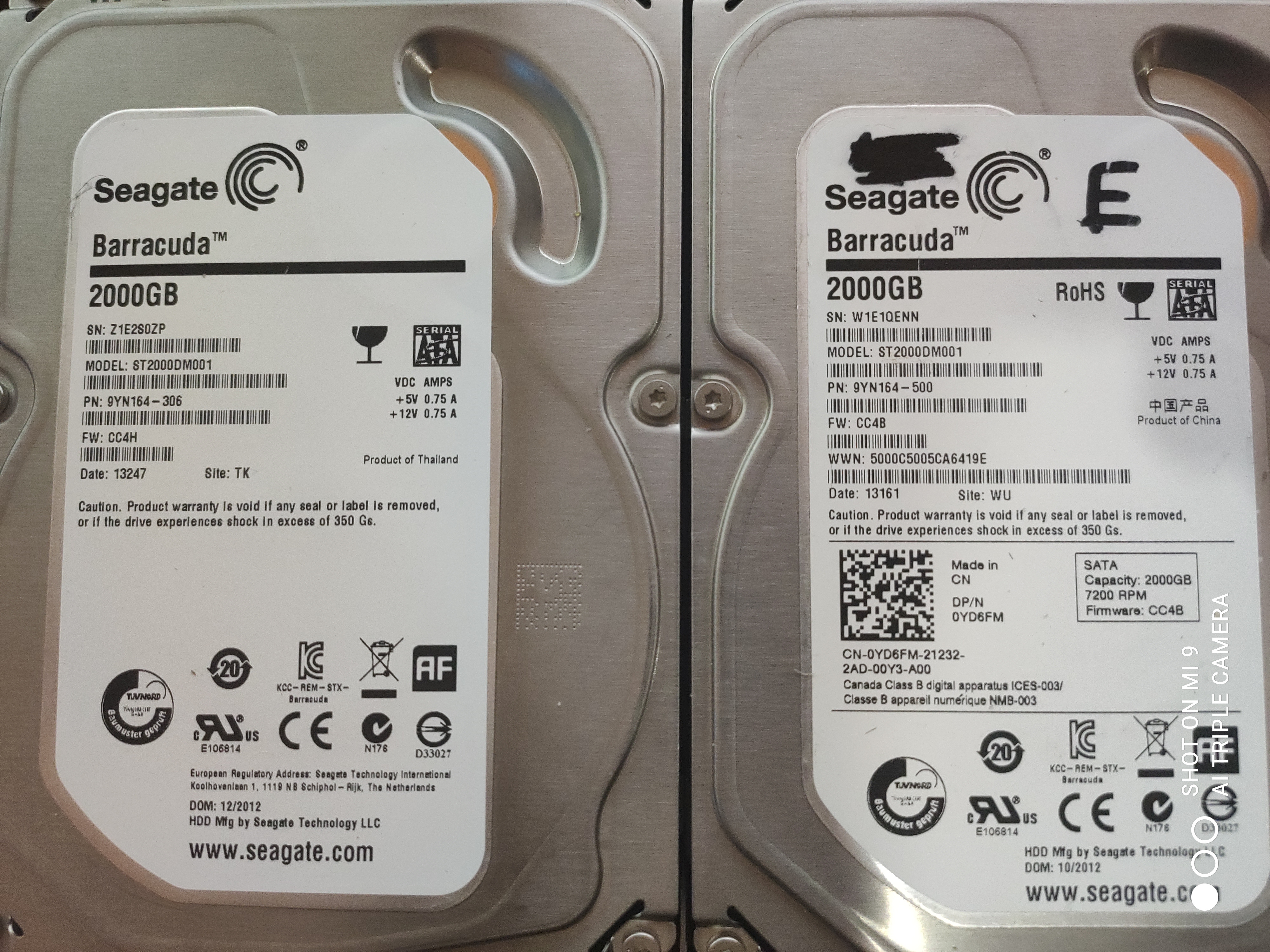

Can we try to use the PCB2 then?
I can measure the resistance without being soldered, right?
If yes, then, pic says all.
magnetepazzo wrote:
Hi friend, it's very easy, if winbond is of patient hdd you need to solder it on same new pcb and if you have good preamp your hdd work againd good
Donor PCB isn't Winbond, does it matter?
I tried patient ROM with donor PCB and it didn't work.
What's a preamp?

donor pcb need same part number, if you put patient rom on new pcb and not work you have another problem. preamp it's a chip on head inside the hdd. and if it's broken you heard a click when spin.
When you mean part number, you mean PCB model, right? Both are 100664987 REV B
Oh, and I tried that. There's no click when it spins.
I would read the ROM, if possible, making sure that you select the correct voltage. That will be 90% of the battle. Then upload the contents so that we can verify the checksums. It does appear that your ROM is dead, though.
I can help you to test the preamp, if you get this far.
Is it... really... dead? I'm losing hope! The other ROM measures almost the same numbers and it isn't dead.
I'll wait anyway for my goods to get home (New PCB and programmer, with adapter 1.8V!)
Thanks everyone for replying me, I realy appreciate what you doing to me.

Should be a identical PCB... at least same model 100664987 REV B. I've tried to solder ROM1 to PCB2 like five times.
I've tested PCB2+ROM1 with both HDD... no spin.
I've test PCB2+ROM2 with both HDD, both spin, but just one is detected by BIOS/Windows.
Guess... ROM1 is dead then.
Will try to read it anyway with programmer and adapter... :cry:

If you are lucky, the ROM may be corrupt rather than completely dead, in which case there is a chance that it could be rebuilt from firmware dumps. I don't hold out too much hope, though.
