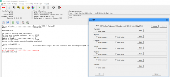

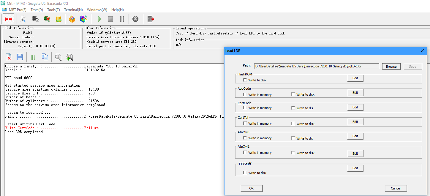

I Get its Loader and have this option in MRT, what would you suggest I use?

it won't help just uploading a loader. This dialog does not present anything in addition to ldr loading.

siamak5561 wrote:
pepe wrote:
I haven't ever used MRT, so i cannot tell if it has such option or how to access it.
Try asking their support or forum.
What the name of patch in PC3K? or what is do , so I can simulate that in MRT.
HI
I have access to both tools , PC3k and MRT, and I can tell you that only PC3k have that option in the Seagate U5 utility....No way you can simulate those steps in MRT.....The U5 utility in MRT is too simple and without any DR options to be used.
Rgds
