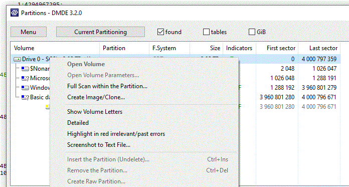

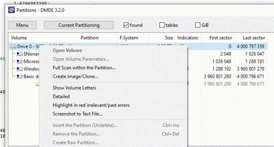

You are supposed to image the drive before running file system recovery software. Try cloning with ddrescue or hddsuperclone in Linux.
 Post subject: Re: Is this hard drive toast?
PostPosted: October 29th, 2020, 22:04
Posts: 3937
you can cancel the scan. Once the window is available, right click the drive (not the partition) and choose clone
But yes I agree with Luke that HDDSuperClone would be ideal for this
