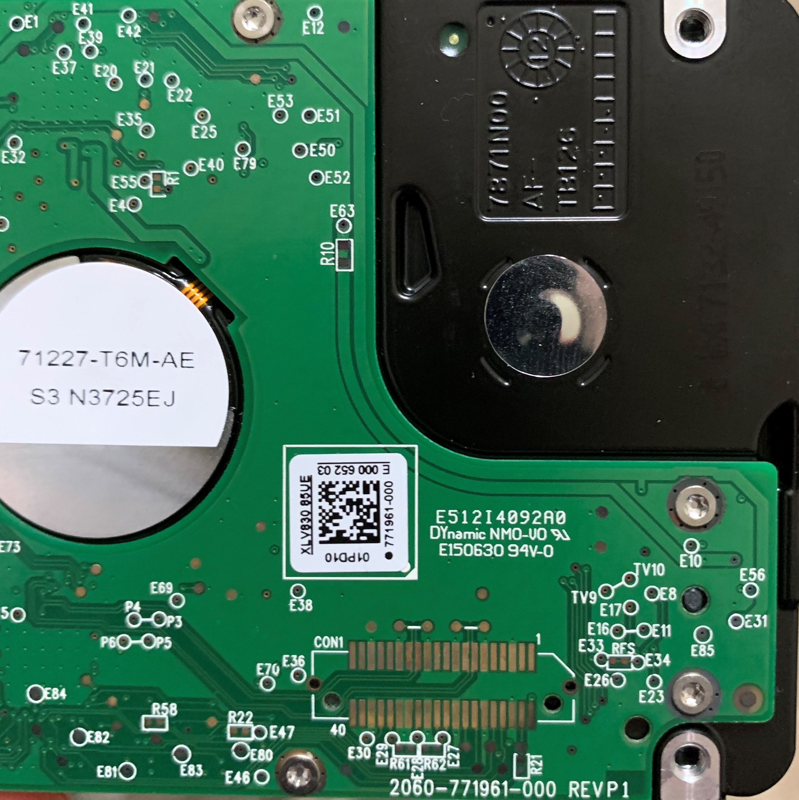

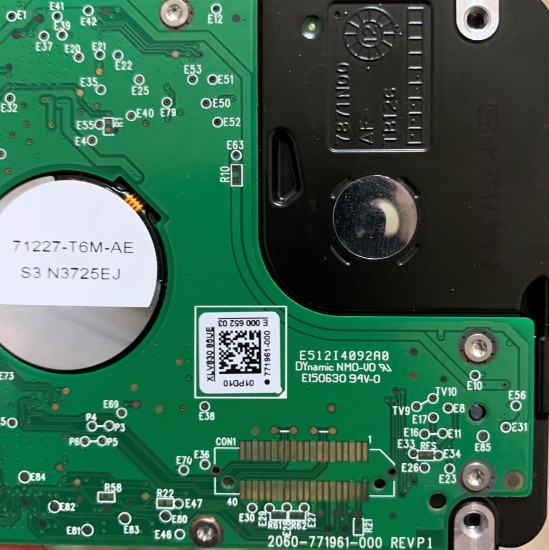

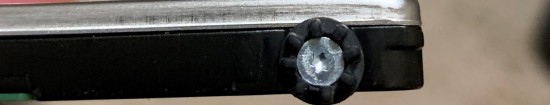

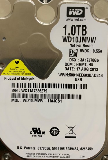

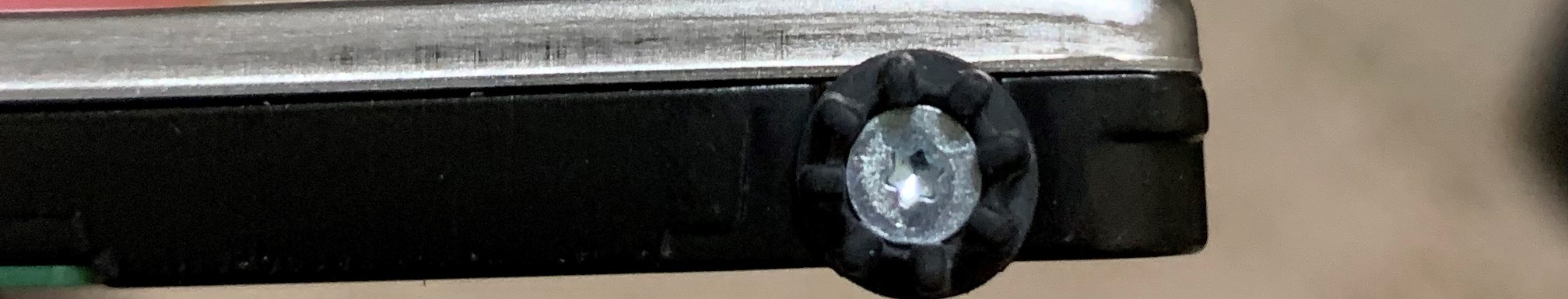

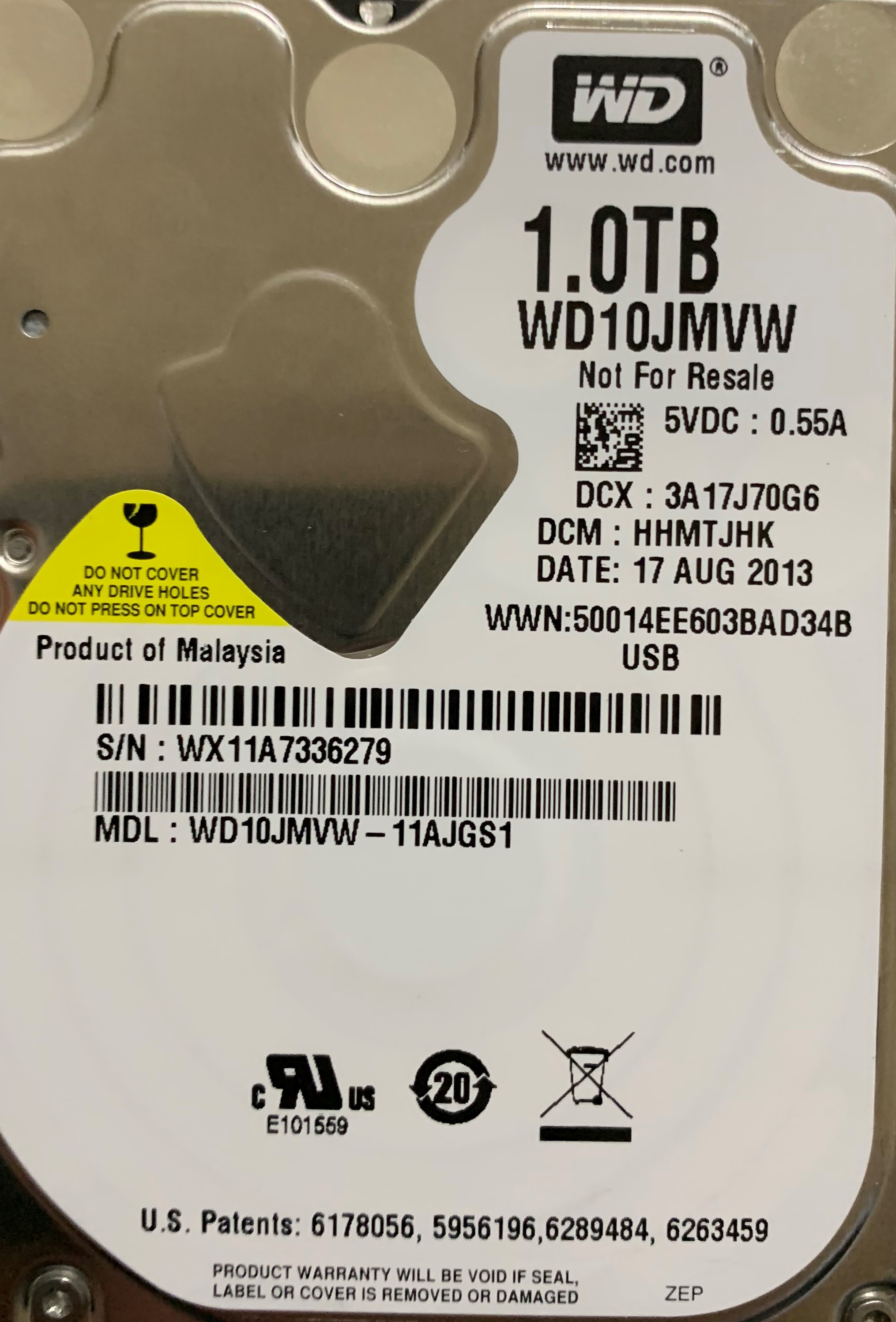

Hello, I have an older WD My Passport external drive that is no longer recognized by any machine. I have researched several forums but have been unable to determine if it's possible to remove the PCB and plug the drive into my Sabrent docking station to extract the data from the drive. Or, is my only option to replace the PCB? I'm fairly new to all this as I have several old laptops, drives, etc., and a new computer and I'm attempting to compile all of my historical data. I have uploaded pics of the external drive and appreciate any and all direction/suggestions/instructions on what is the best/most user friendly/and safest way to pull the data from this drive. Thanks!
Product Info
PCB Info
PCB Screw (should I buy a tool kit?)

You need to provide more information regarding the drive's behavior.
Does it spin up? If so, then replacing the PCB is useless, you'd be throwing away your money.
Does it produce clicking sounds? If yes, then it's definitely NOT a DIY case, you must consult a pro (if data is of any value). If not, then most likely drive's suffering from internal issues (most likely some problem with its SA).
This drive has USB port embedded to its PCB (which holds unique info), so plugging it to a docking station/SATA port is not feasible.
Firstly provide this info and then we'll guide you accordingly.
