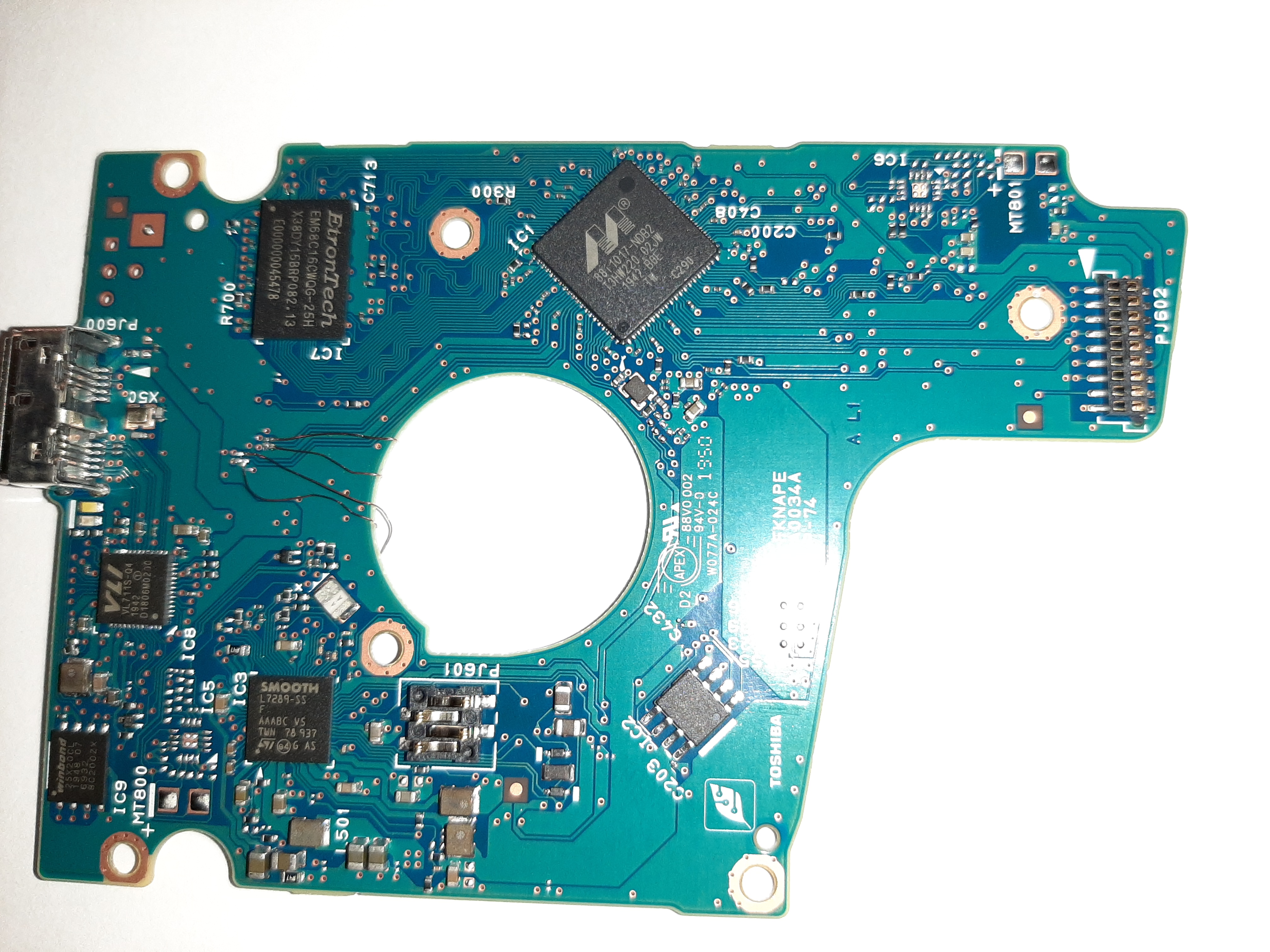

Hi everybody,
so this Toshiba MQ04UBB400 USB3 drive spins fine but is not recognized. I have converted it to SATA by soldering wires (and desoldering capasitors). The situation stays as same, spins fine and that's all.
I have measured the VLI with these results:
-Vcore +1,2V
-Vio +3,3V
- +5V
Resistance between core is 5,2 kOhms.
Any hints how to proceed?

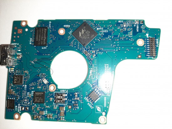

 Post subject: Re: Toshiba MQ04UBB400 (4TB USB 3) not detected but spins
PostPosted: December 3rd, 2020, 15:47
Joined: September 1st, 2007, 14:39
Posts: 101
Location: Finland
Sorry, this has dropped out of the original posting.
PostPosted: December 3rd, 2020, 15:52
Posts: 1773
Location: Phoenix, AZ USA
But what is the number on the back of the board.
PostPosted: December 3rd, 2020, 15:57
Posts: 101
Location: Finland
There is only this little stiker with QR code and marking 01C0. Reading the QR code I get EF602A49H A5A900034010 if this is even valid infomation.
PostPosted: December 3rd, 2020, 16:02
Posts: 1773
Is there not a number in gold under the spindle hole like G4330A.
PostPosted: December 3rd, 2020, 16:06
Posts: 101
Location: Finland
My apologies. :oops:
Of course the is: G0034A
PostPosted: December 3rd, 2020, 16:11
Posts: 1773
SATA PCB G4311A should be a good match. At least you can rule out the PCB.
PostPosted: December 3rd, 2020, 16:16
Posts: 101
Location: Finland
Great! Thank you a lot! :good:
