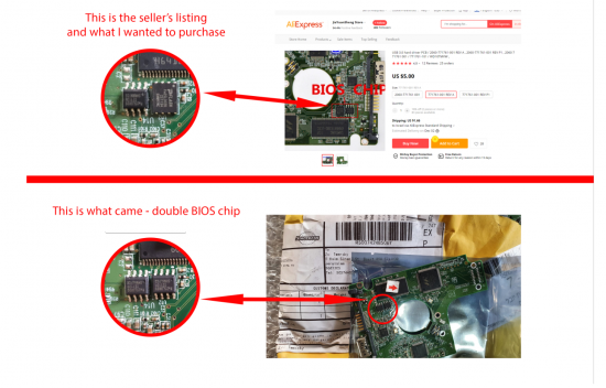

I have a WD 2.5" HDD that for no reason suddenly stopped being seen by Windows or Ubunto. Drive did not fall and does not make any strange sounds or clicks. Turns on fine, the spin sound sounds normal (no stuck head). When connecting to USB, PC will make the default sound you hear when you connect a device but it is not seen in any manager or data restore software, not as RAW, not as "undefined," nothing. So there is nothing to "scan."
Since it doesn't seem to be anything mechanical, I am going to try a PCB swap.
I'm going to try to use the USB connection before I might try to bypass the USB with a SATA connection.
As you can see in the attached screenshot, my PCB has two chips next to each other; one is the BIOS and one is a FLASH controller.
I found an identical model on Aliexpress and ordered it. Problem is, the one that came has two BIOS chips instead of one BIOS and one FLASH.
My question is, do you think it's enough to just swap the BIOS chip without touching the FLASH chip? Or do I have to order a different PCB that has both the BIOS and the FLASH chip so I can swap both?
Thanks!

Your PCB is fine.
Most probably your drive is suffering from "Slow Responding" problem, NOT related to your PCB.

1: your problem is likely not related to pcb.
2: that pcb is just fine, although it has different serial flash on it. (only the package is different).
the SFL on the left (U14) is for the bridge IC, and the one on the right (U12) is for the drive MCU (so called ROM chip you need to move to the donor pcb in case of a pcb replacement).
IMO your drive probably has bad sectors or weak head plus a background process running which prevents it from being detected by the USB bridge and consequently the PC.

After reading what northwind and pepe wrote, would it be correct to say that if it's not a PCB issue, that I can just convert the USB to SATA without swapping anything from another PCB? Also, is it possible that just by converting to SATA that it would be able to read it? Or will it still be necessary to access the service area and do modifications to the firmware (like a patch) to let the drive work again? I'm asking because as far as I know, one would need software to do this such as PC-3000, which I don't own. (I also don't know if the drive is encrypted. It's a passport, which I read is usually encrypted, unlike elements, which is usually not encrypted.)

No, it is not a PCB issue. Swapping to SATA only compounds the issues if you aren't equipped to deal with weak heads, firmware, bad sectors, encryption and possible file system damage.
The problem is, right now, we can't be sure to what extent the damage is.
