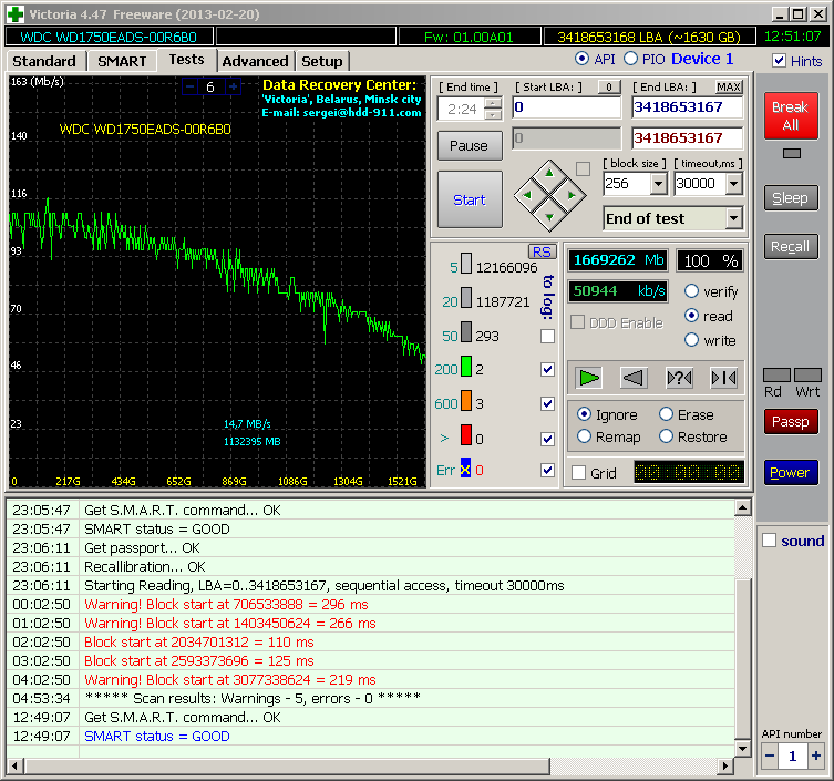

Hello, Im looking to know if my drive is really at his max capacity, or if I can gain those "missing" 250GB.
Drive is WD20EADS-00R6B0 with 8 heads, 4 platters, capacity 2TB.
The head 5 was failing, and was automatically depoped during a selfscan.
I'm ok with the depop, I was going to do it if the selfscan will not repair it.
But now, the drive is identified as WD15EADS with 1.5TB.
It seems using 7 heads, but the capacity is now like with 6 heads.
The model list module 0C does not shown any WD175, and is reporting 2930277168 LBA for 6 and 7 heads.
So is it possible to manually re-adjust the capacity to obtain 1.75TB? or I'm facing a wall?
Have tried to change the max LBA to 3418653168 with the WDMarvel option, but it give me error...
Very thanks for your help!

To be honest i never ran selfscan on these, but i think it adjusted itself to the nearest factory defined capacity, which is 1.5TB. I'm afraid this is not achieved just by lowering MaxLba but setting lower SPT on zones as well. At least that's what i saw on refurb drives. So increasing the capacity probably cannot be done just by changing MaxLba.
 Post subject: Re: Get the right drive capacity after depop
PostPosted: October 24th, 2020, 5:09
Posts: 849
It's feasible by editing the F-list, but before the depop procedure.

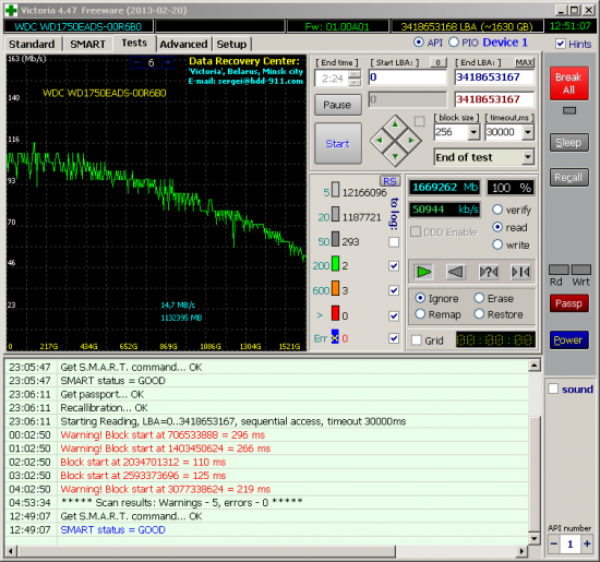

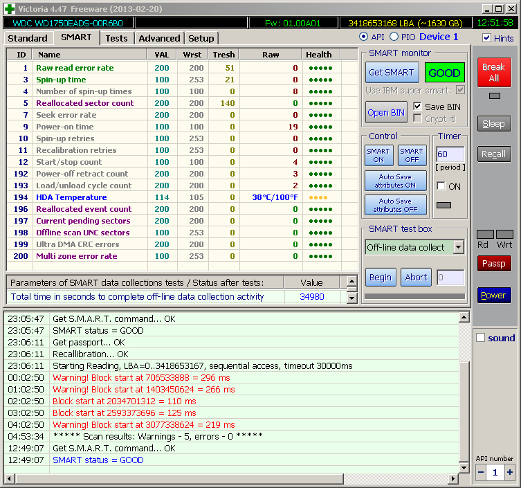

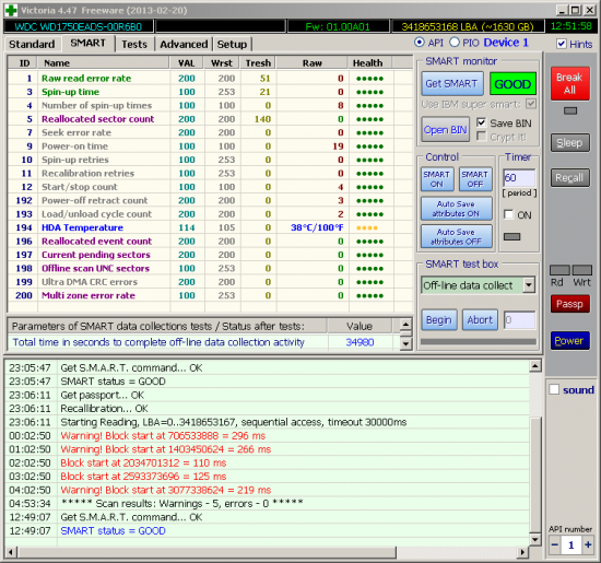

Final result is well good!
Have retest parts near those 3 orange sectors and they are finaly saying fine.
So I confirm you that the LBAs re-adjust is working.
Special thanks BGman, this tips is very useful!
