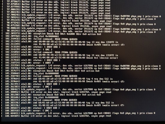

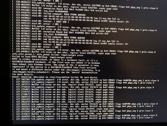

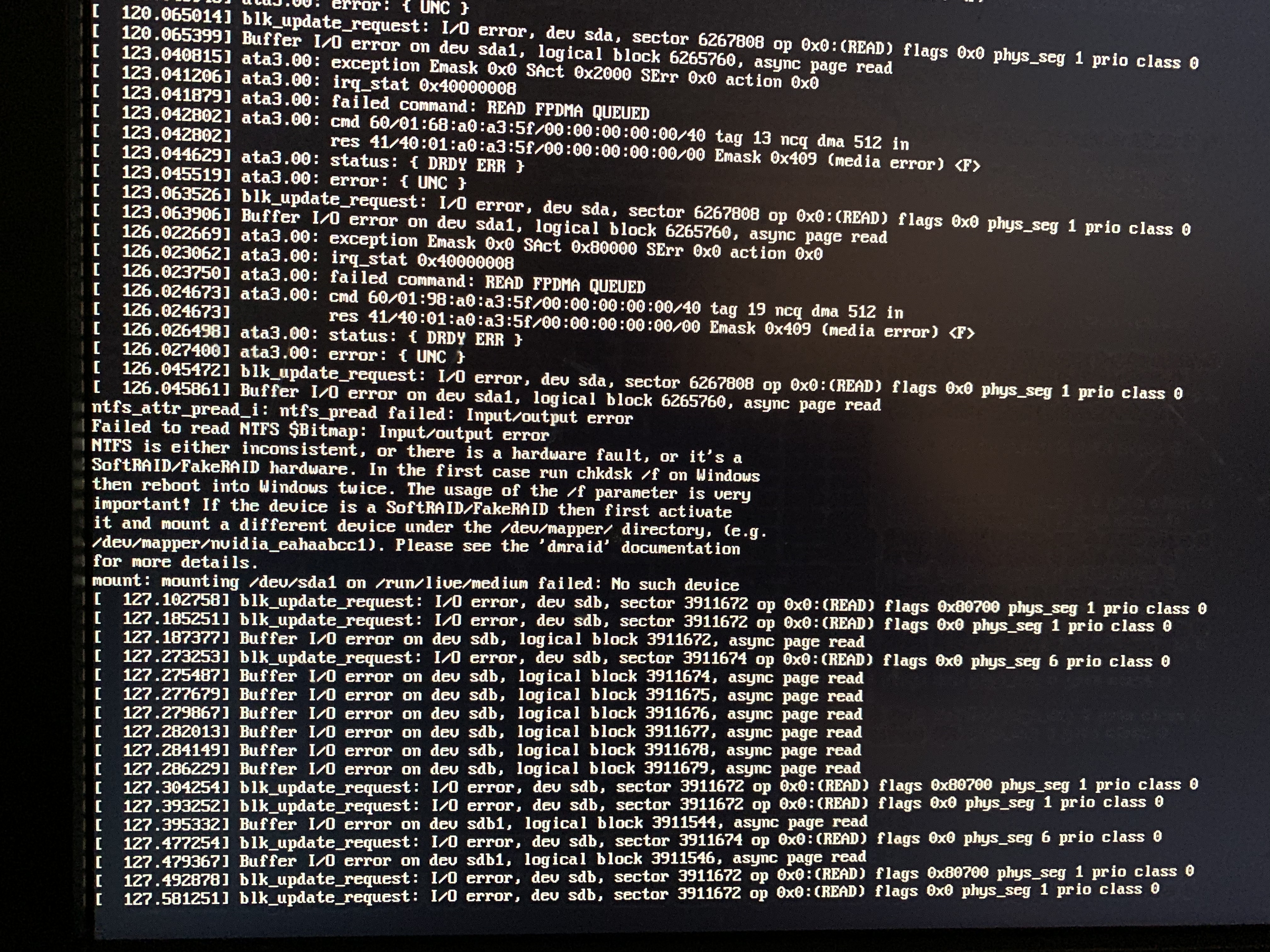

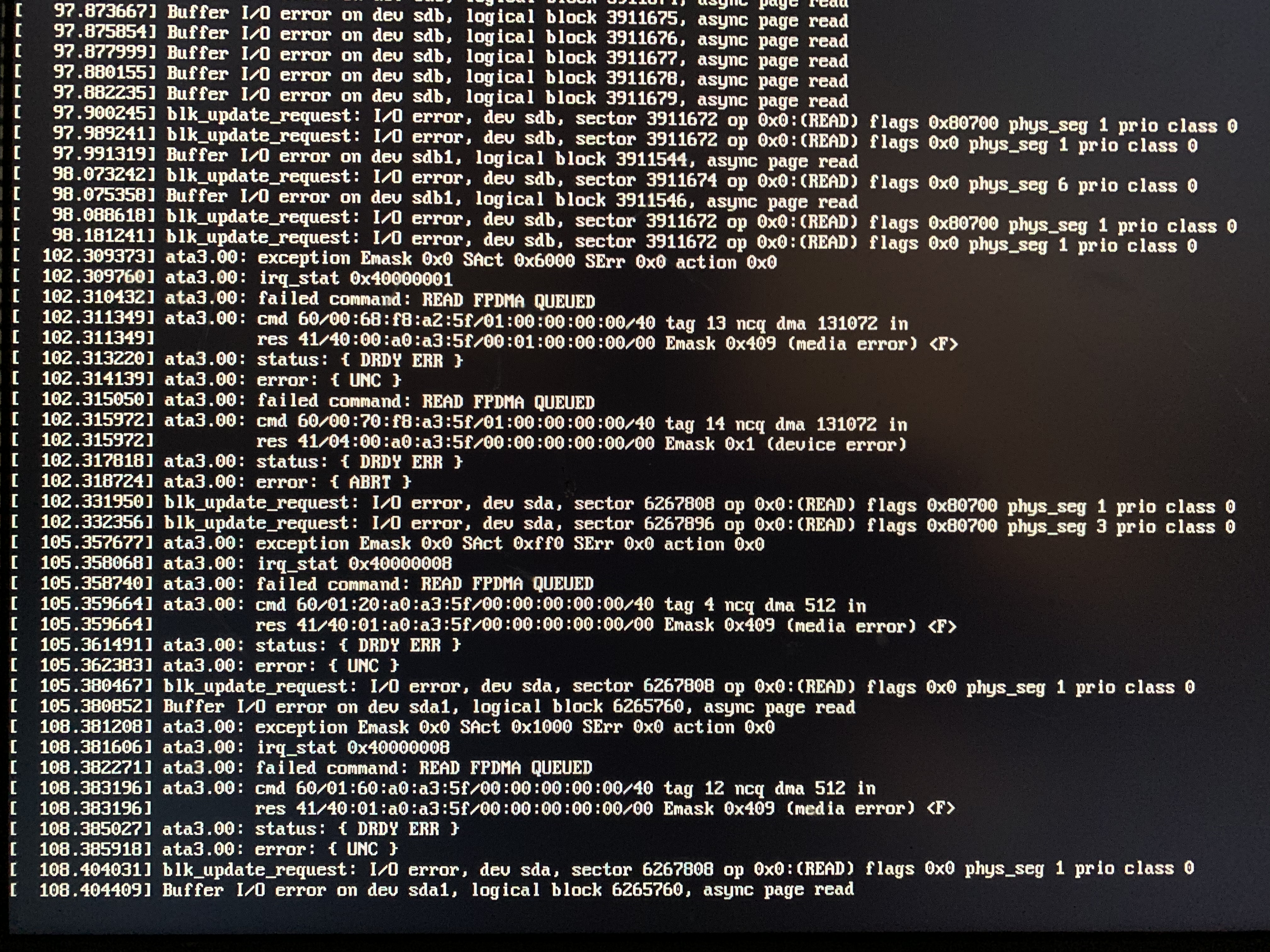

today when I started my Pc, I immediately noticed that it was taking more time than usual to boot (Windows 7). After booting up, by checking explorer, one of the sata drive inside was not working properly, not accessible and its size not detected.
I have tried to boot the Pc again more times but it did not help. I have tried to put the drive in another Pc, but same result.
The drive is a Seagate Barracuda ES.2 500 Gb ST3500320NS.
I have tried to boot gparted, and the software won’t start, with the attached screens.
Can someone point me in the right direction to attemp to recover the data (or part of it) inside? Thanks.

Since it's still detectable, try to image it with HDDsuperclone or DDrescue to a new drive and forget about that one.
