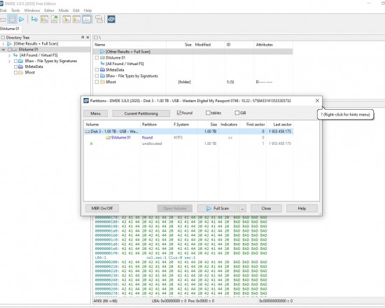

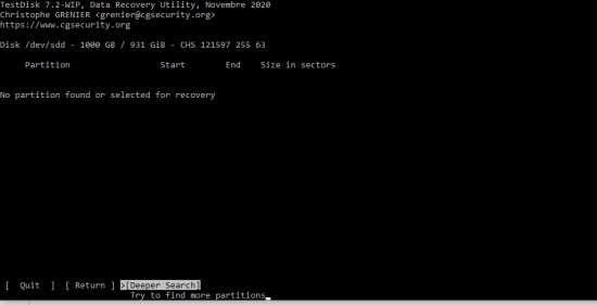

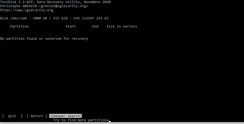

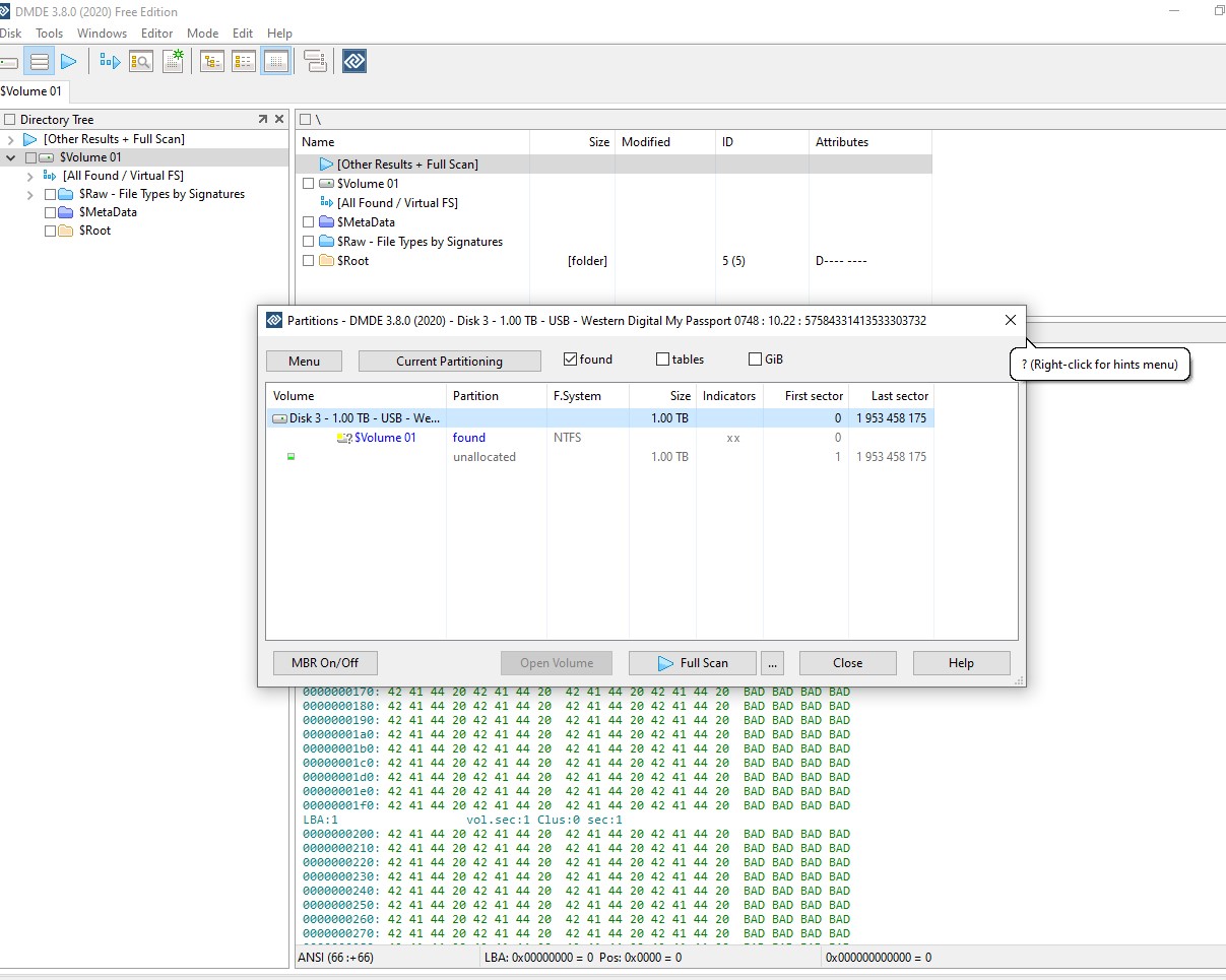

I have a 1TB WD My passport external HD that is not accessible (S/N: WXM1AAOJ2475). It is password protected and i know the password! but cannot access the the smartware utility. The information on the hd is precious for me, but not the hd itself. Unfortunately I cannot afford a Lab service since they are very expensive in my country.
Please see attached few screenshots from utilities I used. Testdisk didn't recognize any partitions and DMDE indicates lots of BADs...
Is there another utility I can use? What should I do next? Am I doomed??

Try this:
https://github.com/0-duke/wdpassport-utils
