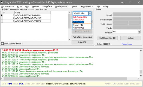

Lardman wrote:
What does wdmavel make of it :wink: ?

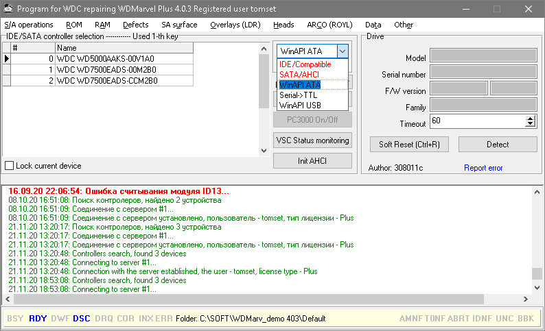

No options.
The password can be reset only in PIO mode. Via API - not allowed.
those, in the program, this is items - IDE/compatible, SATA/AHCI
or
Serial>TTL

cancunia,
He has a complex and everything is sharpened for such work.
It will not work on USB.
Or stick Disk into SATA and boot WinPE x32 from USB .
Or you need a terminal adapter.
