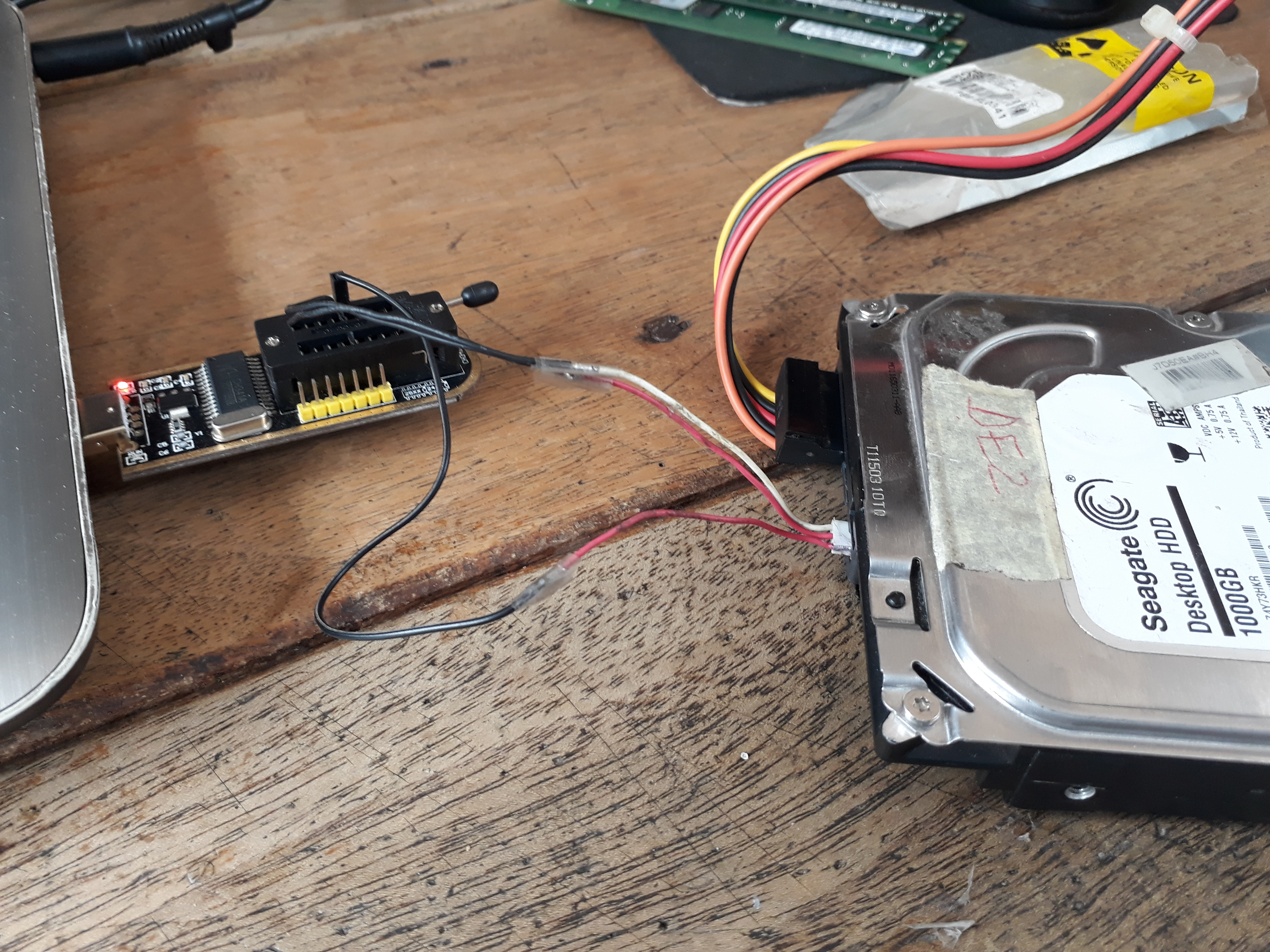

I have in my possession a 1TB seagate hard drive locked with a password after inserting it into a lenovo to do data recovery.

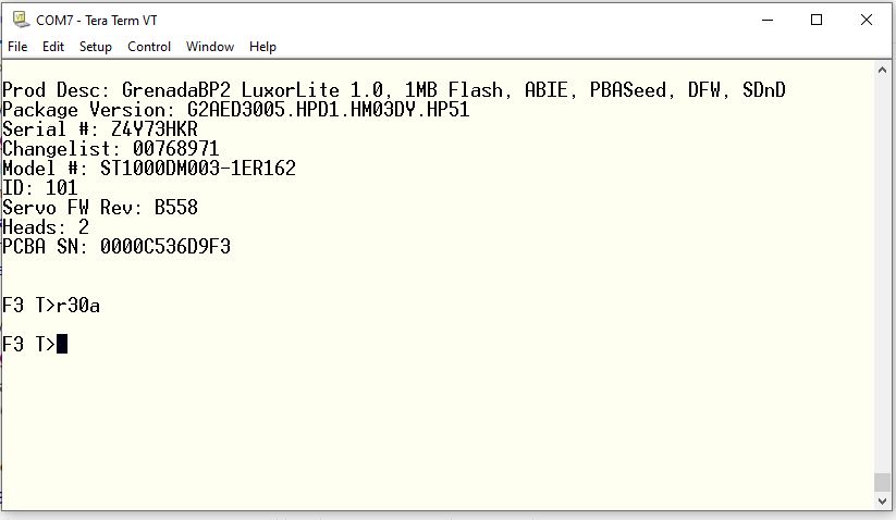

I tried this tutorial http://www.hddoracle.com/viewtopic.php?f=2&t=2394
but a problem occurs to me when I try to read the 30A module
nothing actually happens.
I would like to be guided or recommend a specialist for data recovery
 Post subject: Re: seagate st1000dm003 password locked
PostPosted: January 15th, 2022, 10:40
Posts: 4779
terminal is actually locked on these, so you cannot access fw without unlocking it first.
This is a complex process, no free tool would do it for you. So your way would be contacting a DR company.
