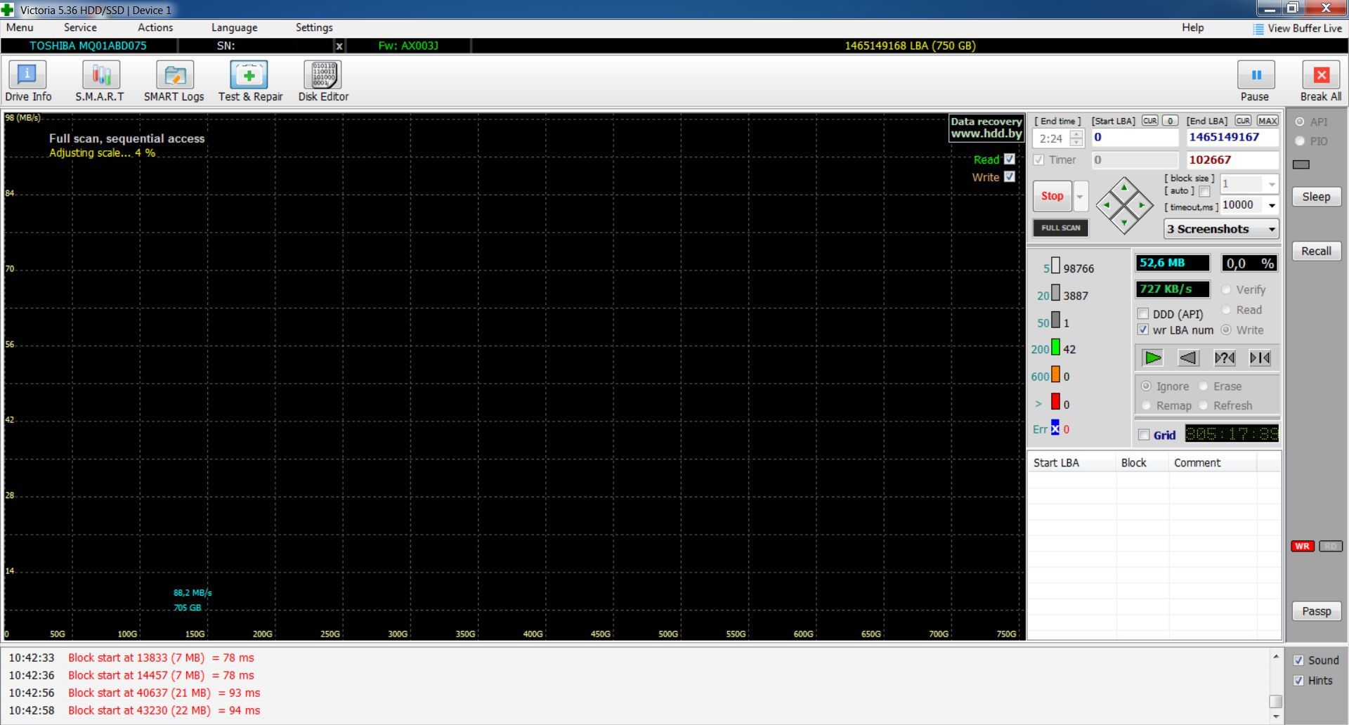

So if you have time to try:
- done three full write with Victoria (+option write LBA num)
- if your drive is doing something after a write pass (noise, touch it), let it finish before starting next pass
- maybe let the drive plugged and idle for about 3-4 hours after those three erase pass
- go show SMART, look if pending is fall at 0 and if so do next
- full read it with Victoria, save the result with slow/error sectors, and show full chart (untick Grid option)
Killing head or bin it is the same result, so burn it and made it fail now... (but I doubt head fail will occur when looking at your current SMART)

There are about no diff, except that ATA Secure Erase will maybe write different data many times (or maybe it's only for the enhanced).
And this is a good thing for trying re-activated "for good" those pending sectors, I suggest you using "darik boot nuke" 3 pass instead ATA Secure Erase that you dont really know what it is doing.
I little simulate it with Victoria by 3 pass + write LBA num, but it's maybe better if random patterns will be written.
As I know you cant read this diagnostic with Victoria.
I have forgot that maybe you want to full repair it through the diag port, but sorry I dont know how for this...
And I think you will lose nothing by firstly try those writing tests.

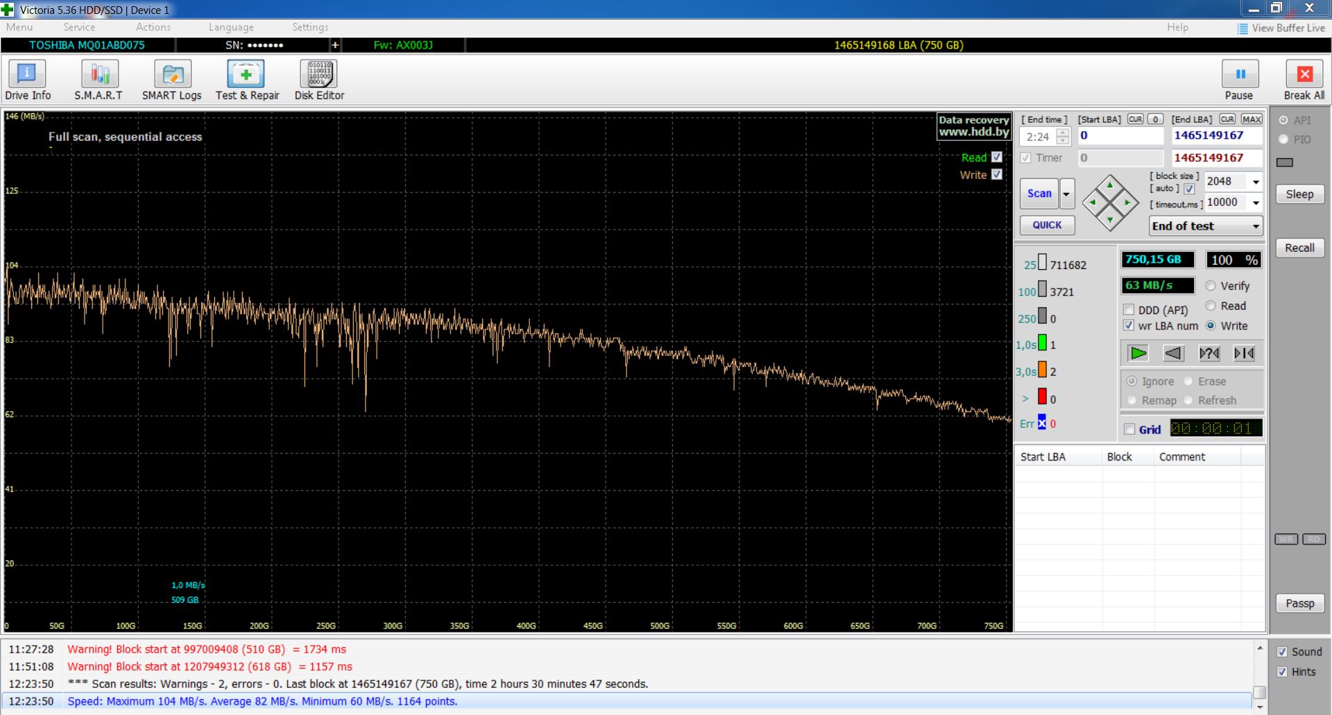

The only way you get to eventually repair those pending is by full writing the drive, so retry, and maybe with another solution than VSC Secure Erase.
Look if the pending fall to 0 just after full write, if yes, re-done 2-3 full writing.
There is something strange in your story, because you cannot be under Windows after a full erase.
So maybe you really get some bad sectors, that have re-appear pending during/after the Windows install.
You can only try multiple erase pass to try restore them in a "right" state.
After those erase, you have to full read your drive, pending or not, to really see the drive health, and for adjust your partitioning.

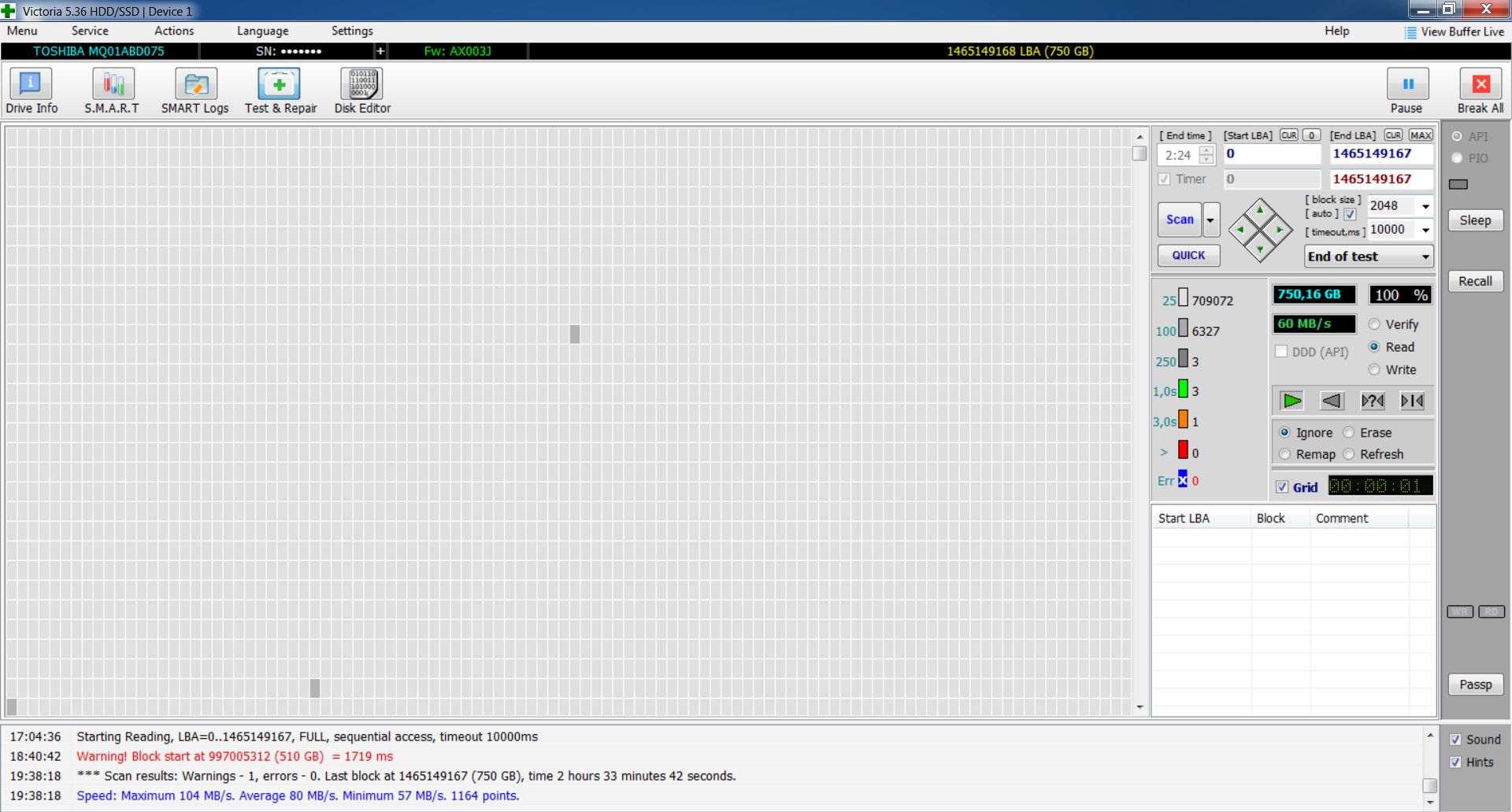

Only recently have I been able to deal with this drive, a few updates:
1) After a month since the 216 pending write sectors were detected, 8 reallocated sectors were added.
2) A few days ago I’ve connected the disk using a Usb > Sata adapter and after a few read-write tests copying large files, the total pending sectors count increased to 624.
3) I’ve performed a full read test with HD Sentinel that detected 3 damaged blocks: Block 0, 6804 and 8244 (see image)
4) Using the "Disk repair" function of HD Sentinel I’ve overwritten only the blocks above and the contiguous ones. After this all the pending sectors became reallocated sectors for a total of 632.
5) Connecting the disk directly to the Sata port of the laptop, I’ve performed an Ata Secure erase command using Hdparm.
6) I’ve rerun a full read test with HD Sentinel which detected 8 bad sectors in Block 6804, the very same detected and fixed before. I’ve then overwrote them again and they became reallocated sectors.
Can having the sectors marked as reallocated be enough to prevent the damage from expanding, or is it better to partition the disk to exclude the affected areas ?

It's better that you success triggering the reallocation on all those failing sectors.
Your drive can have about 16 000 reallocations, so you have a nice margin.
Are you saying that now you get 632 realloc and 0 pending?
If yes, you seems on the right way... (while this 632 count do not explode to like 10k)
Concentrate your read/write pass on those defective parts, like 6804.
If the defects keep growing, consider using partition that exclude those defects parts.
We cannot know if the damage will expand, so maybe partition it right anyway, but it might be not needed...
Right test it with many pass, unplug, retest it next day.

Below the image with the results of the function "Full Surface Scan with Grid" of Victoria 5.36.
Sectors with access time within 100 ms increase considerably at the end of the test.

Okay! It seems that you have already nice cured it! The result is not bad!
As you can see on the Victoria screen, one orange sector is slow, and three others green are suspect.
It's not sure that you will success triggering an auto realloc on this orange just by writing/reading...
Try to find the exact sector(s) that slow down on this part by choosing block size of 1 sector, then try doing many write/read pass on it with a little sector margin. You can resign if no change after about 50 pass.
If not a success and you spotted the exact sector culprit, retry as before with no margin this time, so scan only one sector culprit by pass, and you check the Victoria option "Remap", if you are lucky it will maybe finish by realloc it. (try also with reducing the timeout to a tiny, that perhaps will force Victoria to remap...)
I would propose you the hdparm --make-bad-sector, but it finally seems that it will not trigger a true reallocation, you can anyway try it if no success before. (it seems that the UNC it create will be removed by a simple write)
The HD Sentinel report is showing about 100 bad sectors, so there are about 500 previous that we dont know where they are.
You have to at least target with multi pass those three zones 0, 6804 and 8244 for further tests.
Do it with the HD Sentinel "Reinitialize disk surface" if you can, and also reduce the retry to 0 if you can.
I recommend you this option because it will be less headache for you than Victoria if it really do what it say, this option seems like Write-Read-Compare-Write0, so it correspond to 4 or 6hours Victoria full scan, but Victoria will not compare anything.
If you do not success to trigger a realloc on this orange, you will have to live with it, with the risk that it become full bad a day, so maybe consider bypassing it with right re-partition.
Check the Victoria option tab "Test options" for adding the green sectors position. And I said UNcheck grid, so to show the chart instead grid, but your chart seems fine.
And the tiny increased time all along the drive is normal.

Before your last post I performed a full disk write with Victoria, this is the result:
diybit wrote:
Try to find the exact sector(s) that slow down on this part by choosing block size of 1 sector ...
If I choose Victoria's "Block size 1" option, the read/write speed becomes excessively slow (727 KB/s) and the time to complete the operation impractical (see screenshot below). I don't know if I can choose the "Block size 1" option at the end of the full disk read/write ...
Yesterday I wrote blocks 0, 6804, 8244 and 5 other adjacent blocks (for a total of 11) using the "Reinitialize disk surface" function of HD Sentinel, performing 50 passes for each block. No errors were reported and the reallocated SMART blocks remained the same.
