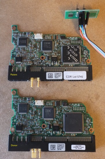

Patient HDD: IC35L040AVVN07-0
Patient PCB Sticker: 07N8979 H69144A
When powered on HDD enters BSY. No spin up. No short on 12V or 5V.
The customer reported the HDD failed after a power outage.
I found a matching donor:
Donor HDD: IC35L040AVVN07-0
Donor PCB Sticker: 07N8979 H69144A
1) The patient NV-RAM was transferred to the Donor PCB. Patient HDD was then powered on with Donor PCB + Patient NV-RAM. HDD does not spin up. HDD reports RDY. It is possible to read the (patient) NV-RAM in PC3000. The contents looks normal.
2) Using the donor PCB with donor ROM and donor NV-RAM, mounted on the patient HDD, then the HDD does spin up enters RDY. But then the normal error is reported when drive ID or other command is sent to the HDD.
3) Finally, I transferred the patient ROM and the patient NV-RAM to the donor PCB. When this happens the original fault (no spin up and BSY) is replicated.
4) I then repeated the process with a second donor PCB just in case the first donor PCB was faulty. The results were replicated.

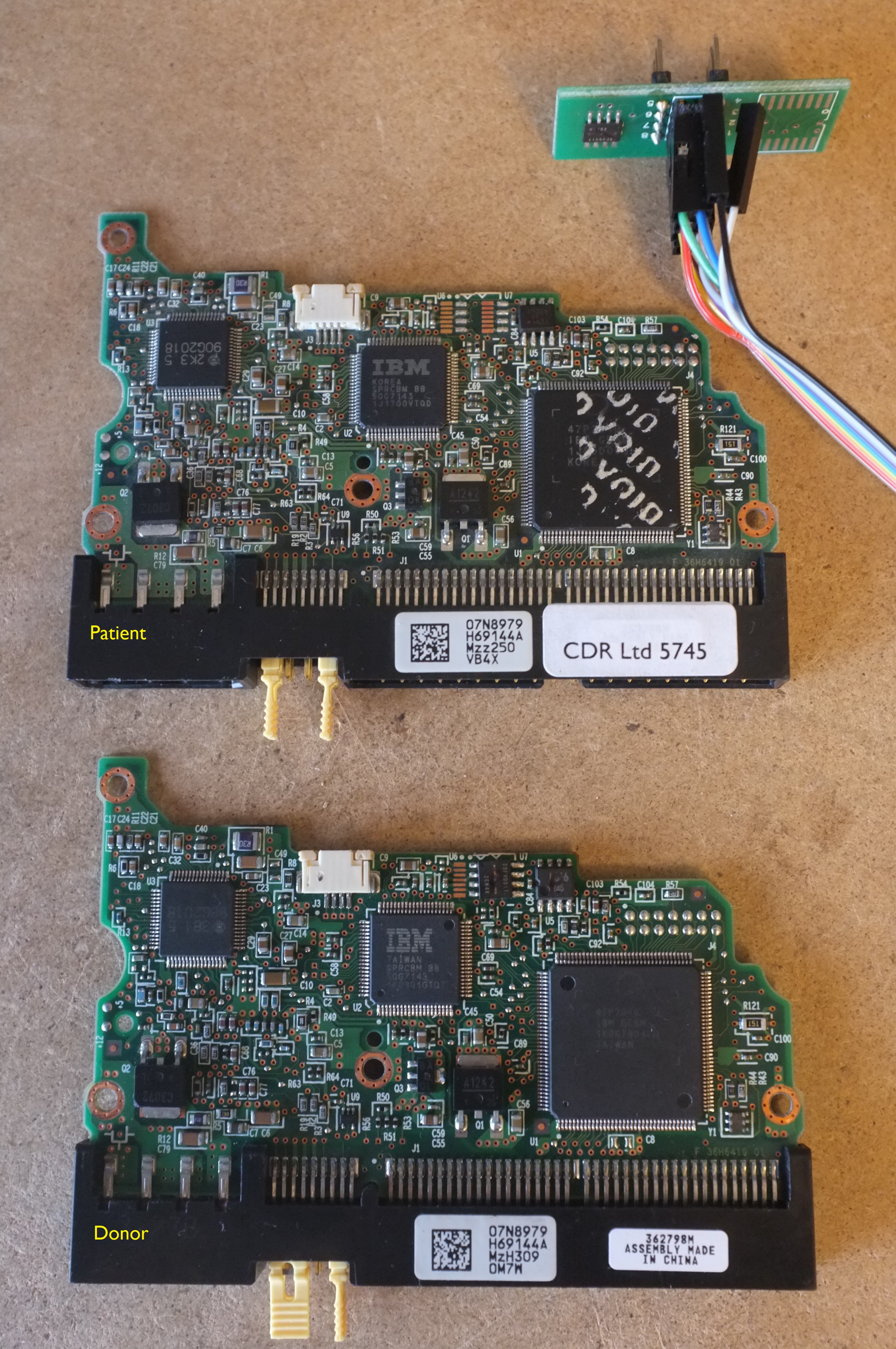

When the donor ROM (U6) + patient NVRAM (U5) are on the patient PCB I get the same result as when they are mounted on the donor PCB. That is the HDD will enter RDY with no spin up. I can then read the (donor) ROM and Patient NVRAM within PC3000. This indicates that the patient PCB is likely to have good functionality with the exception of the ROM and potentially the NV-RAM. Likewise, if I mount donor ROM and donor NVRAM on patient PCB, the patient PCB can be used normally with the donor HDD.
At this stage whilst it has been possible to read the patient NVRAM (see attached in .zip) via PC3000, it has not been possible to read the patient ROM chip. Whenever this is mounted on a PCB it causes the PCB to enter BSY even when jumpers are set to safe mode. I have dismounted the ROM (U6) and I am trying to read with an external reader. However, the chip used is a LE25FV051T (datasheet attached) and is not supported by either external reader I have available (RevelProg or MiniPro). According to the pinout in the datasheet this chip uses quite a different ordering to most "25" chips. Trying to re-order the wiring to match the LE25FV051T pinout, using a 3.3V supply does not allow reading this chip. I have a support request in with RevelProg to see if they can add support or make a suggestion.

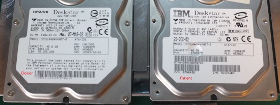

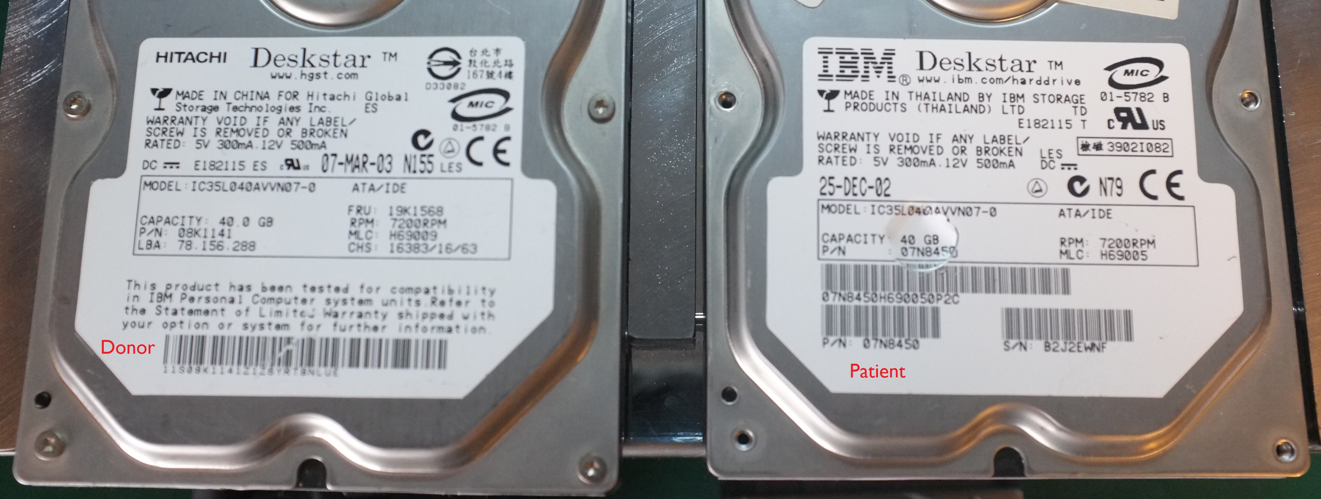

As Fzabkar suggests, perhaps there is donor ROM incompatibility. For reference, I have taken a photograph of the patient and donor HDDs and PCBs. The results are replicated using a second donor HDD, which only has a match on the first line of the PCB sticker.
