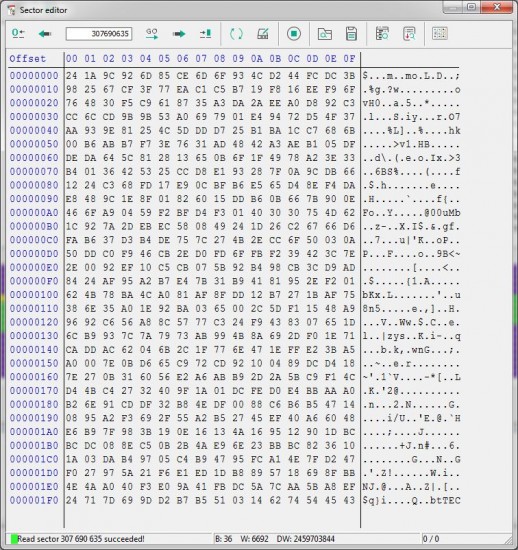

I had multiple Seagate Rosewood drives, with this kind of problem, and i don't have any idea what could cause this.
So the drives has good working heads, but always with some (or many) slow sectors, with the same pattern from every single drive. (picture attached)
While reading these slow sectors, there are error messages in terminal:
Starting LBA of RW Request=00024ADF8F Length=FFFFFFFF
ProcessRWError -Read- at LBA 00024ADF8F Sense Code=43110081ProcessRC: 00000001,00000000[Host]ReadContinuous: 024ADE53,00000197UnrecovSectorCount:0197,0196,0197NumUDEs: 00000197,00000000,00000196Passed(Host): 00000080,00000145Out: Adjust to DiscEndLba:
PrgFSkipLBA: 024ADF8F,024ADF8F
Starting LBA of RW Request=00024ADF90 Length=FFFFFFFF
ProcessRWError -Read- at LBA 00024ADF90 Sense Code=43110081ProcessRC: 00000001,00000000[Host]ReadContinuous: 024ADE53,00000197UnrecovSectorCount:0197,0196,0197NumUDEs: 00000197,00000000,00000196Passed(Host): 00000080,00000145Out: Adjust to DiscEndLba:
PrgFSkipLBA: 024ADF90,024ADF90
Starting LBA of RW Request=00024ADF91 Length=FFFFFFFF
ProcessRWError -Read- at LBA 00024ADF91 Sense Code=43110081ProcessRC: 00000001,00000000[Host]ReadContinuous: 024ADE53,00000197UnrecovSectorCount:0197,0196,0197NumUDEs: 00000197,00000000,00000196Passed(Host): 00000080,00000145Out: Adjust to DiscEndLba:
PrgFSkipLBA: 024ADF91,024ADF91
Starting LBA of RW Request=00024ADF92 Length=FFFFFFFF
ProcessRWError -Read- at LBA 00024ADF93 Sense Code=43110081ProcessRC: 00000001,00000000[Host]ReadContinuous: 024ADE53,00000197UnrecovSectorCount:0197,0196,0197NumUDEs: 00000197,00000000,00000196Passed(Host): 00000080,00000145Out: Adjust to DiscEndLba:
PrgFSkipLBA: 024ADF93,024ADFB2
These drives always had some problems with MC, maybe this can help.
Please light me up!
Thank you!

This is a generated pattern that the drive returns uppon uncorrectable errors under certain circumstances.

Okay, but what cause these read errors? Corrupt MC, or translator, or adaptives, or geometrics or or......?

The problem is not so much related to heads/sectors as to the degradation of the SA (the origin of all the problems of these units).... In my humble opinion this could have been solved (SEAGATE) by implementing a RAM according to the firmware requirements and not depending on continuous and repeated SA readings....

Both of them. If you could somehow get a good copy of those modules (2nd translator/MC) loaded into RAM it is possible (I don't know) that these "garbage" sectors would not appear in the copy...

I've had several cases where a head changes fixes it. It depends on whether the error is localized or virtually every sector read by the head.

HSA change solved the problem.
