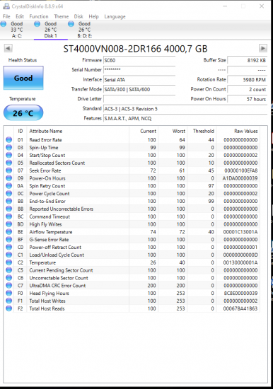

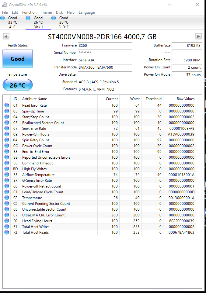

I recently bough a new IronWolf for my NAS and wanted to test it in my PC at first.
Could anyone review attached results and tell me if I should be worried?

Your results do not show any problems.

And what about bad sectors pointed by EaseUs program in the number of 5055?

Does your SMART report show the state of the drive after the surface scan, or before?
Your transfer rate is 26 MB/s. That's a USB 2.0 speed. Was your drive connected externally?
