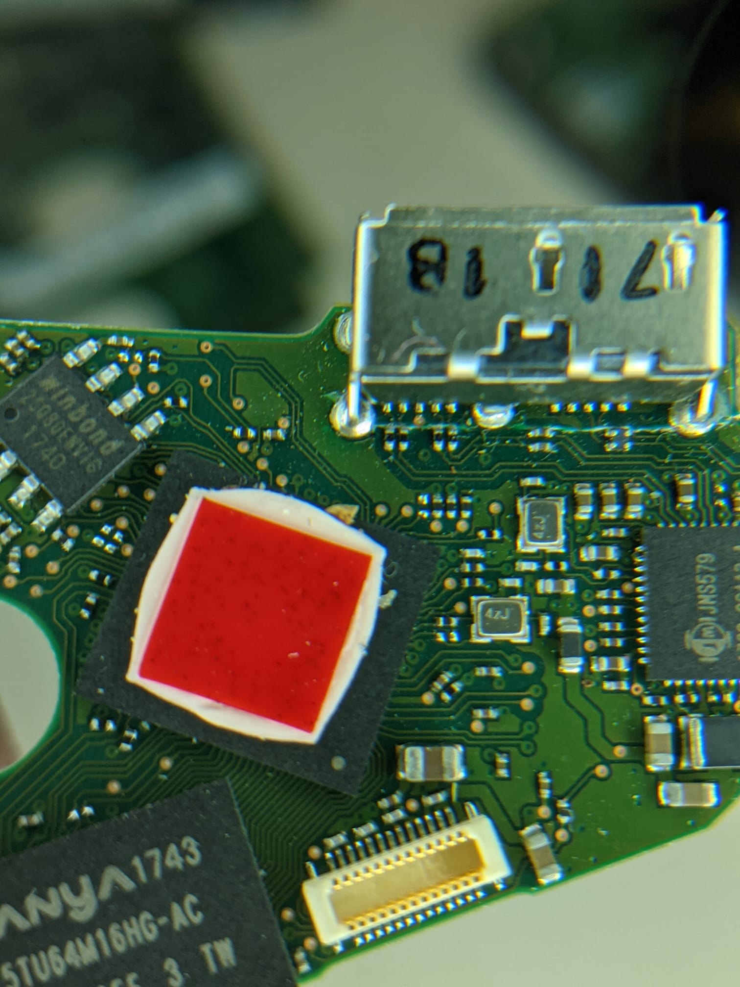

For past year, I've been browsing this forum to play with my olds HDD's but never had to recover anything, today things have changed.
I broke my HDD. USB connector was bend and now drive does not power up.
I can't fix it with my micro-soldering skills, I tried but no luck, looks like there's several lines damaged. I tried to read the Winbond ROM and that works. I've wrote the ROM to another 800067 PCB, same Winbond ROM (I saved it before) and I connected that PCB to the broken drive... no luck.
What am I doing wrong ?
Thank you for your help and for all the great information shared on this board.

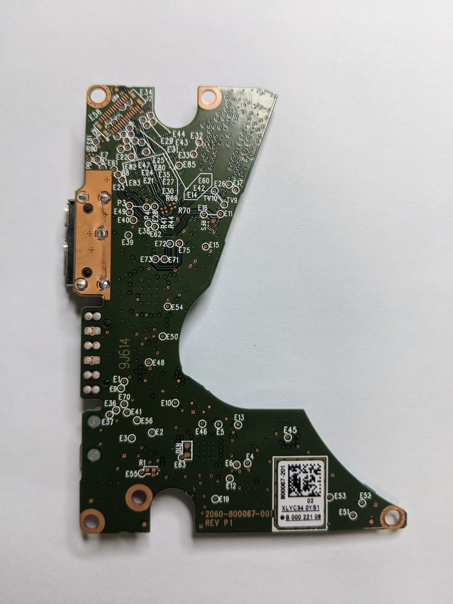

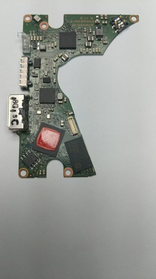

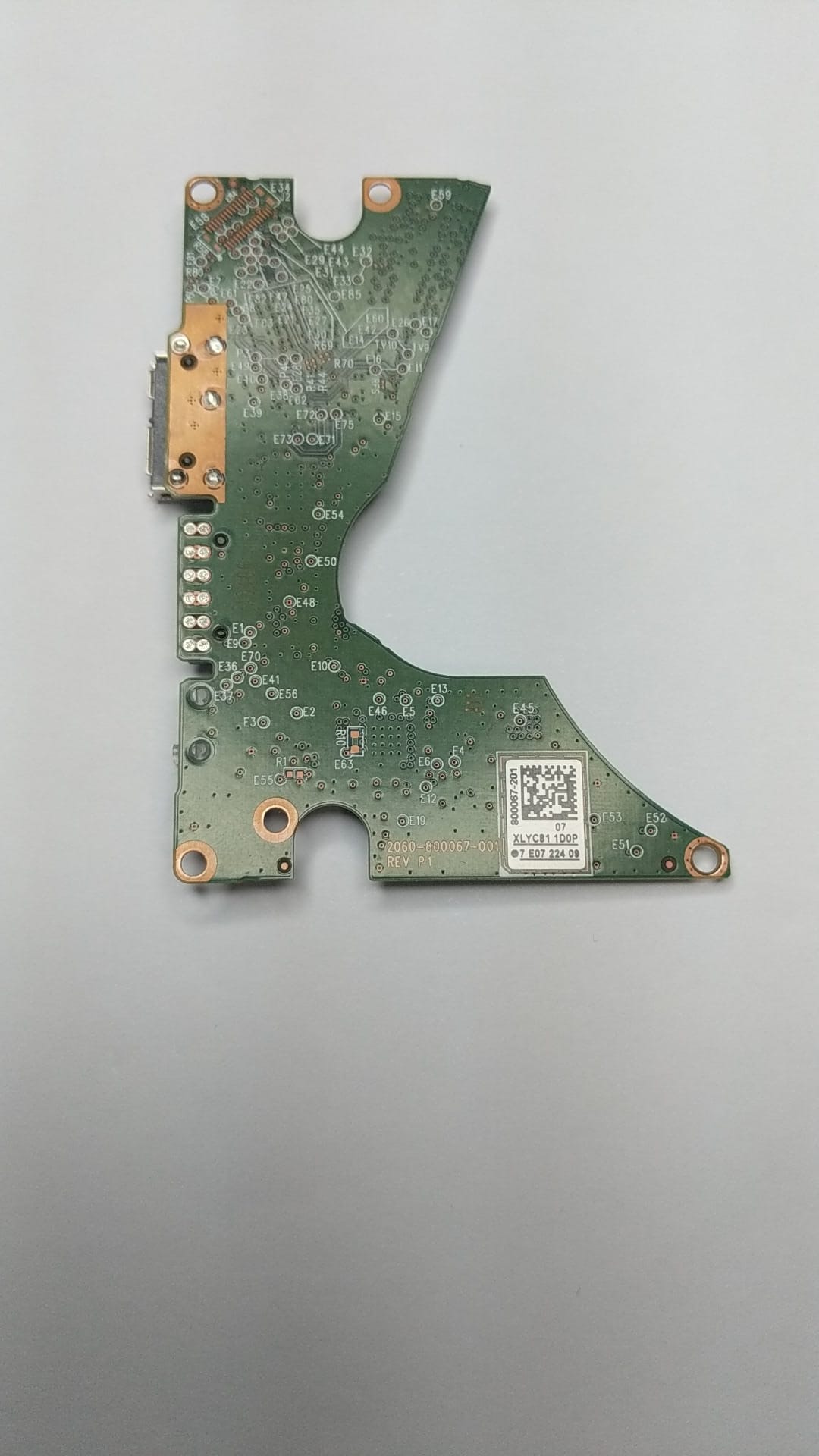

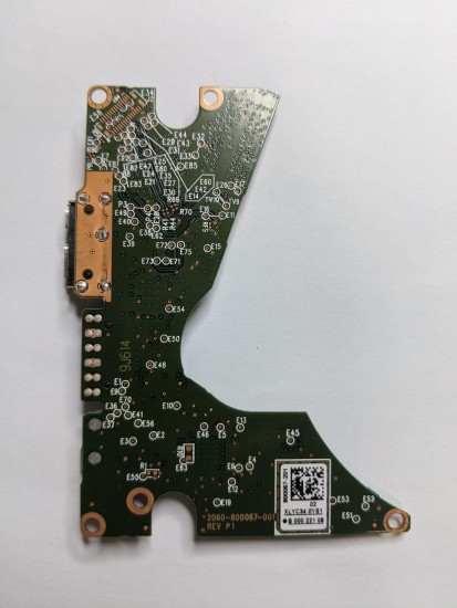

please post a picture of old pcb and new

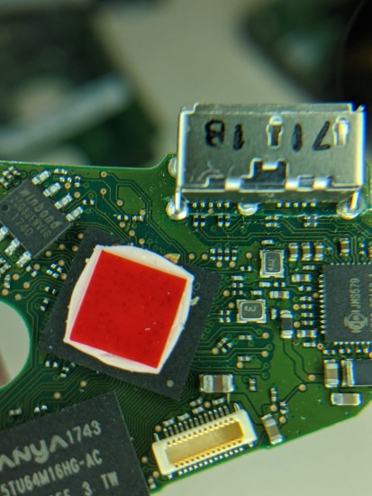

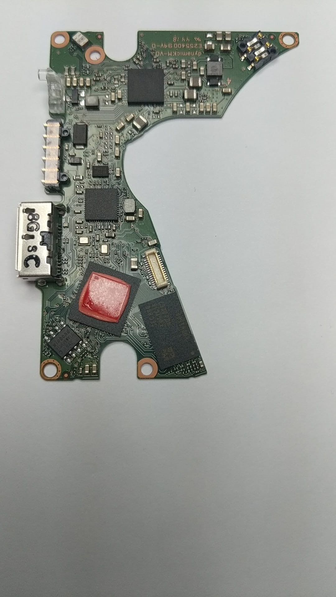

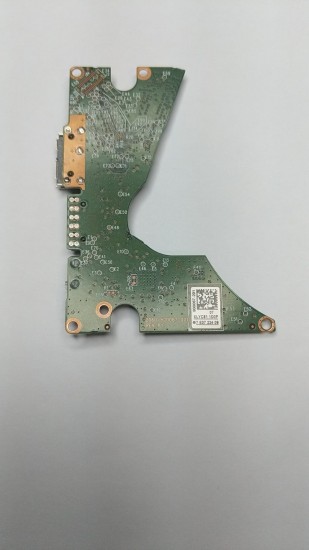

Thank you for your reply. Here are four pics. Two of the cracked PCB and two of the "working" one.

This is because your "damaged" ROM wasn't fully read. The correct size is the one of your "good" ROM. Additionally, you might run into trouble by simply replacing the PCB on a Charger with a ROM swap. You might have to transfer other components too.

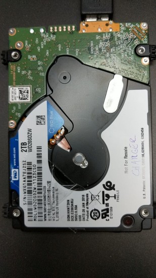

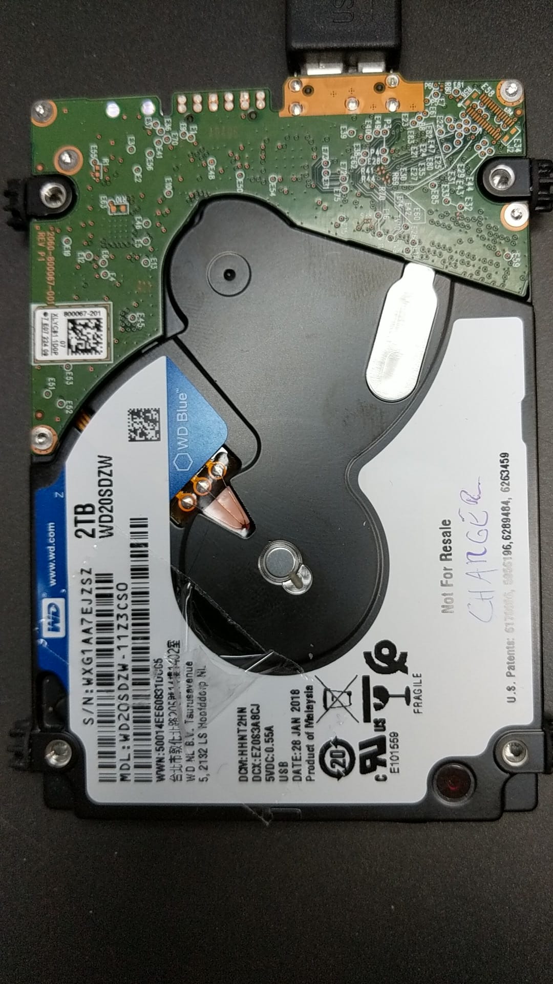

can you post pic of label on your patient disk?
 Post subject: Re: WD Charger - 800067 - USB connector cracked
PostPosted: December 15th, 2020, 5:32
Posts: 4854

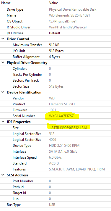

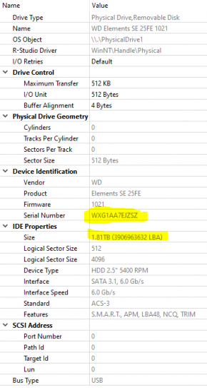

I've read again the ROM (ROM attached below), size is correct now, thank you Northwind. I wrote it on donor PCB and connect to the drive, it's slightly better but I can't access data. My PC can see it's connected, it's 2TB but no partition.

check in disk manager, does it show correct capacity?
I saw you got SN, which is a good sign, but capacity should be ok as well.

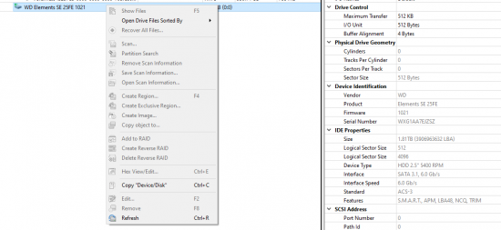

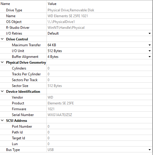

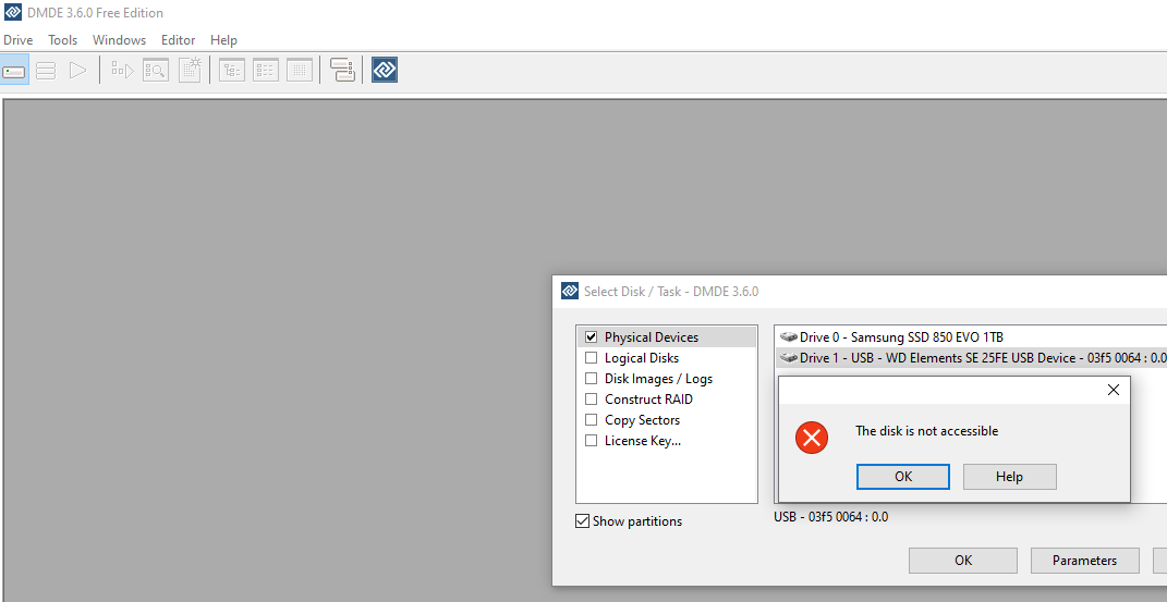

So in disk manager, it does not see the disk, it says " do you want to initialize MBR or GPT" and then it fail. R-Studio can see size and ID but there's no partition so I can not scan anything.

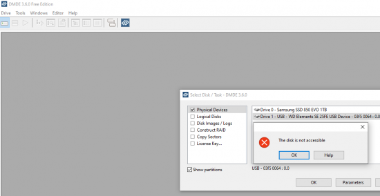

All sectors ABRT IMO ( An issue related to SA )

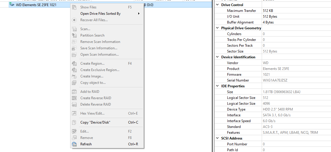

right-click on the drive in Rstudio and select View/edit and post what you see.

You may also give DMDE a try.
If it gives you an error reading sectors from the beginning, then you have a serious problem. ( Also if it gives zeros then it's another story )

Doesn't look good. Not sure why.
PostPosted: December 16th, 2020, 5:20
Posts: 4854
that's why i asked for a pic of sector editor.
But that error in DMDE is not very encouraging :s
