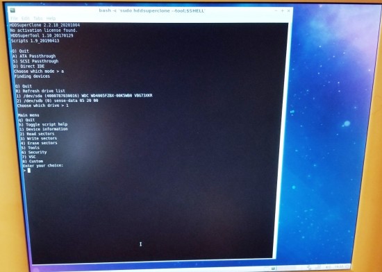

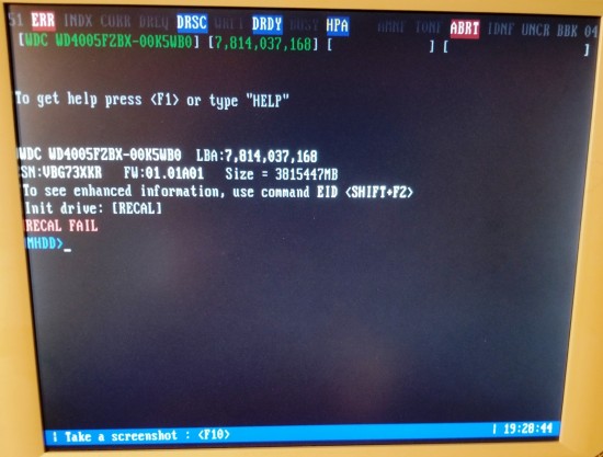

MHDD sees it, but when I init drive it says "recal fail."
Hdd Supertool sees it in ATA and SCSI passthrough and it will Identify it. Smart Info fails. If I try to Scan Device it, it gives all errors. I have not tried Direct mode yet, because even though I am having it boot off USB stick with no other hard drives connected but it, the program warns that the drive is available to OS and exits. Before I went through the trouble of "hiding it," I wanted to confirm if the program would work on the drive.

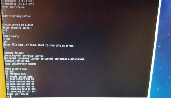

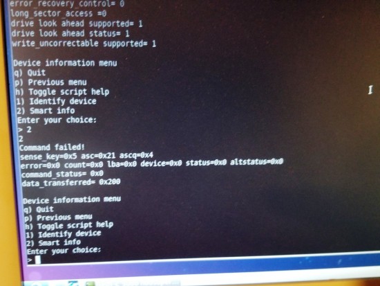

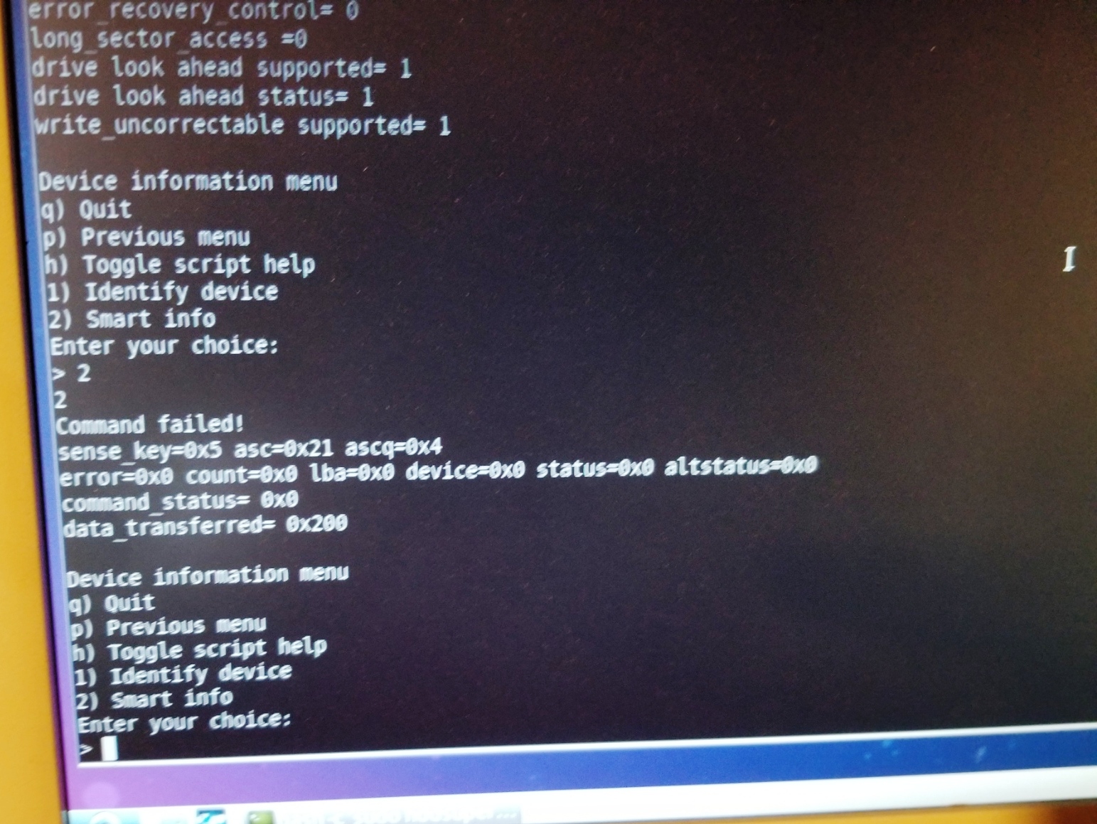

The only way to know if you can get any further in direct mode is to try. There is a slight possibility it could help, but the information given is not promising. With just the ATA passthrough mode, what are the return error and status register values? What are those values when trying to read a sector, and what are they when trying to get SMART?

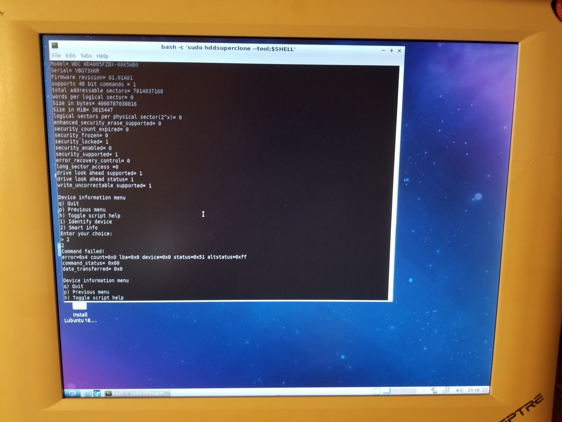

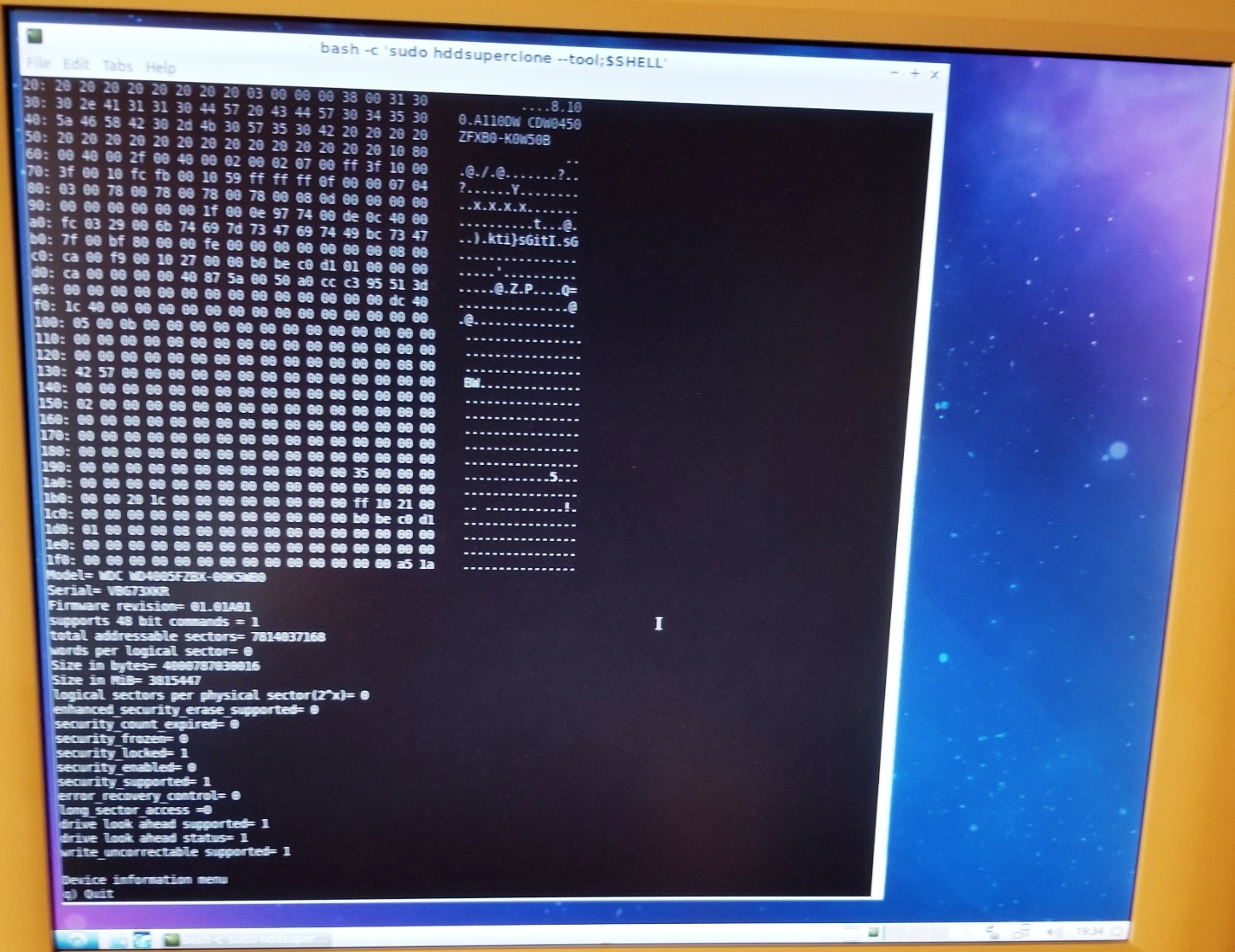

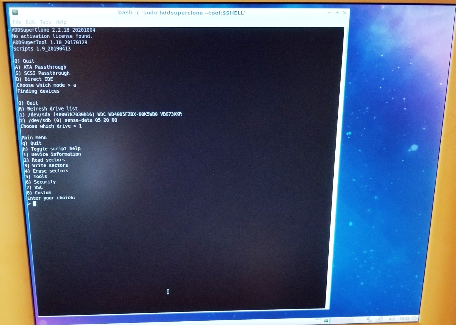

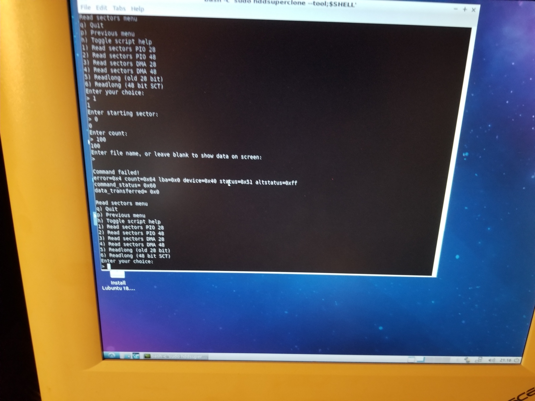

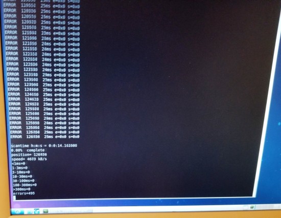

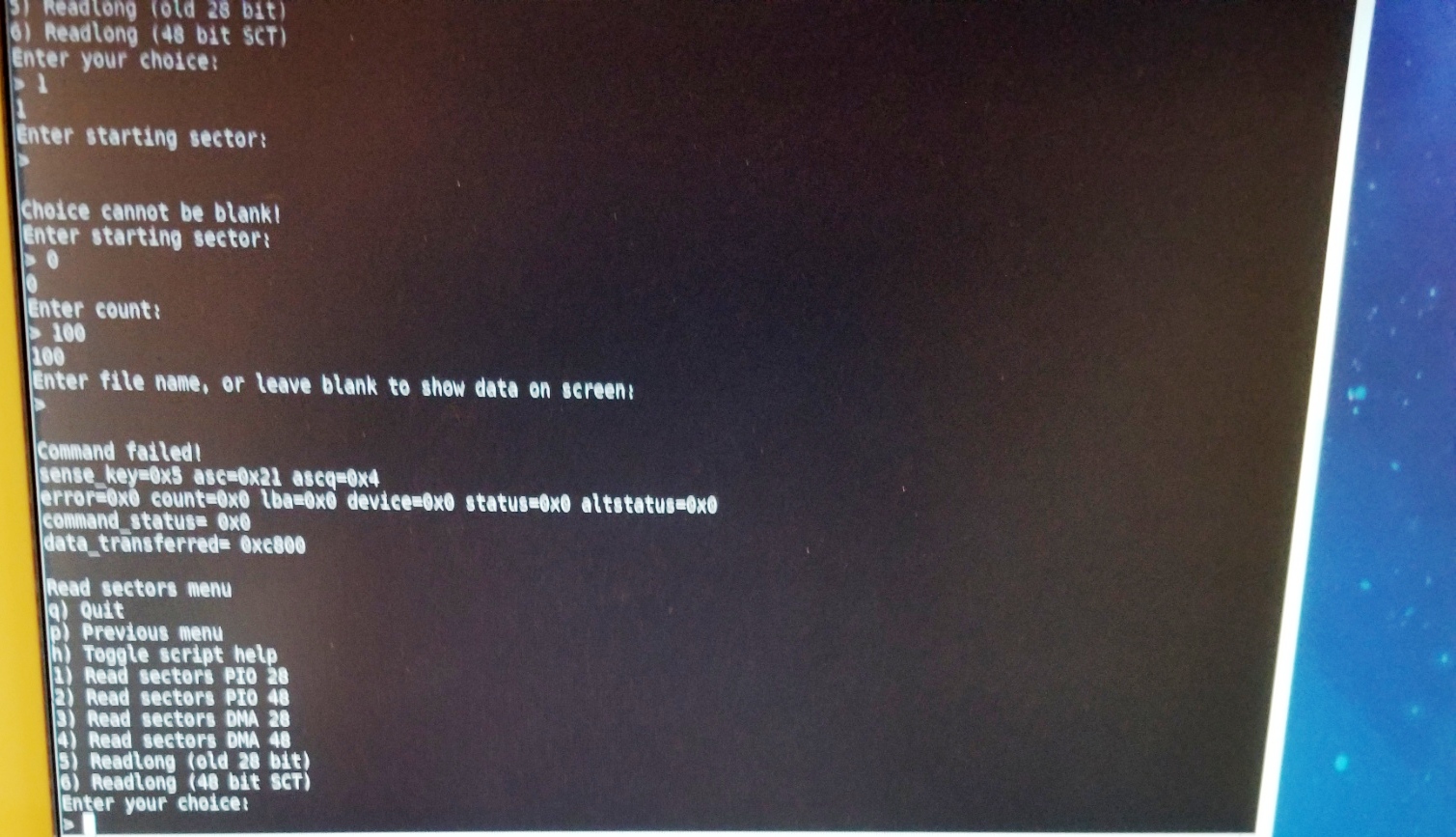

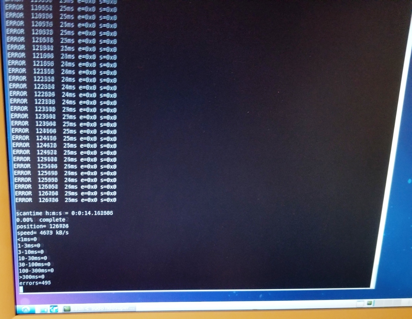

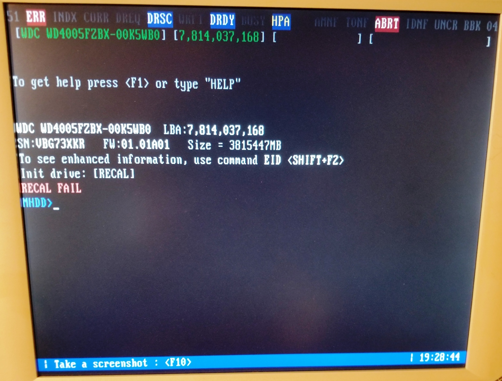

@maximus Not sure what you are asking so I took pictures, lol.

Since you are using the 18.04 version of the live CD, the ATA registers are not returned in passthrough mode so we can't see what they are. I forgot that quit working around 16.04. The interpreted sense code returned is illegal command, which is both weird and probably not a good sign. To see the actual ATA registers would require either using the 32 bit 14.04 version of the live CD, or direct mode.
FYI Since you are using MHDD, I am guessing you have the BIOS in IDE mode. If you power on the drive AFTER you boot the live CD, it won't show to the OS and you can work with it in direct mode in HDDSuperTool.

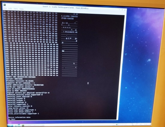

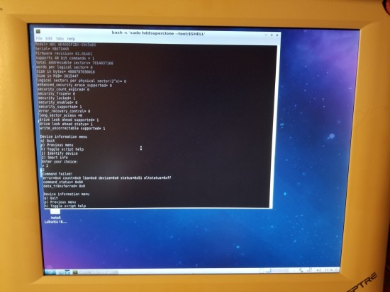

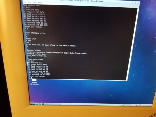

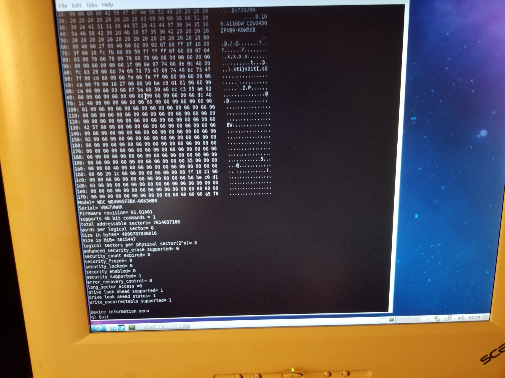

I used HDDSuperTool, and applied power on the drive AFTER it booted the live CD. I selected direct mode and got similar results... If I need to try different options, please let me know and I will get you the results.
 Post subject: Re: What tools support WD/HGST Black and Red Drives?
PostPosted: December 24th, 2020, 16:49
Posts: 17256
The drive is reporting that security is locked. This implies that a password has been set.

@fzabkar I saw that also, but it has security_enabled=0 below that...so I did not comprehend if it was locked or not?

The status is an aborted command, but no device fault. Combine that with the security locked but not enabled, and you have a firmware issue, possibly caused by a bad head or heads. If it is not supported by commercial tools such as PC3000, then it would take a DR expert to deal with.

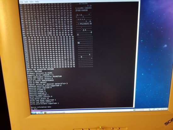

I did some more testing with HDDSuperTool.....
2=Red 4TB WD4003FFBX
2=Black 4TB WD4005FZBX
1=Black 6TB WD6003FZBX
1=Red 8TB WD80EFAX
1=White Label 10TB WD100EZAZ
ALL the above have the same symptoms as we have been discussing. The security_locked = 1, security_enabled =0.
NOW:
1=Black 2TB WD2003FZEX
1=Black 4TB WD4005FZBX
These worked with showing smart info, read sectors etc.....What is different? security_lock = 0! Now to figure out how to set the other 7 drives to security_lock=0. Pic attached of working 4TB.
With all these new HGST architecture drives, it the drive cannot read from SA then they report they're password locked.
If you just connect a PCB alone with HDA disconnected it will report as correct model and S/N but as password locked.
PostPosted: December 25th, 2020, 13:43
Posts: 17256
Thanks, I now recall this thread:
https://forum.hddguru.com/viewtopic.php?f=1&t=40129
