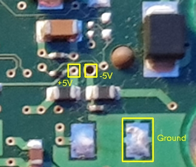

With the PCB on the drive, measure the resistances between ground and each of the +5V and -5V test points.
Hi ! Sadly i don't have a multimeter where i actually am. But i bought a new pcb.
I installed the new pcb (without moving anything).
I think that there's a problem with mechanical parts. So seems to be definitely dead.
The motor makes sound but not a very reassuring one. It then stops itself after 30 seconds. Nothing detected by Windows of course.
