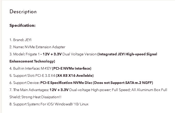

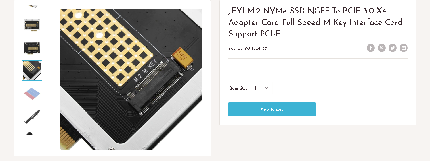

Hi fzabkar & maximus
Thanks a lot for replying.
Unfortunately I don't have latest chipset motherboard having internal M.2 slot .
Can I directly this SSD in PCIE X16 slot instead?
Other alternate is "M.2 NVME to PCIe 3.0 x4 Adapter with Aluminum Heatsink Solution"
I have tried JEYI Adapter for NVMe M.2 SSD's but this SSD is not getting detected there.

I understand that you wouldn't see the PCIe drive in BIOS, but I would think that it should at least appear in Device Manager.

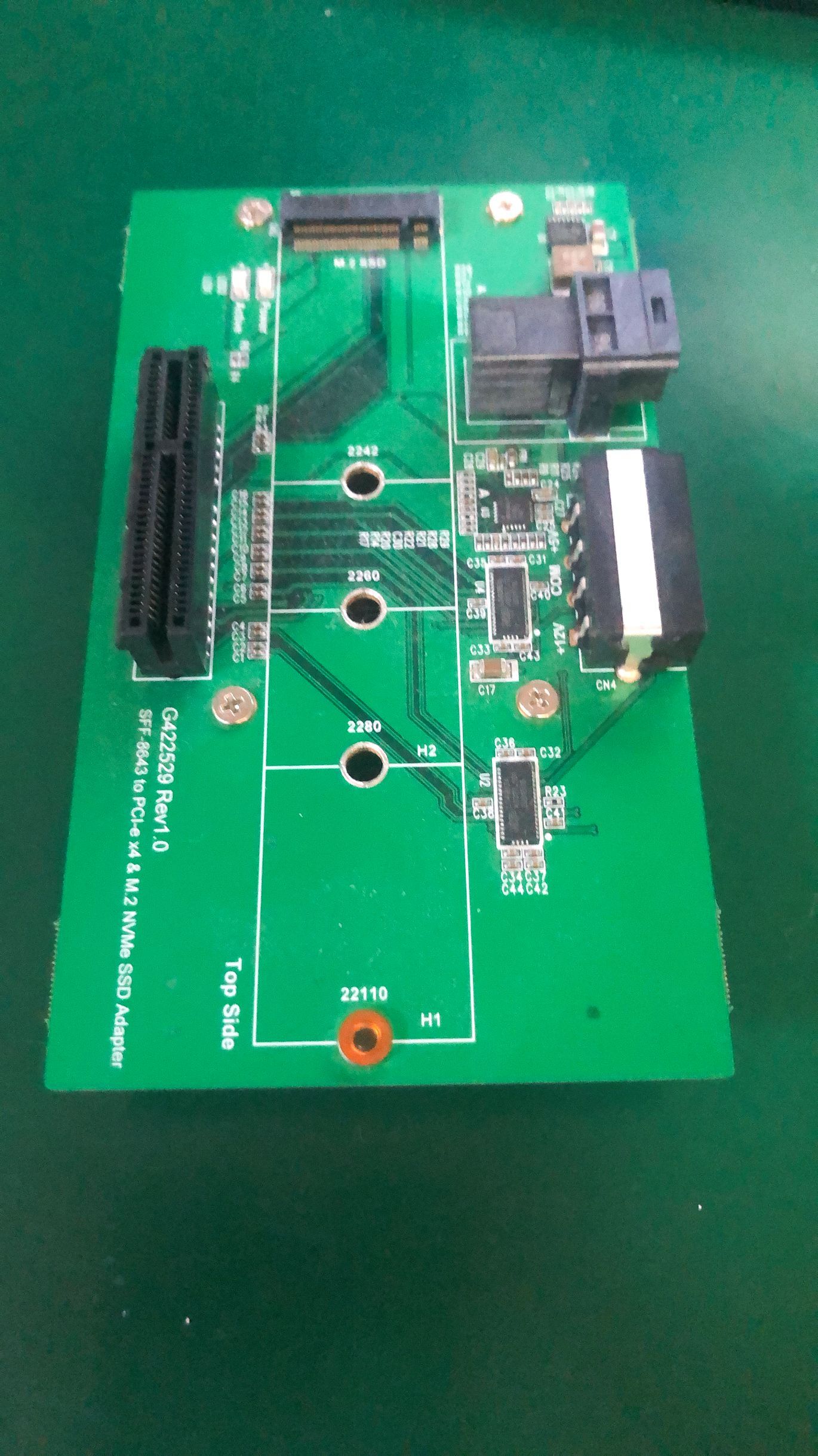

So I would like to take this off the rails on a crazy train. What about NVMe to SATA instead of USB? Last I knew there were not any adapters that directly did this, and the ones that said they did were mislabeled and only converted M2 SATA to the regular SATA interface. But someone emailed me a while back with the idea of using a couple chained adapters to achieve a true NVMe to SATA adapter. The message indicated that NVMe to USB was not stable, but the NVMe to SATA was much more stable. There is a significant language barrier for the communication, so I cannot be sure if they mean the idea was a success, or if they were suggesting it, or asking a question about if it would work. But there were images included that I am attaching. I have had this on my to do list for awhile to see if it would work, but it was not high on my priority list and I have not had the time. It might not solve the heat problem, but maybe it can solve the instability problems. It is also supposed to allow power cycling, which you can’t do with a direct PCIe NVMe card. If you wait for me to try this, it may still be a while, as I have other things higher on the priority list. Hopefully this is actually a workable idea.

ISTM that the only SATA component in those images is a cable which converts a standard 15-pin SATA power plug into a 4-pin, +12V/+5V Molex peripheral connector. This is needed to power the adapter PCB.
This adapter simply provides slots for an m.2 NVMe SSD or a PCIe SSD-on-a-card, both of which use the same electrical interface. The two larger chips appear to be PCIe redrivers which are necessary to drive the long SFF-8643 cable. One of the smaller chips may be a 3.3V regulator, but I can't tell for certain.
DS160PR412, Texas Instruments, PCIe 4.0 16 Gbps 4-channel Linear Redriver with Integrated 1:2 Demux, 3.3V, WQFN-42:

Maybe I assumed the SATA part when I was looking at the board. But I do know the idea was to be able to power cycle it, for when it became unstable. And that it was better than USB.

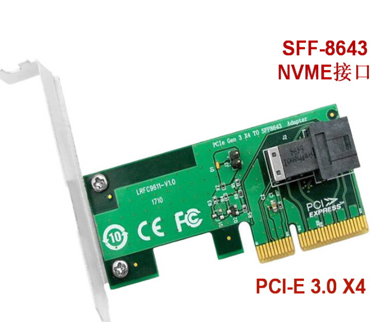

This is the product:
https://www.amazon.com/Mini-SFF-8643-NVMe-PCIe-Adapter/dp/B07BBVBDVD

I can't see why the adapter needs third party drivers, or how it could benefit from same. AFAICT, the entire circuit is just an electronic extension cable. Its function is completely transparent to the OS.
Edit:
ICBW, but maybe that square IC is some kind of controller.

Communication is not going to be as strait forward as I hoped, as the request is to use Skype, which I honestly have never used until now. Plus the known language barrier, where I have been confused by previous email replies.
So lets look at the adapter boards. The PCIe board appears to be for SAS. Then the external board converts the SAS to NVMe. The external board appears to get power from a standard SATA connector. I think the required driver would be for the PCIe SAS board. I don’t have time to research this further myself at this moment. Maybe this weekend if I have time. But I think the concept is good. I think I did a little research when first presented with it, but that was months ago and I don’t remember.

When you receive the PCB, tell us the part markings on the ICs. Then we'll know exactly what it does. High resolution photos would help, too.
BTW, I don't believe that there is any protocol conversion going on. That would require some serious electronics.

I spent a few minutes doing a bit of quick research, and I think I was confused as when looking up SFF-8643 as it was referenced as mini-SAS/SATA. I think this actually allows 4 lanes of PCIe across a cable to the external board. That would explain the lack of electronics. And I also think the power for the external board is from a 4 pin molex connector, although I have not yet found any pics of that side of the board. But the concept appears to be an external hot-pluggable NVMe setup.
I won’t be getting any boards until I have time to do more substantial research. I was kind of hoping that someone else would look at it and try to figure it out... :roll:

That board is intriguing because it has that square IC which could potentially be some kind of controller. Those two redriver ICs can either be programmed via external resistors or via their I2C bus. At least that's how TI's redrivers work. The actual redriver ICs on this PCB are different, but I would expect that they would function similarly.
So I'm wondering whether that "controller IC" could be remotely controlled to switch the redriver muxes on and off. That would be akin to a PHY reset.

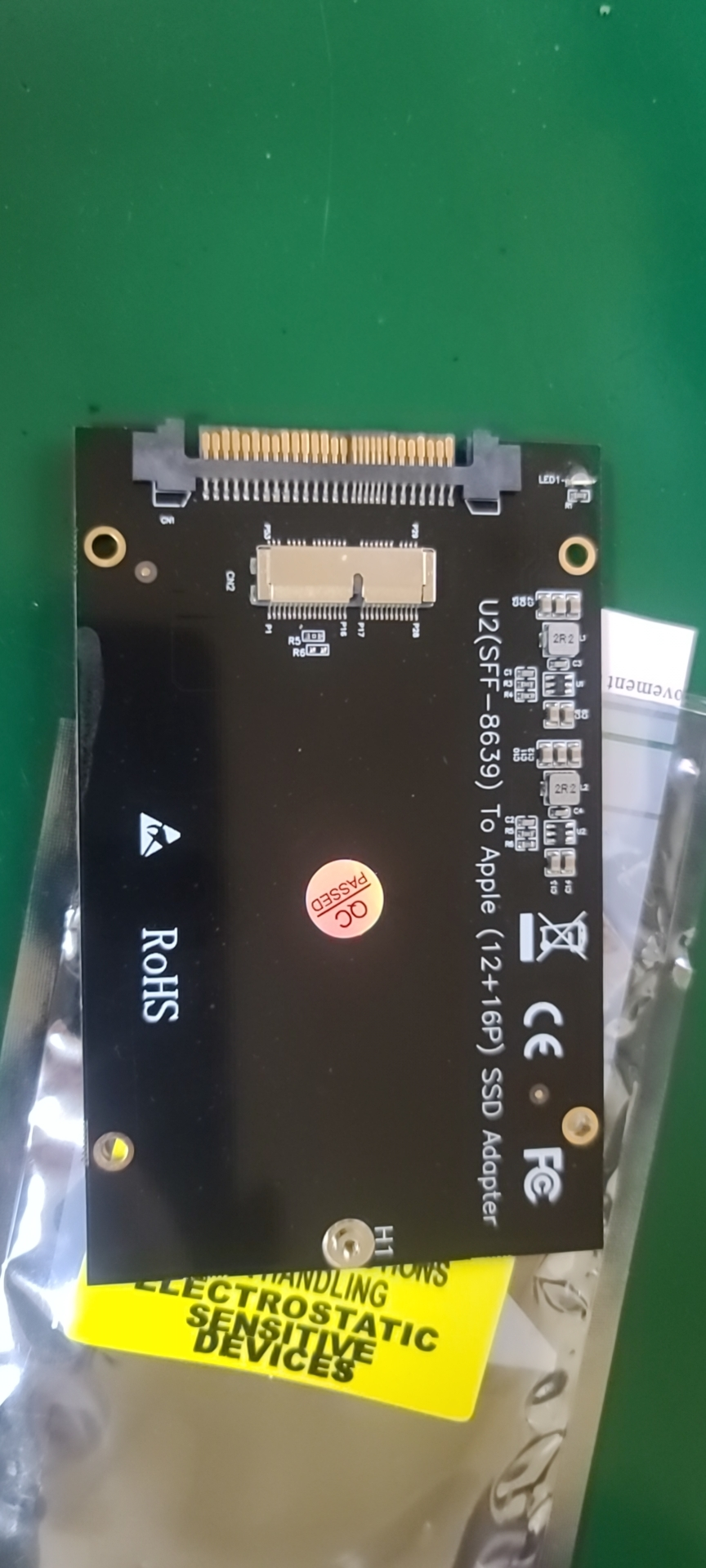

I had a conversation yesterday, and the language barrier was not that bad. I will attach another picture that was sent. I did find out that this setup does work with Windows, but not with my software, and the driver was referenced. I think it was meant that Linux needs a driver installed, if possible, although the conversation ended with me asking those questions with no further reply.
Here is an interesting link I found when doing some searching. I think it is very much related to the whole idea.

If this other person has the card, ask them for the chip markings.
